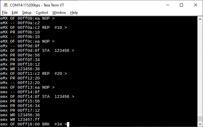

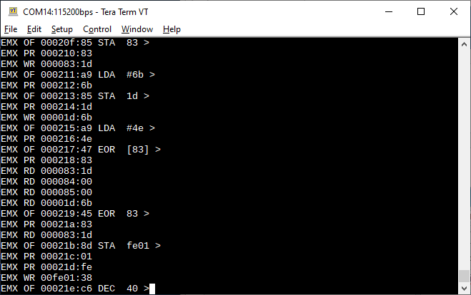

I too am skeptical. Try as I might, I see nothing in the test code that would conclusively prove the device under test is a genuine '816.
I don't know of any other 65xx chip which outputs VPB, VDA and VPA signals, and without these it would not be possible to decode the cycle type info. The CPU type determination routine executes opcode 47 as EOR [x]. I tried the mode switching code and it works.
The screens below show EOR [83] and mode switching (see EMX letters changing case) with 24-bit addresses and 16-bit data. Hope this will convince you. :)
Another interesting point: the X mode output changes during the fetch of the next instruction after REP, so even if the CPU is already switched to 24-bit addressing, it doesn't say so. M output changes during the last cycle of REP - correctly. NOPs following mode switch seem to be a good idea regardless of timing issues.
And no, I will definitely NOT design any medical equipment using any 65xx. :)

 Post subject: Re: R65C02P4 fake chips
PostPosted: Fri Jan 31, 2020 1:44 pm
Posts: 1005
One could simply put a scope on pin-3. If it's any kind of 6502 you'd see a clock signal there. If it's a 65816 you won't.
The firmware code in my POC V1.1 unit is peppered with REPs and SEPs that are immediately followed by regular instructions, not NOPs. I've never had any issues with mode switches, even at 15 MHz. Whatever timing errata my have existed in the past with REP and SEP seems to have been eliminated.

Okay, question for my own purposes: is there a difference in the behaviour of the MX signal between the old 65816 and the current one? Running the same code sequence on a genuine current '816 and carefully sampling the signal should answer that question. It's a test I can incorporate into the 6502 Fake Finder, if there is indeed a detectable difference.
gbm, I'm a little uncertain, and other may be, too. You seem to imply that the screen shots you posted reveal info based on signals from a real, physical '816... but you didn't actually say so (and the line up top about "Software-Defined Computer" confuses the matter by sounding like a simulation instead). Can you be explicit please regarding all the details of what's in the scree shots? Thanks.
