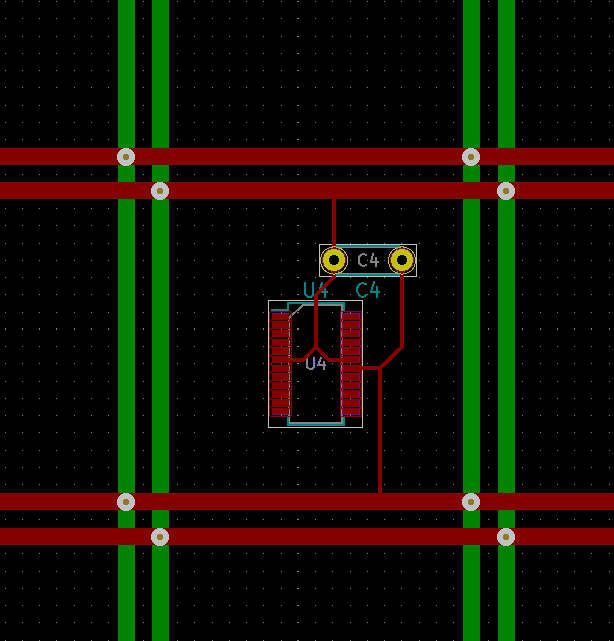

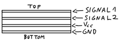

and so, just to recap.
* for high quality hobbiest boards with very low noise/EMI: 4 layers with seperate ground/Vcc planes.
something along the lines of this i assume:

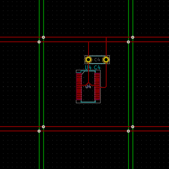

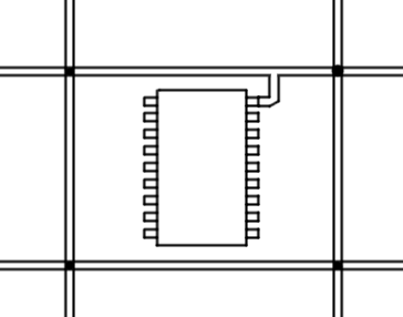

* for cheaper quality boards: 2 layers with a Grid of Ground traces.
something like this? :
note that the vertical and horizonal lines are not on the same side, but connected via vias.

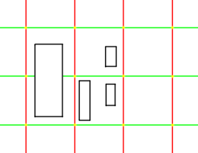

what confuses me about this is what is the size of the grid supposed to be? i assume a square shape is always the best and it should be atleast the width of the largest IC + a bit extra space.
like this maybe? :
and what about Vcc?
couldn't you make a grid like this to have GND and Vcc always next to eachother? or would that somehow make noise/EMI worse? because this is almost a breadboard at this point.
* alternative cheap option with 2 layers (i saw it online a lot)
Have 1 layer be a ground plane, and do everything else on the other layer, if vias have to be used the trace on the GND side should be as short as possible.
* standard Hobbiest starter option:
Just let Free/AutoRouting do it, make sure there are no ground loops or similar.
it works for small projects
this is basically what i got from this.
as people said before i can go for the more advanced things to make sure it works, but it likely will also work without them unless i really test my luck with large/fast/complex boards
I could go for the grid one, (only GND or with Vcc in the grid like i showed?), but it would require me to completely redo the layout as i need to manually place the grid and make sure it fits all components. then FreeRouting could do all the signal lines.
PostPosted: Wed Jan 29, 2020 4:30 pm
Usually with a 4-layer board, the ground and power planes are put on the inner, hidden layers, with signals on the outer layers. If nothing else this helps to reduce crosstalk between signals.
Your grid layout looks reasonable, though I would use thicker traces (say 50mil) for power and ground than for signals. There's nothing to prevent you leading a power trace up the middle of a DIP IC, or spacing the traces unevenly; the important factor is the distance between any given signal trace and its return paths (Vcc when pulling up, GND when pulling down).
You'll quickly find, even with a 4-layer board, that using one side of the board for vertical traces and the other for horizontal ones makes layout much easier. Installing a power grid effectively enforces that. Power and ground planes give you more freedom to deviate when appropriate.
PostPosted: Wed Jan 29, 2020 5:49 pm
Posts: 746
so for the grid it should be thicker but the actual connections you do to the components are thinner. kinda reminds me of the AC power grid connection houses and stuff. probably because it's roughly the same idea.
also what about the idea of having both GND and Vcc in the Grid? like i showed in the picture? is it a good idea or somehow bad?
fixed version
