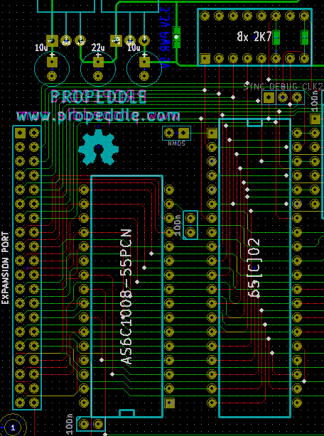

Be sure to always do a thorough visual inspection after the autorouter gets done with it, and do some corrections by hand. (Autorouters can't compete with the intelligence of a human anyway, which is why I never use one.) Right next to pin 40 of U4, there are two blue traces crossing (shorting). Just left of U2 pin 21, a red trace appears to be too close. A red trace going to U3-39 makes an unnecessary U-turn with two unnecessary vias. Similarly to pin 29, there are two unnecessary vias. Since these just jumped out, I'm sure I'd find many more if I spent some time with it.

I agree with Garth, the auto-router made a mess. Did you notice that the GND trace does a lot of silly things: it jumps layers to carefully avoid C2, then goes all the way "around the world" to come back to it. You should route this board manually, it's not that hard and kinda fun if you have a little bit of OCD like most hardware and software engineers
Also, unless you already have plans for an enclosure that fits your PCB exactly, you should consider moving J3 and the pull-up resistors down, so that you can cut about 3/4 inches off the top of your board (making your board significantly cheaper). You may be able to move the other connectors down too, to make even more space; actually it kinda looks like J1 and J2 might cause less routing trouble if they would be on the right side of the board but I understand and agree with the esthetics of putting all connectors on one side.
I would also do away with the double socket for the WDC65C02 vs regular 6502. The only relevant differences between 6502 and W65C02 (at least for PCB design) are that pin 1 needs to be grounded for 6502 and disconnected for W65C02, and pin 36 on a 6502 is not connected but needs to be pulled to VCC on W65C02 (I think Garth's pages recommend a pull-up resistor instead of a connection straight to VCC). Just design the board as if it only has a 6502, but add a jumper between pin 1 and GND (on=6502, off=WDC), and add a pull-up resistor between VCC and pin 36 (no jumper needed, it won't harm a 6502 if that pin is pulled high). It will save board space, and a 40-pin socket is cheaper and less work to solder than four single-row headers.
Finally: don't take any of this personal; we're just trying to help! Keep up the good work!

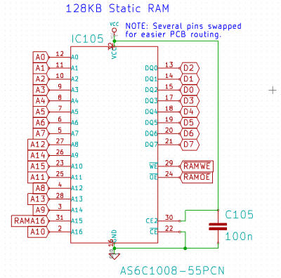

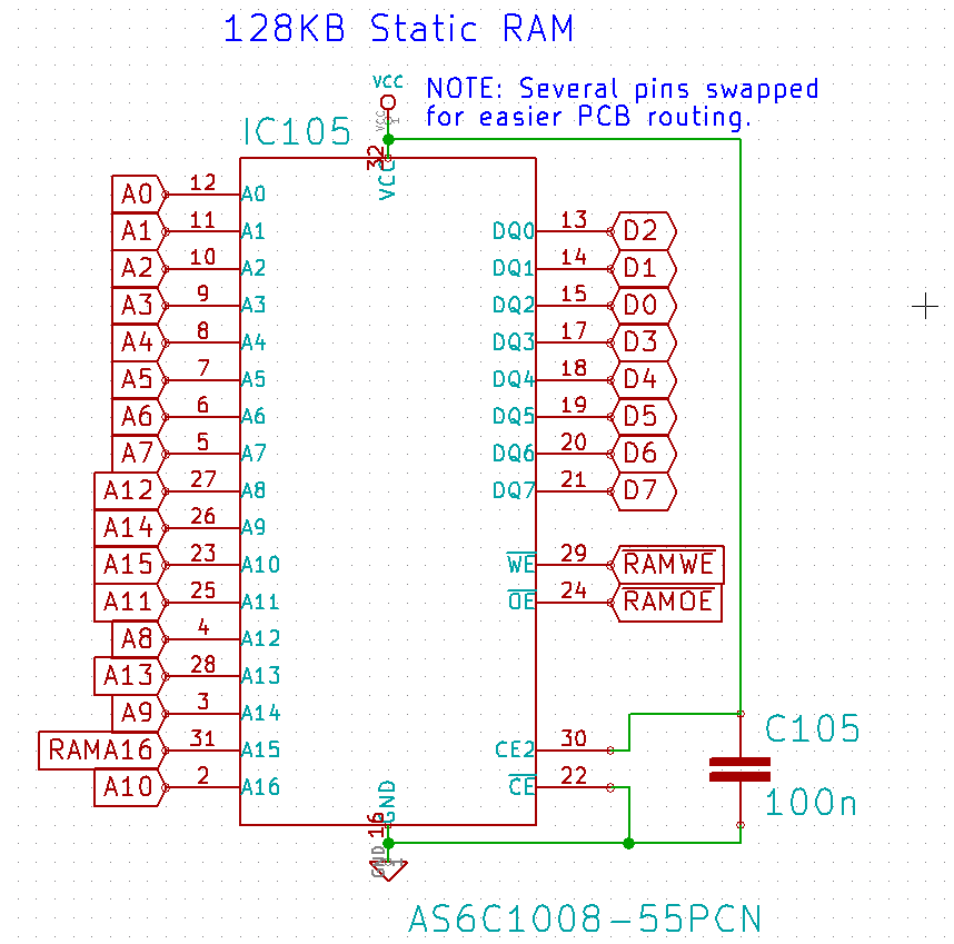

EDIT/PS: If you turn the SRAM chip 180 degrees, it may be easier to route, too. On the 6502, the address bus pins are all around the "tail" of the chip, but on the SRAM chip, the address bus pins are near the "head" and the data bus pins are near the "tail".
Also, keep in mind that it's okay to swap address bus pins or data bus pins on the SRAM chip, to make routing easier! See attached.

I have to agree with Garth and Jac: the autorouter didn't cut it with this design. I manually route everything. As Garth said, the average designer has far more intelligence than the smartest piece of software ever invented. I've never seen an autorouted board that didn't need a fair amount of cleanup after the fact.

I feel a need for a counterpoint.
Although I agree that hand-routing can be fun, and that autorouters almost always make some unusual decisions, I would expect the autorouter never to create a short or a design rule violation without telling you about it. I know from experience that hand-routing can be a bottleneck and just getting the design off for manufacture can unstick a hobby project.
As far as I can see:
- the "short" near pin 40 is not wrong. Pins 36 and 40 have been tied together.
- the "too close" route near pin 21 is clearly avoidable, but I would presume is design rule legal. It would be worth fixing, or using coarser design rules, for a revision. But it needn't mean that the board won't work.
- pin 5 on the 65C02 looks very clearly unconnected, as it should be.
In conclusion: the board could be neater, but it's not wrong for those points. It's not wrong to autoroute for a hobby project.
(For other comments about how to improve the board - all fine and valid optimisations. But don't let the perfect be the enemy of the good.)
(For other comments about how to improve the circuit design, I haven't addressed them. An actual mistake in the circuit would of course be worth addressing for a revision. Meanwhile, cutting and splicing the first set of boards might be necessary. Many an industrial product has patch wires.)

I'm sure a good autorouter has its place, when time is of the essence and you can afford the board space for it to operate, and you don't have critical criteria that it would have no way of understanding. Doing a good job manually definitely takes time.
However in my last place of work where we used OrCAD, we still had to do a careful hand check even after an autorouter job, because its autorouter definitely gave us wrong connections, even though the netlist came from the schematic capture which had the schematic correct. Clearly the board did not match the schematic. There were also times that one pin of an IC should go to its immediate neighbor and there was a straight shot with nothing in the way; yet the autorouter would take off in exactly the wrong direction, wander around, and then finally generate a message that you can't get there from here.
What might be best in many situations is to go ahead and use the autorouter but always do a careful job of manual checking and clean-up afterwards.

Only do that clean up if you need to. Almost all the time, you don't need to.
It doesn't help people to get their projects done and to enjoy their hobby if every progress report is followed by several mainly-aesthetic criticisms. I've posted in a new thread "forum decorum" some thoughts about good and bad ways to approach posting.

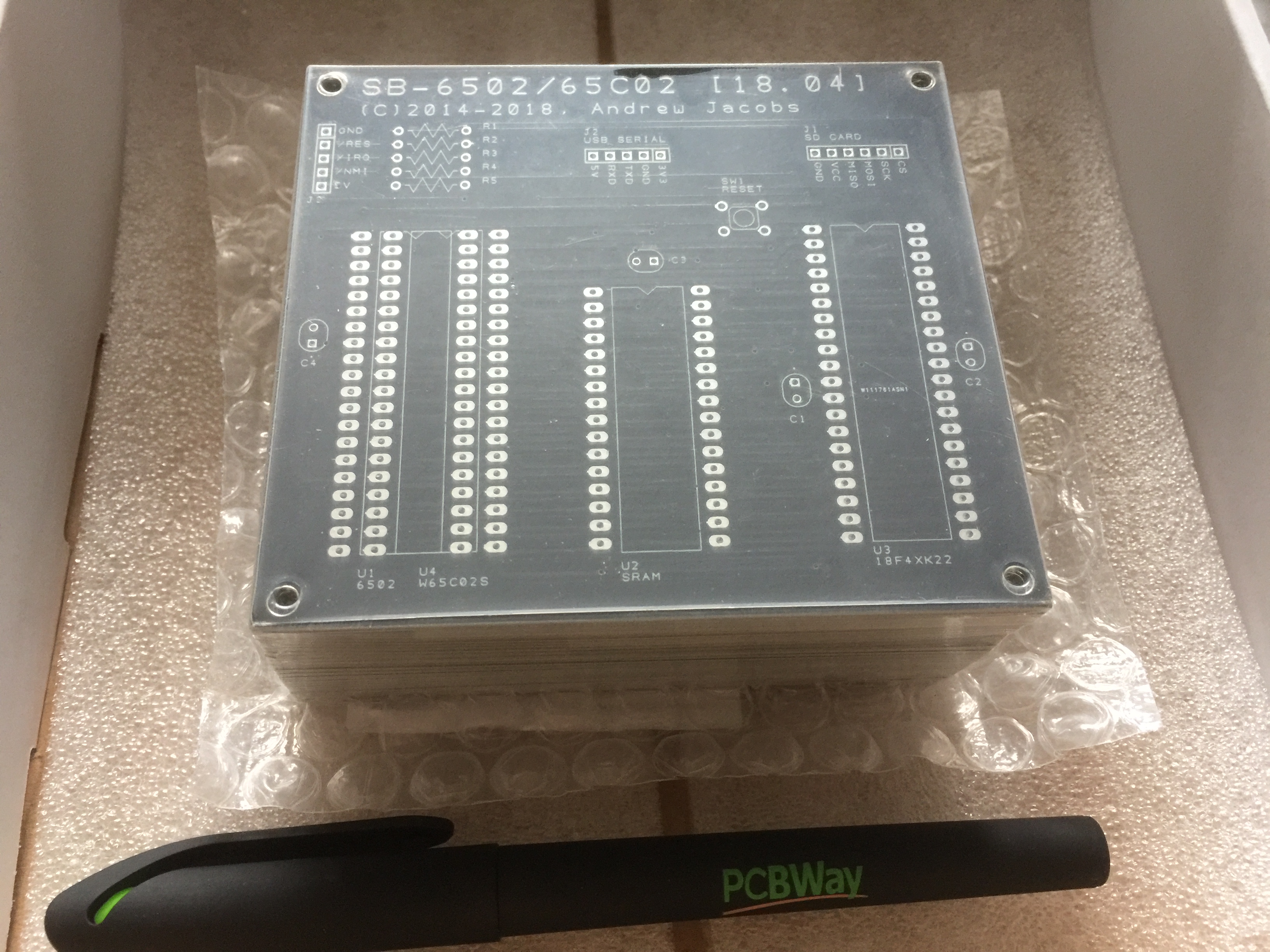

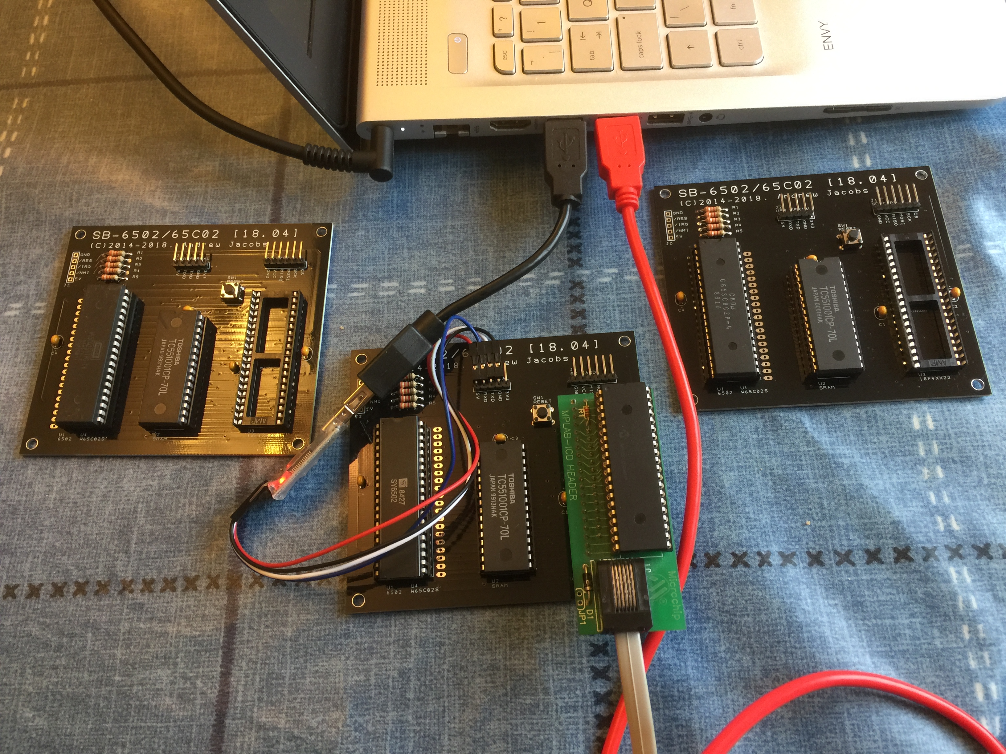

I’ve made a new version of my board (with a pull up on /SO) and slightly reduced in size to be inside the 100x100mm prototyping limit imposed by some board houses. I now have a trinity of devices to work with (6502, 65c02 and 65802).
I also made some spare boards this time.
Now I really need to finish the firmware.
