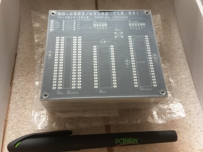

I’ve made a new version of my board (with a pull up on /SO) and slightly reduced in size to be inside the 100x100mm prototyping limit imposed by some board houses. I now have a trinity of devices to work with (6502, 65c02 and 65802).
File comment: The Trinity of 65 devices
I also made some spare boards this time.
Now I really need to finish the firmware.
