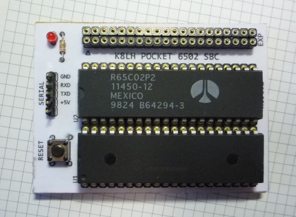

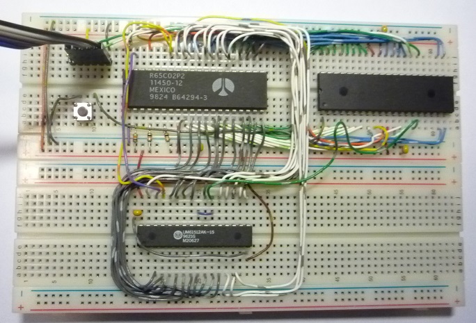

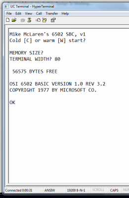

Nothing really new or particularly clever on my part (it's pretty much all been done before), but it's my first ever SBC design so I'm pretty geeked.
This is basically a ROM-less SBC with an R65C02 CPU running at 1-MHz, a 64K RAM chip, and a PIC microcontroller "helper". The PIC provides the 6502 reset and 1-MHz clock signals and it loads RAM during power-up or after a reset with a pseudo ROM image from flash memory. The PIC also eliminates the need for a GAL or other discrete logic ICs for address decoding by implementing a soft decoder with single page resolution for up to six chip select pins. The soft decoder also maps the PIC UART to a single page in 6502 address space and the UART presents to the 6502 as a simple 6850 ACIA.
To test the SBC I modified the soft decoder 256 byte "decoder map" to fill the 64K address space with RAM, except for the $DF page where I mapped the UART (pseudo ACIA). I also uploaded Grant Searle's ROM image of OSI BASIC + Monitor into PIC flash memory and this image is copied into RAM at $E000-$FFFF during start-up. Everything works great!
I'm in the process of moving the design from a solderless breadboard to a 2.0" x 2.75" prototype board and there's lots of work left to implement a "supervisor" mode on the PIC to allow uploading decoder map and ROM image files via the serial port into flash memory.
This SBC design is the result of help and inspiration from many sources across the internet and here at 6502.org.

Well, I'm not really trying to emulate an OSI. I'm just taking advantage of Grant's work extracting that particular flavor of BASIC from the pagetable site and the work he's done to put it into a single file that can be modified and assembled easily using CA65.
Yeah, it's surprisingly simple if you get rid of the video/keyboard. Relatively easy to duplicate even with this 3-chip design. I plan to upload an Apple-1 decoder map file and the Apple-1 Woz' Monitor + BASIC files into flash memory via the PIC "supervisor" mode for testing in the next day or two. Then I'd very much like to add video/keyboard support, a "slot", and turn it into a modestly priced product.
Video, keyboard, SD card, and more are definitely on the horizon. I'd love to try a Propeller. Do they sample? Anyway, a PIC 32MX in a DIP-28 package with 32K RAM and a couple DMA channels looks like a good candidate for Video/Keyboard/SD Card at this time.

I snatched up the 64K chip because it was 15 nanoseconds and because it would fit within the open frame of a 40-pin machined pin socket.
Oh and I forgot to mention, I like your breadboard version too! My first breadboard version (which was "Frankensteined" with a Briel Computers Pocketerm) didn't look nearly as nice

I'm not sure how many layers I would need for that little 2" x 2.75" board. I haven't tried routing it. Please keep in mind that I can mix up the address lines and the data lines on the RAM for best routing. That is, A1 on the RAM does not have to go to A1 on the CPU.
That breadboard doesn't look bad at all...

Re: My 3-Chip Design Is Working...
Project Status Update
I'm still wiring up the 2.0" x 2.75" prototype board and there's lots of work to do on the PIC microcontroller firmware for the PIC "supervisor" mode which basically provides a way to upload a 256 byte "decoder map" file and ROM image files via serial port to flash memory in the PIC. I suspect that Daryl's method of auto-booting his AVR 6502 Emulator into 6502 mode with a time-out to invoke the supervisor may be the cleanest and most intuitive method.
Once the project is a little more complete and polished I'll post it in the SBC forum along with documentation and firmware. I'm also thinking about making a couple different PCBs available, if anyone is interested.

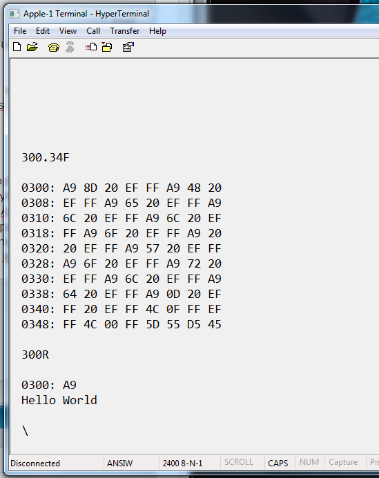

A three chip Apple-1?
Well, almost. Any respectable Apple-1 replica would need another chip to interface a keyboard and produce composite video, as well as a 44-pin "slot" for expansion, but I felt compelled to try out a Serial Apple-1.
I modified PIC code to present the UART as the 6821 PIA used in the Apple-1. Then I modified the decoder map to assign chip select pins for the Apple-1 $Axxx, $Bxxx, and $Cxxx expansion I/O address space. The UART (pseudo 6821) is mapped to the $D0xx page and RAM fills the remaining space at $0000-$9FFF and $D100-$FFFF. An image of the Apple-1 Woz Monitor was installed in flash and is loaded into RAM at $FF00-$FFFF during start-up.
While it may not look like much (the Woz' monitor only has about three functions), anyone who knows anything about Apple-1 history will understand why I got goosebumps (and a big smile) when I started using the Woz Monitor.

Awesome stuff again. Yes, big smile here too
With a setup like you have, producing many different emulators with the same hardware is obviously pretty easy.
