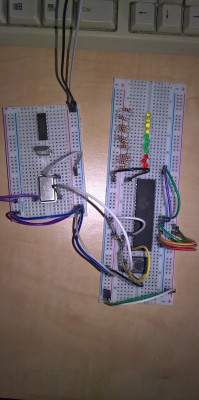

I am experimenting a bit with direct crystal connection, but it does not work, could you please check my connection?
What is it doing, and what are you expecting it to do? "Doesn't work" can be anything from "it genuinely doesn't work" to "my expectations of what it should do were wrong".
Is that resistor connected to pin 40? It's hard to see where it goes. What value is it?
You haven't connected the data bus. With that floating, there's no telling what it'll try to do. Wire it to $EA for the classic NOP test.
Your LEDs are on the bottom two address lines. With a 2MHz clock, even with everything working you won't see anything. They'll both be on at 50% brightness. If you connect them to the top two address lines (pins 24 and 25), they'll be flashing at 15Hz and 30Hz - you might see a flicker on A15. That looks like a counter on the clock board. Divide it down by as much as you can. For the first steps, it's easiest to see what's going on if the clock is at a frequency that you can see an LED blinking.
If you have the tools to measure voltages, double-check that the power supply is providing 5V, and it's going to the right pins (and you've got it the right way around - 6502s don't like being fed -5V). If you have a logic probe or oscilloscope, check that there actually is a clock signal.
Put a capacitor across the power supply near the 6502. It might work without one, but breadboards and long wires make me nervous. 0.1uF is the traditional value. It wouldn't hurt to put something larger on it too.
And one last thing - is your larger breadboard one of the ones that split the power rails half way along? The wire you've got connected to pin 21 might not go anywhere.
You might also want to tie pin 38 high too.
