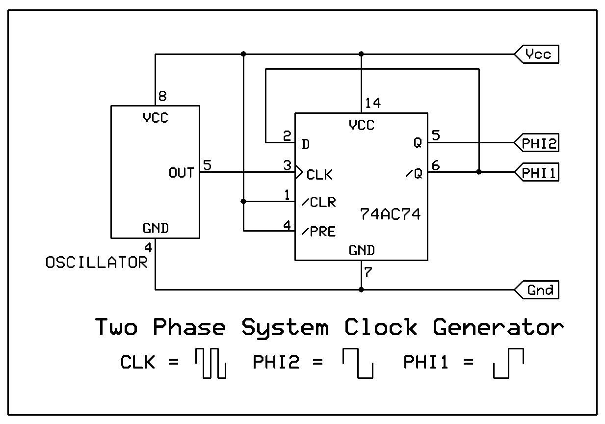

Can oscillators will work as the Ø2 clock source for any 65C02, as long as the oscillator's output swings between 0 and at least 75 percent of Vcc. An HCMOS oscillator should be able to satisfy this requirement. There are some oscillators that have TTL outputs (VOH ~ 2.4), which will not work with a CMOS MPU running on the usual 5 volts.
I recommend the exclusive use of a can oscillator instead of a crystal and supporting components. In a can oscillator, the manufacturer has solved accuracy and stability problems for you, and will guarantee operation within the limits described in the data sheet. A roll-your-own circuit using a crystal might function okay at room temperature and at nominal voltage, yet drift off frequency or fail to oscillate when conditions change.
Most can oscillators are rated to have a 50-50 output duty cycle. However, there are tolerances and, for example, the oscillators I use can range from 45-55 to 55-45. At the low speeds you apparently are contemplating clock symmetry is generally not an issue and may be safely ignored. If you ever decide to build a contraption powered by the WDC version of the 65C02 (or 65C816) and wish to run it much faster—the WDC units have an official maximum Ø2 rate of 14 MHz, an asymmetric clock might give you some grief. In that case, a flip-flop may be used to "clean the clock" and assure a 50-50 duty cycle (below illustration).
Last but not least, it is not recommended to use the PHI1O and PHI2O clock outputs (pins 3 and 39, respectively, on the MPU). All timing should be referenced to your Ø2 clock source, which is pin 37 (Ø2-in). In WDC MPUs, the lag between Ø2-in and the Ø1 and Ø2 outputs is neither tested or even specified in the data sheet. In other words, a predictable amount of skew is not guaranteed, which may have implications if 65xx peripheral devices, such as the 65C22, are used.
Clock Generator w/Flip-Flop

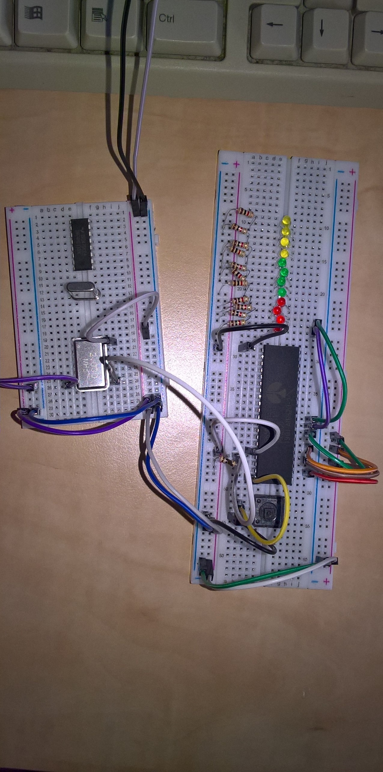

I am experimenting a bit with direct crystal connection, but it does not work, could you please check my connection?

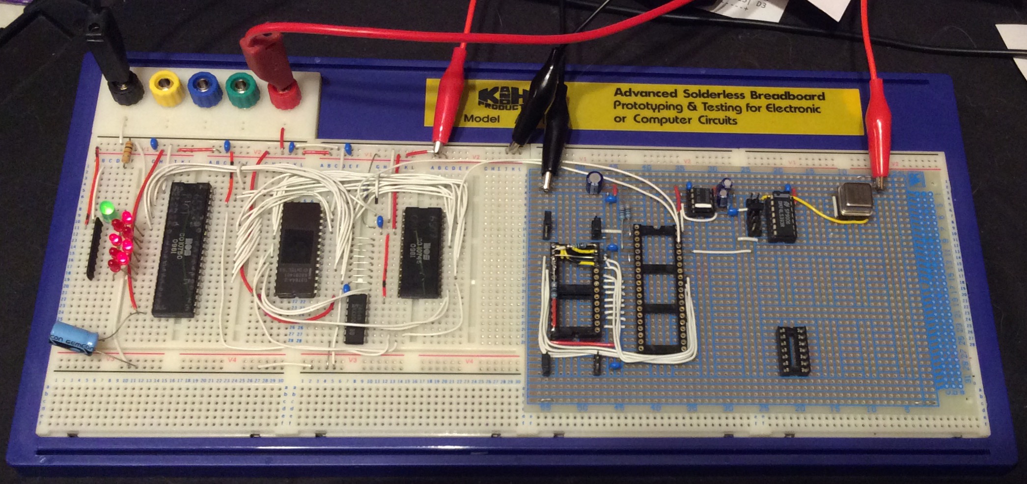

click link for photo
The 74LS393 is near the silver can of the crystal module.
I used a 74LS393 because this circuit is not intended to operate at particularly high clock speeds. It having been built for experiments with NMOS and the older 2Mhz, 3MHz CMOS 6502 / 65C02 chips.
Mark
PS If I can find a higher resolution copy of this photo, I’ll post it up later.

Yes, something like this.
Unfortunately I don't have a bigger picture, and I don't have that hardware anymore.
The CPU was a Rockwell R65C02P2 (2MHz), but overclocking it to 4MHz had worked.
What is it doing, and what are you expecting it to do? "Doesn't work" can be anything from "it genuinely doesn't work" to "my expectations of what it should do were wrong".
Is that resistor connected to pin 40? It's hard to see where it goes. What value is it?
You haven't connected the data bus. With that floating, there's no telling what it'll try to do. Wire it to $EA for the classic NOP test.
Your LEDs are on the bottom two address lines. With a 2MHz clock, even with everything working you won't see anything. They'll both be on at 50% brightness. If you connect them to the top two address lines (pins 24 and 25), they'll be flashing at 15Hz and 30Hz - you might see a flicker on A15. That looks like a counter on the clock board. Divide it down by as much as you can. For the first steps, it's easiest to see what's going on if the clock is at a frequency that you can see an LED blinking.
If you have the tools to measure voltages, double-check that the power supply is providing 5V, and it's going to the right pins (and you've got it the right way around - 6502s don't like being fed -5V). If you have a logic probe or oscilloscope, check that there actually is a clock signal.
Put a capacitor across the power supply near the 6502. It might work without one, but breadboards and long wires make me nervous. 0.1uF is the traditional value. It wouldn't hurt to put something larger on it too.
And one last thing - is your larger breadboard one of the ones that split the power rails half way along? The wire you've got connected to pin 21 might not go anywhere.
You might also want to tie pin 38 high too.
