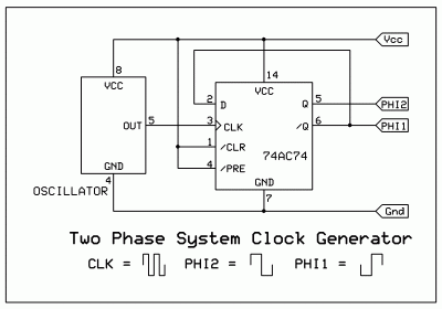

Can oscillators will work as the Ø2 clock source for any 65C02, as long as the oscillator's output swings between 0 and at least 75 percent of Vcc. An HCMOS oscillator should be able to satisfy this requirement. There are some oscillators that have TTL outputs (VOH ~ 2.4), which will not work with a CMOS MPU running on the usual 5 volts.
I recommend the exclusive use of a can oscillator instead of a crystal and supporting components. In a can oscillator, the manufacturer has solved accuracy and stability problems for you, and will guarantee operation within the limits described in the data sheet. A roll-your-own circuit using a crystal might function okay at room temperature and at nominal voltage, yet drift off frequency or fail to oscillate when conditions change.
Most can oscillators are rated to have a 50-50 output duty cycle. However, there are tolerances and, for example, the oscillators I use can range from 45-55 to 55-45. At the low speeds you apparently are contemplating clock symmetry is generally not an issue and may be safely ignored. If you ever decide to build a contraption powered by the WDC version of the 65C02 (or 65C816) and wish to run it much faster—the WDC units have an official maximum Ø2 rate of 14 MHz, an asymmetric clock might give you some grief. In that case, a flip-flop may be used to "clean the clock" and assure a 50-50 duty cycle (below illustration).
Last but not least, it is not recommended to use the PHI1O and PHI2O clock outputs (pins 3 and 39, respectively, on the MPU). All timing should be referenced to your Ø2 clock source, which is pin 37 (Ø2-in). In WDC MPUs, the lag between Ø2-in and the Ø1 and Ø2 outputs is neither tested or even specified in the data sheet. In other words, a predictable amount of skew is not guaranteed, which may have implications if 65xx peripheral devices, such as the 65C22, are used.

At a maximum of 22ns, the 74HCT393's output transition time (tTLH, tTHL) will likely cause problems with WDC 65xx products. Case in point, the WDC 65C02 has a maximum permissible clock input transition time of 5ns, which is independent of operating voltage or Ø2 rate (see the tF and tR specs on page 25 of the data sheet). Also, consider that at a Ø2 rate of 14 MHz, that 22ns is nearly 63 percent of the total Ø2 half-cycle time. It would be unreasonable to expect the 'C02 to reliably function with such a large timing discrepancy.
A possible alternative might be a 74AC4040, whose output transition time will meet the tF and tR specs. The only packaging I could find for that device was SOIC-14.
