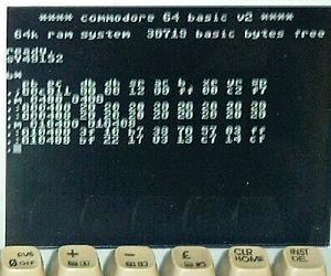

Old picture from 2002:
Note the difference between the contents of $000400 (screen memory) and $010400 (not screen memory).
Most of the K24 circuitry is similar to things we already had in the TTL CPU,
so I think that getting K24 up and running won't be too difficult.
Maybe just some wrong connections in the schematic or a few bugs in the microcode,
fingers crossed.
C64 Kernal + Basic will work with K24, no patches required.
Monitor programs which use RTI for starting user code won't work with K24,
that's because K24 RTI fetches one more Byte from stack: PBR, the program bank register.
Code that makes use of the UFOs (NMOS 6502\6510 instructions unforseen by the designers)
won't work with K24, but UFOs also won't work with the 65C02 and the 65816.
Looking forward to seeing that old K24 concept getting back to life again.
Good luck !
