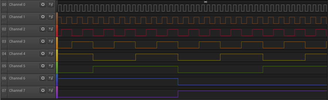

PostPosted: Sat Dec 15, 2018 3:09 am
Joined: Wed Dec 05, 2018 7:52 pm
Posts: 48
Hello guys
Make the data bus for expert 11101010 (EA) which corresponds to the NOP instruction. The image represents the address bar reading from A0 - A7.
Question: Does NOP run clock cycles? In my case, he is using only one. The frequency of the bus is:
CPU CLK = 1 MHz
A0 = 500 KHz.
A1 = 250 KHz
A2 = 125 KHz
A3 = 62.5 KHz
A4 = 31.21 KHz
A5 = 15.61 KHz
A6 = 7.81 KHz
A7 = 3.9 KHz
Is that correct? Thank you.
PostPosted: Sat Dec 15, 2018 3:25 am
Posts: 8546
CPU CLK = 1 MHz
A0 = 500 KHz
Yes, that is correct. NOP is one byte but takes two cycles, which is why you see 500kHz on A0 instead of 1MHz. At 1MHz, a cycle is 1µs, not 2. [Edit: I wrote too hastily. :oops: At 1MHz clock rate, A0 will change 500,000 times per second, not cycle at 500,000 cycles per second.]
PostPosted: Sat Dec 15, 2018 3:29 am
NOP ($EA) should take 2 cycles on any genuine 65xx family CPU. The first cycle reads the NOP opcode with SYNC high, the second cycle is a dummy read of the *next* byte with SYNC low.
Also note that a counter's least significant bit cycles at half the frequency of its trigger clock. It's very common to use counters as frequency dividers for that reason.
So with a 1MHz clock, SYNC should cycle at 500kHz, A0 should cycle at 250kHz, etc. If A0 is cycling at 500kHz, then something is wrong; the CPU is seeing a different opcode than the one ostensibly stored in your ROM.
