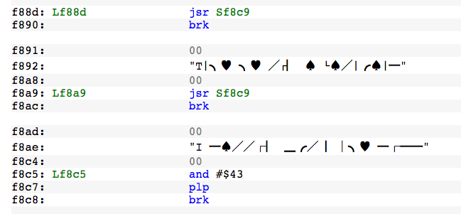

A rather glaring omission so far is the ability to interpret bytes as ASCII text, rather than PETSCII. The latter is only relevant to Commodore machines, the former rather more broadly.
