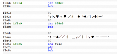

A rather glaring omission so far is the ability to interpret bytes as ASCII text, rather than PETSCII. The latter is only relevant to Commodore machines, the former rather more broadly.

I recently found this when looking for a way to work on disassembling an apple II binary.
Is there a way to export raw text of the disassembly? The dump appears to save an internal binary format.
thanks
White Flame
Posts: 704
Joined: 24 Jul 2012
Re: WFDis - 6502/65C02 interactive disassembler
Post by White Flame »
Not currently. And yes, the current save format is a compressed version of the entire workspace, retaining all the editable state.
Exporting to text is weird given all the display options, address overlaps/overlays, and assemblers out there. So as a stopgap, I ensured that copy/paste is sane, keeping linebreaks and not including the address prefixes.
Selecting all with Ctrl-A, Ctrl-C and pasting into a text editor gives a very usable text dump.

One feature that would be nice is to auto-split text blocks on return into separate strings. (ie, an alternate to the existing, shift-T or something).
For now the petscii is working for me as ascii uppercase text.
