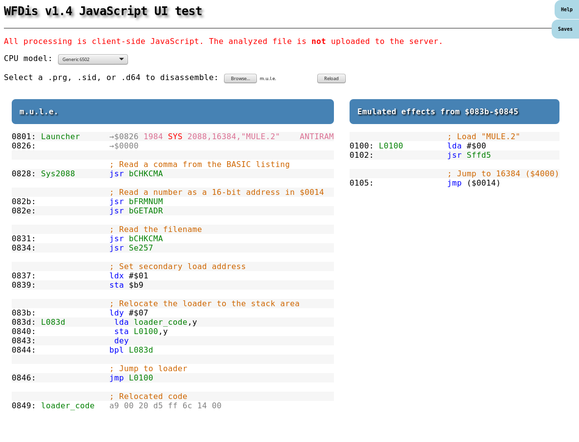

WFDis is an interactive disassembler, with the front-end written in JavaScript, for portability and to give it a nice presentation. There is a much more powerful back-end in development, but the front-end is reasonable enough to use on its own.
It now supports 4 variants of the 6502, including the 65C02. The new 65C02 support is largely untested, as I don't really work with that chip, but I've had requests for supporting it and it should bring more of an audience to trying it out, especially from this board.
Saving/loading the current state of the disassembly to browser localStorage, as well as downloading/resuming from local files is supported. Full export to .asm files is not yet there, but is forthcoming.
It is slanted towards the Commodore 64, allowing viewing graphics for characters & sprites right in the disassembly, BASIC line analysis, and has common ROM labels pre-installed when loading C64-specific file formats. However, general 6502 code should pose no issue, and it can load raw .bin/.rom binary files without any C64 specifics involved.
More docs are available in the "Help" tab in the upper right of the page.
There's still a lot to do in the front-end, but it is usable as is. Any feature requests, bug reports, and generally using it is certainly welcome. Some features won't be a part of the standalone JavaScript version, but take enough analysis oomph to be on the full server version only. This does assume a modern HTML5/ES6 browser, with no concessions for older systems. There's a section in the Help docs listing known issues that will be updated.

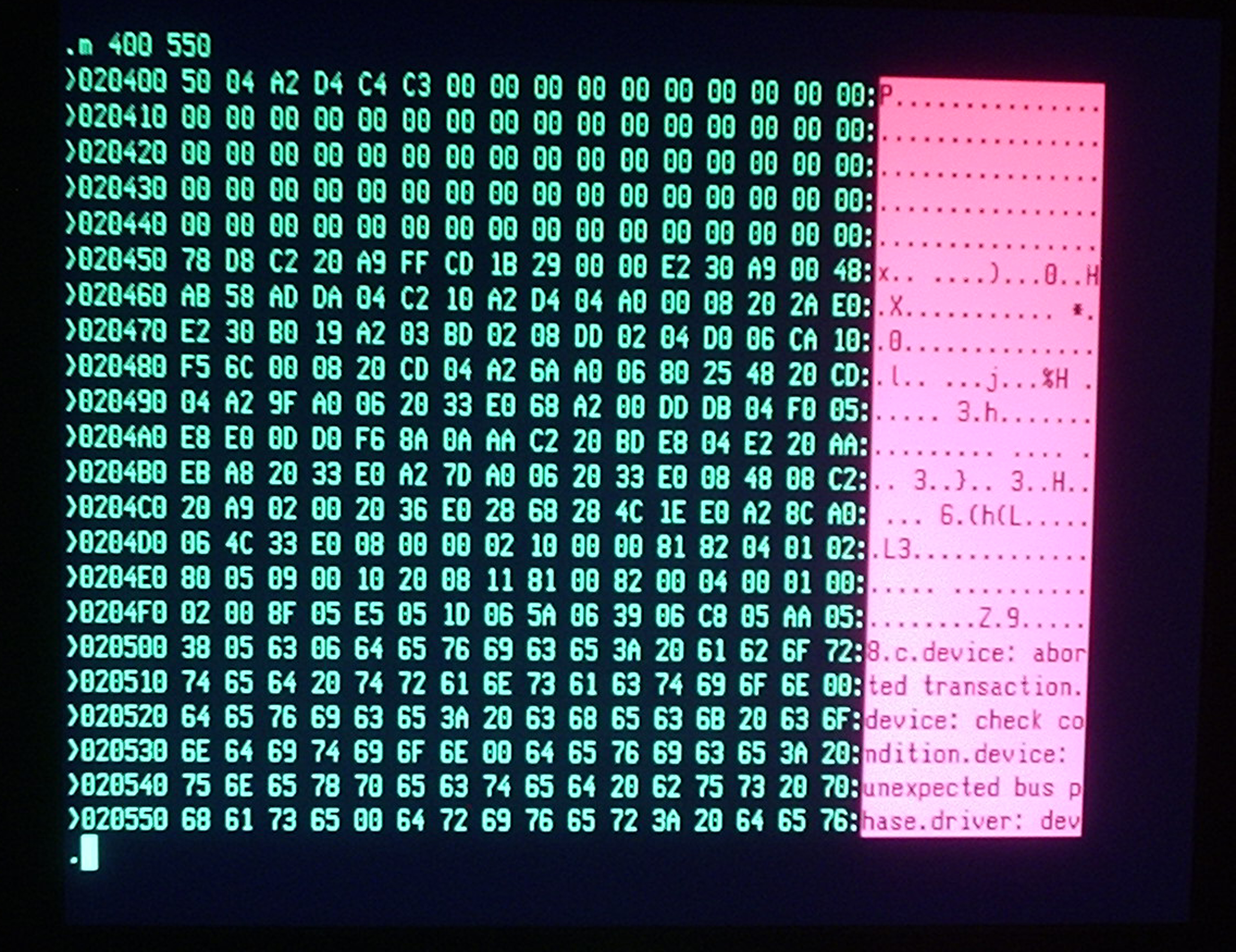

BDD: Would you prefer straight monochrome, or that the colors were simply closer in color/intensity but still distinguished?
BigEd: Multicolor mode swaps the display of graphics data between hires and wide-pixel multicolor; that was working, but is now on the bug list. I've changed some internal representations and event models, and there were a few casualties. When you switch bytes to a char/sprite display, it's only hi-res 1bpp for now.
The help page lists the file formats. If the file extension is .rom or .bin, then it asks you for a load address and loads the entire binary at that address. When loading like this, the only start addresses automatically disassembled are from the top $fffx vectors, if the image reaches there. Commodore-style .prg is the default if there's no recognized filename extension. While I do like the idea of "just does the right thing", I am considering having the user explicitly specify how the file is loaded every time.
To start a disassembly trace otherwise, select the byte at an entry address and hit Shift-a.

Re: WFDis
Thanks! That's working much better, with the file renamed to have an extension, and using shift-A
I notice that 'u' will delete a line - is that a bug?

Yeah.
I thought I had that all fixed... It works to convert asm code back to unknown bytes, but on a row that's already just unknown hex bytes I duplicated that bug.
If you select the range surrounding those lines, and hit 'c' and 'u' to convert to chars and back to unknown, it forces those lines to be refreshed and displays properly again. Shift + cursor keys selects spans of bytes.
EDIT: should be fixed now.

I'd be happy to see a monochrome mode too, possibly using bold or italic to distinguish datatypes. I'm no fan of low-contrast!
How about showing byte values as ASCII (or PETSCII) - perhaps in comments?
41,42,43 ; 'A', 'B', 'C'
or
41,42,43 ; "ABC"
or
41,42,43 ; "ABC"

Regarding the hex dump showing characters, I had been mulling what format to display such characters. As this version is C64 oriented, there's screen codes & PETSCII codes which are different, and then of course ASCII. Many games have their own byte ranges for characters in their custom fonts & tilesets, so it's not necessarily a global setting either, but specific to each range of addresses. I'll certainly have some options for this later, as I agree that's an expected part of hex dumps, but I have some more pondering to do on it.

Edit: fair enough, the display of strings is not completely straightforward! But I imagine you will find a solution. (perhaps a four way toggle? If you add in some directives for the four cases, that could also be a state-rotating button, perhaps: hex, ascii, petscii, screen.)
