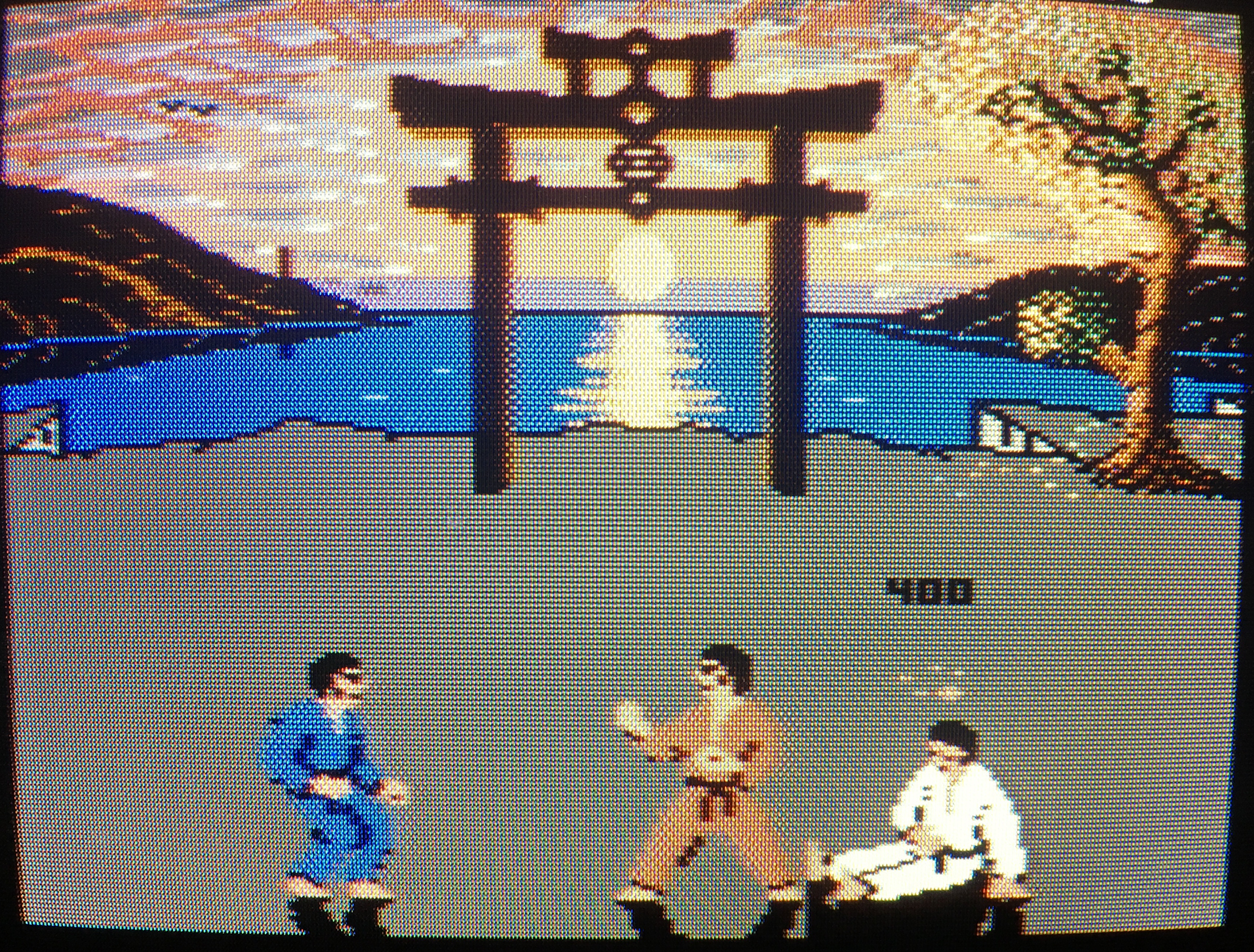

Yup, that was it! After the patch, the game runs! :D
And if you wait long enough ...
The game crashes exactly in the same way as with the 6510 installed ... amazing. (Btw, how cool would it be to fix that bug after all these years. :wink: )

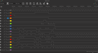

But either way, I’m super happy with the fix. Just for fun, below is a capture showing an NMI hijacking an IRQ already in progress.
Interestingly, RDY happens to go low just before the three write cycles of the BRK routine, and the TTL CPU finishes the writes before pausing, just as the vector low-byte is being fetched (/FCP.AD goes low). The byte that gets fetched eventually is the NMI vector. Very cool!

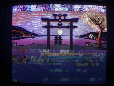

Alrighty then ... the boards are getting harder and harder to patch, with jumpers chris-crossing each other and ICs repurposed here and there. And yet there is more: turns out Impossible Mission also suffered from a “Lost NMI”. :evil:
I didn’t know whether to feel dismayed or grateful at this point. Truth be told, these bugs would have been nearly impossible to find were it not for these two games (IK+ and Impossible Mission). In each, the code hangs within a few seconds of start, and the Analyzer shows the problematic interaction between IRQ, NMI and RDY just before the breakdown very clearly. Nice!
In the end, the solution here was to inhibit sampling of the NMI pin at the beginning of the vector low-byte fetch, and to resume only once the final SYNC cycle of the BRK sequence is finished. In this way, a “Late NMI” is safely deferred until after BRK completes. The NMI will then interrupt the sercond SYNC of the ISR in progress (just as happens with the NMOS 6502).
Here now is the patch:
And with that, Impossible Mission came to life!

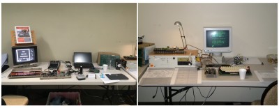

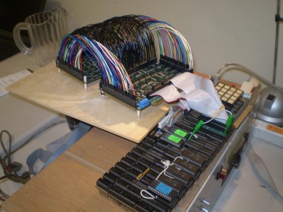

Dr Jefyll and I had an opportunity to show the TTL CPU and Jeff’s TTL-enhanced CPU (a.k.a KimKlone). Both were very well received, with a steady stream of folks coming over to see the CPU guys in the corner of the room. Here are some pics from the day:
File comment: The TTL CPU and KimKlone on display

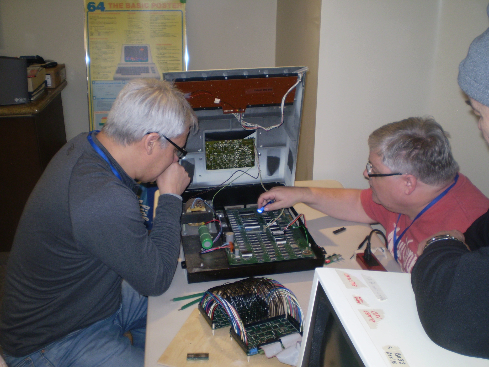

Also in our plans for the day was to carry-out our very own Connect-A-thon! — a.k.a testing the TTL CPU with other machines. Forum and TPUG member Steve Gray generously volunteered his Commodore PET 8032 for the first test (thank you Steve). Although we'd taken precautions, it was hard to feel absolutely certain the CPU's fast AC logic wouldn't generate overshoots that could damage the PET’s circuitry. After some debate, we decided to go ahead with the test despite the risk that we might have overlooked something. Thankfully, all was well and the PET booted with its familiar jingle-beep and no magic smoke. :)
Steve’s PET had suffered a failure in the video hardware earlier in the day, so unfortunately the display remained blank. Despite this shortcoming, everyone agreed it was a successful boot up, and we moved on to test with Jeff’s KimKlone, which, until today, featured a Rockwell 65C02:
KimKlone booted on reset, but crashed a few milliseconds thereafter. Steve and Jeff suspected the power supply, and decided to “borrow” a hefty capacitor from the PET. Scope in hand, Jeff tried to enhance KK’s power supply with some "on the show floor" patching:
Unfortunately, KK refused to run even with the new CAP installed. We tried various captures with the logic analyzer, but soon realized we had been at it for hours and the room was empty ... the serious debugging would have to wait. :)

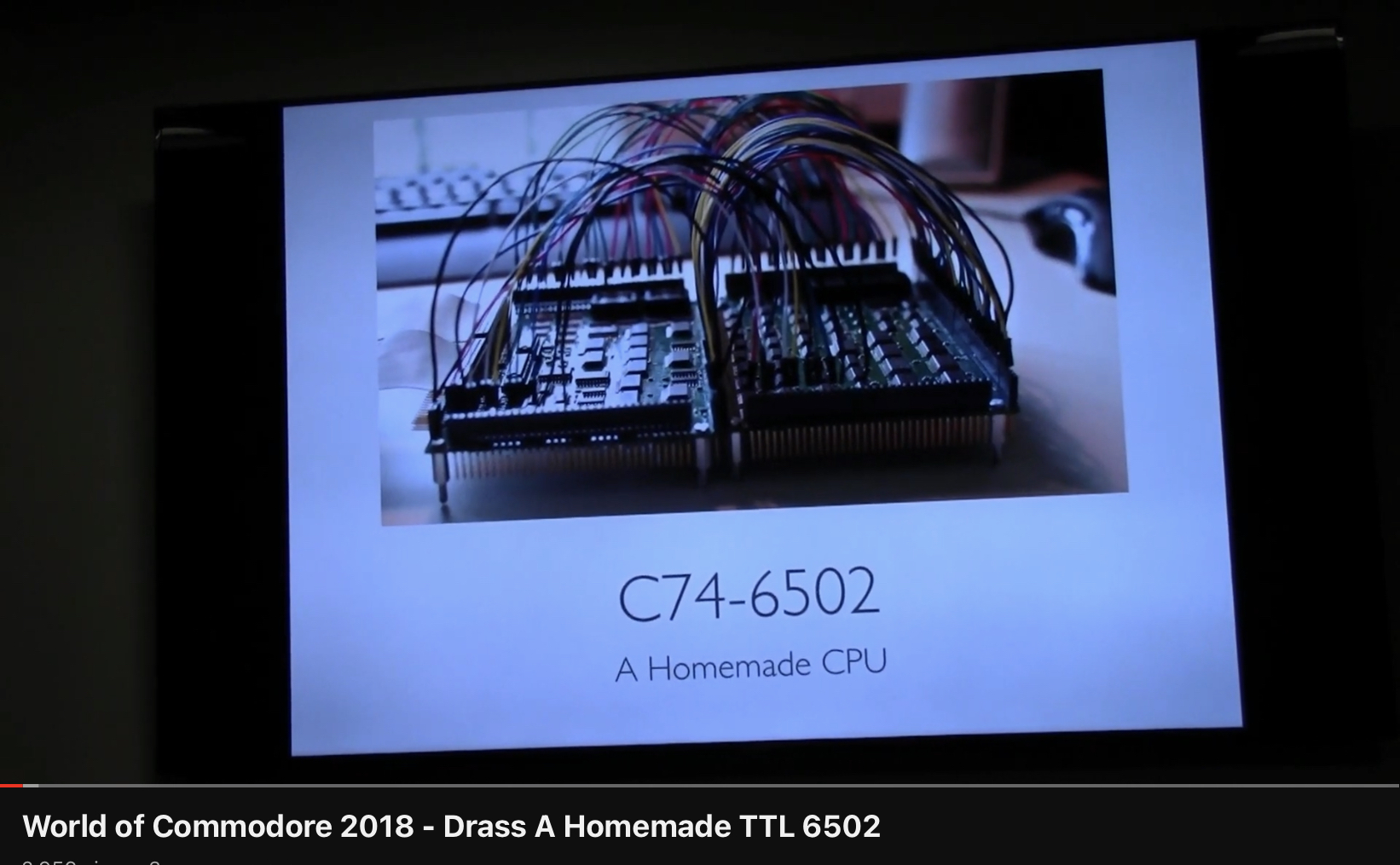

As part of the day, I also had the opportunity to present the C74-6502 in a talk to the group. Here is a YouTube link to the talk: https://youtu.be/dB3P5tt4gnE
