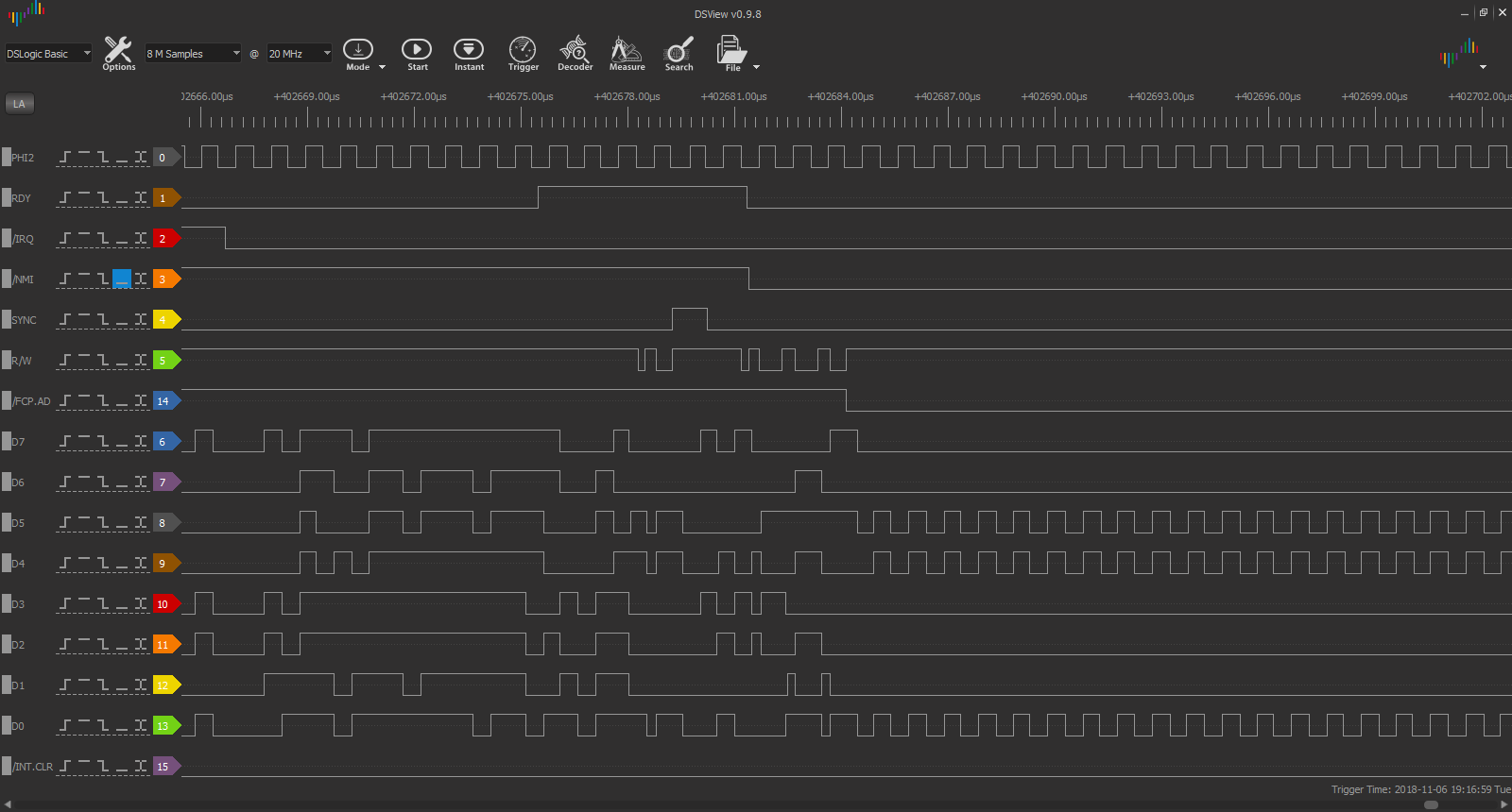

Yup, that was it! After the patch, the game runs! :D
And if you wait long enough ...
The game crashes exactly in the same way as with the 6510 installed ... amazing. (Btw, how cool would it be to fix that bug after all these years. :wink: )
But either way, I’m super happy with the fix. Just for fun, below is a capture showing an NMI hijacking an IRQ already in progress.
Interestingly, RDY happens to go low just before the three write cycles of the BRK routine, and the TTL CPU finishes the writes before pausing, just as the vector low-byte is being fetched (/FCP.AD goes low). The byte that gets fetched eventually is the NMI vector. Very cool!
Ok, now for the bad news: the 15ns “Lost NMI” window remains. The fix for that part didn’t work. Turns out I really do need an extra flip-flop to properly fix the thing, so that will have to wait for the next rev of the boards.
In the meantime, Impossible Mission still hangs, so the hunt continues! :)

Having looked at it more closely, I can now confirm that the “Lost NMI” 15ns window does not exist in the TTL CPU after all. Turns out the window only occurs during phase2 and is always over by the time the NMI pin is sampled on the fall of PHI2. The two events never overlap and NMI transitions are always properly detected regardless of when they arrive.

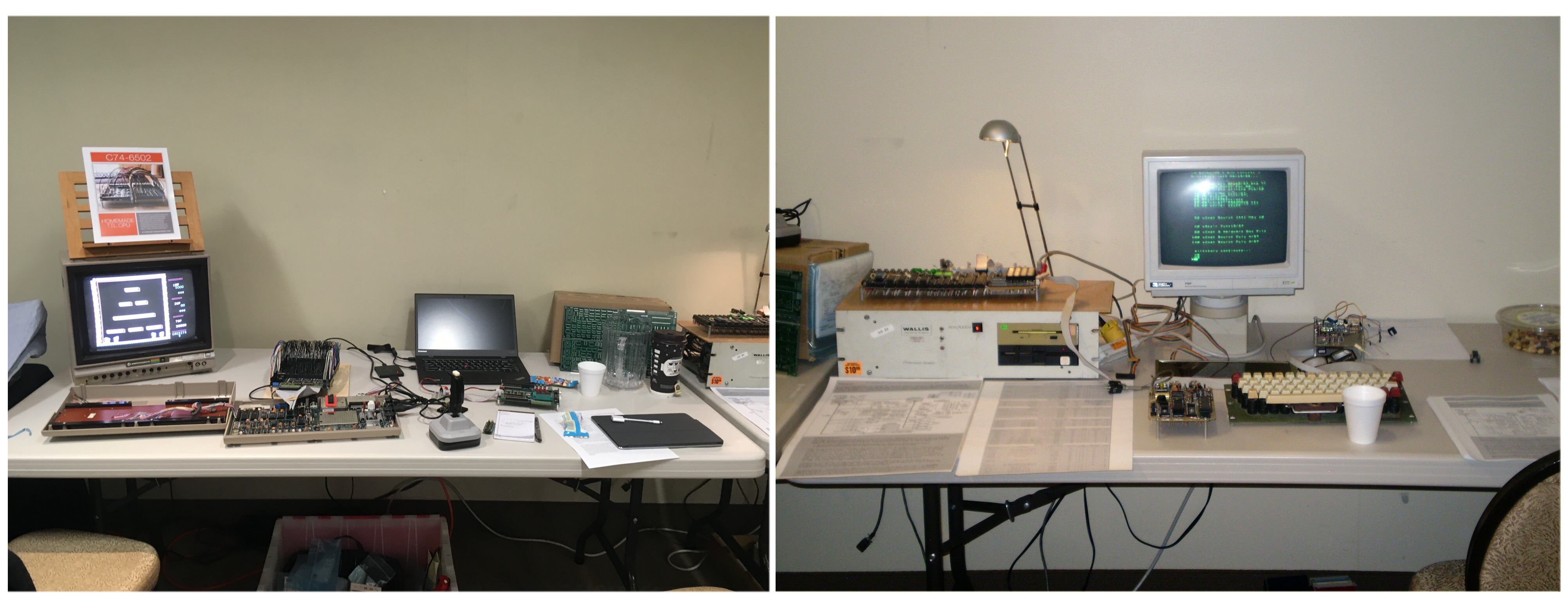

A great day at the World Of Commodore conference in Toronto!
Dr Jefyll and I had an opportunity to show the TTL CPU and Jeff’s TTL-enhanced CPU (a.k.a KimKlone). Both were very well received, with a steady stream of folks coming over to see the CPU guys in the corner of the room. Here are some pics from the day:
File comment: The TTL CPU and KimKlone on display
