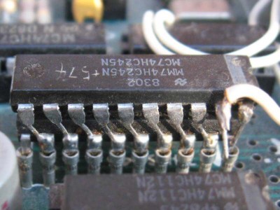

I myself have often stacked chips, usually in unremarkable (though highly expedient) ways. But the photos below show a slight departure from the norm.
What we see is a Z80 SBC that features an 'hc574 used as an 8-bit output port. But because it was sometimes necessary to update fewer than all 8 bits there was a need to know what the existing data was. At first I managed that by maintaining a duplicate copy of the port's contents in RAM -- a workable but slightly cumbersome solution. It'd be better if the port itself could be read back... :idea:
Readback capability took the form of an 'hc245 soldered on top of the '574. As you can see, it was necessary to stagger the pins to make the appropriate connections line up!
Yuh got all the angles covered. :D

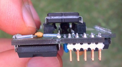

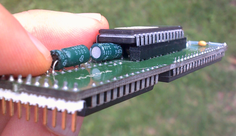

Stacking made good use of space; but besides being kind of messy, it was too labor-intensive to do a lot of, like to supply modules to others for their projects.  Putting parts on both sides can be done with thru-hole parts too, if you stagger the rows of IC pins.  You can either use socket strips on the first side so the other side can be soldered before putting the IC in the first side, or you have to be able to solder the ICs from the top of the pins instead of under the board.
