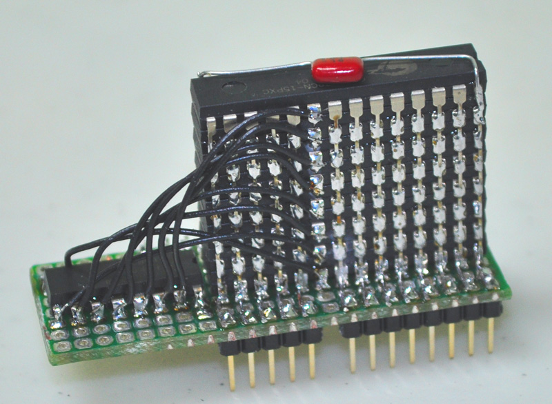

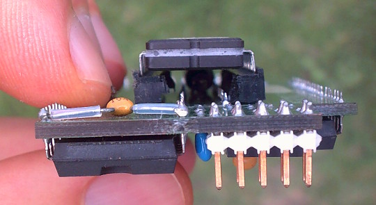

Garth Wilson stacks four 512Kx8 SRAMs on a DIP header to get 2Mx8, with a 74AC139 stood on edge at the end to select the right chip.
viewtopic.php?p=7564#p7564
Garth Wilson's stack of 8 chips with a side order of decoder
viewtopic.php?f=4&t=2322&start=30
(More from Garth on this page)

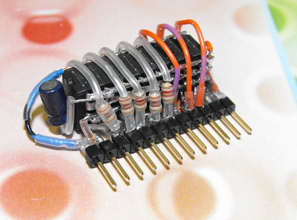

Duane Degn stacks 8 serial chips to make a byte serial memory
http://forums.parallax.com/discussion/1 ... it-version

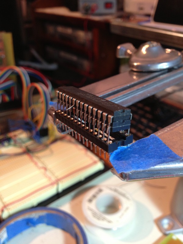

Quinn Dunki's Veronica machine piggybacks two RAMs

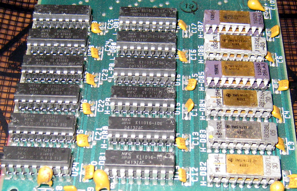

IBM's own 64k memory expansion for the 5150 PC used stacked chips.
http://www.minuszerodegrees.net/5150/ea ... _early.htm

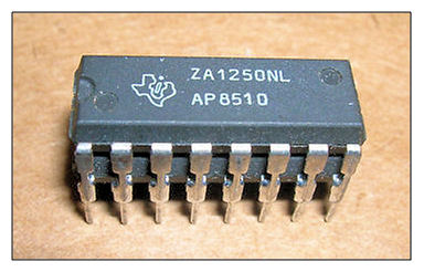

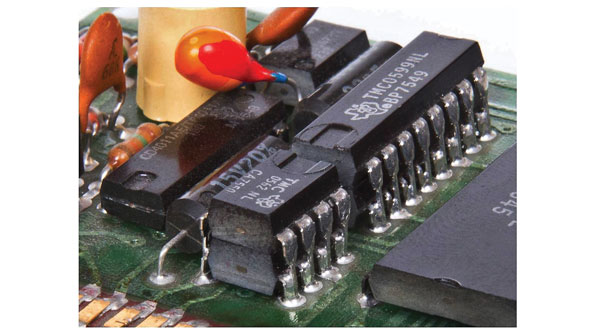

And again: this pair of 64Kbit, plastic-packaged DRAMs in DIPs have been stacked and soldered together at the Texas Instruments factory to produce a 128Kbit device with a small footprint. This product is destined for a socket in an IBM PC/AT clone that had broken the 640K barrier"
https://eda360insider.wordpress.com/201 ... packaging/

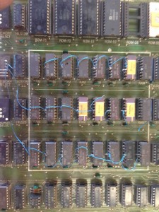

Stacked chips in John Draper’s 24k Apple II, from "Captain Crunch’s Memory Modification" at
http://www.willegal.net/blog/?p=7246

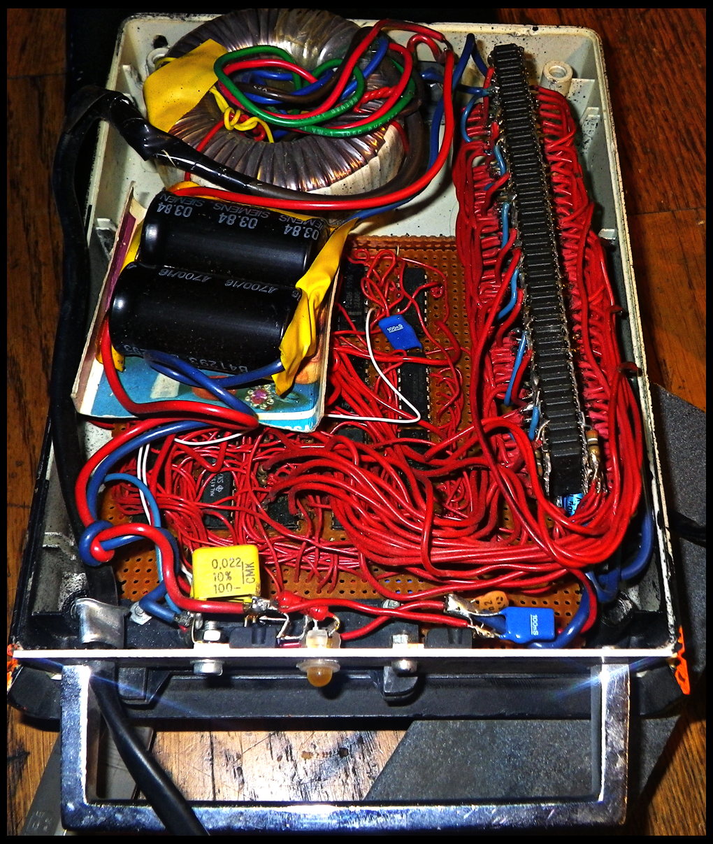

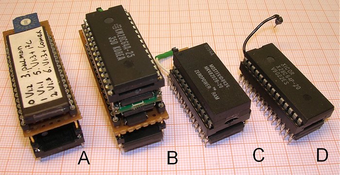

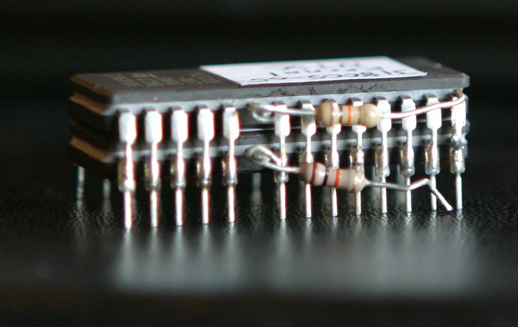

Ronald Dekker stacks EPROM and SRAM in his "tiny but powerful stand alone BASIC microcomputer, not larger than the size of a package of cigarettes built entirely from salvaged components, just for fun!"
See
http://www.dos4ever.com/8031board/8031board.html
"This early 1980s “advanced” calculator board included dual in-line packages (DIPs) stacked on top of each other."

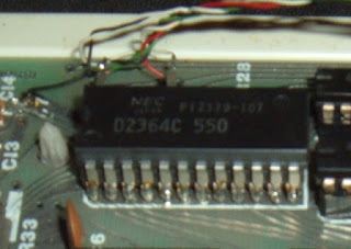

Dave Curran discovered this stacked rom version switcher when refurbishing a ZX80
http://blog.tynemouthsoftware.co.uk/201 ... epair.html

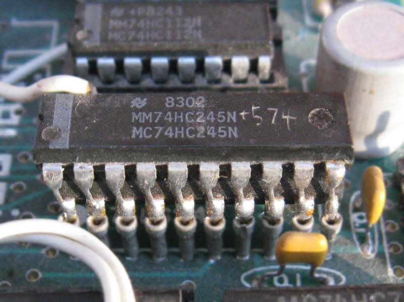

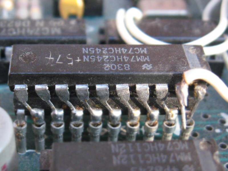

I myself have often stacked chips, usually in unremarkable (though highly expedient) ways. But the photos below show a slight departure from the norm.
What we see is a Z80 SBC that features an 'hc574 used as an 8-bit output port. But because it was sometimes necessary to update fewer than all 8 bits there was a need to know what the existing data was. At first I managed that by maintaining a duplicate copy of the port's contents in RAM -- a workable but slightly cumbersome solution. It'd be better if the port itself could be read back... :idea:
Readback capability took the form of an 'hc245 soldered on top of the '574. As you can see, it was necessary to stagger the pins to make the appropriate connections line up!
Yuh got all the angles covered. :D

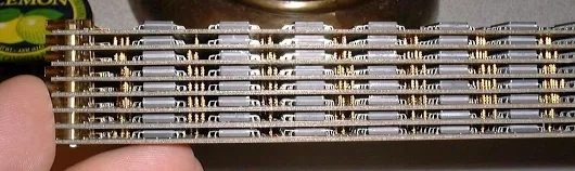

These are neither stacked nor DIP, but I thought it fit in here. This is the 8-way stacked QIP-bearing "module" found in a 1985 Cray-2: 300 modules, 750 chips on each, several hundred watts from each module, immersed in 200 gallons of pumped inert coolant. AFAICT, most of the memory chips (75000 of them) would be 256kbit. The logic chips are 16-gate programmable. Four heavy duty CPUs running at 240MHz. More detail here.

My stacked 512Kx8 SRAMs in Ed's pictures above were things that eventually led up to the 4Mx8 10ns 5V SRAM module I offer, with parts on both sides:
I have three different connector options.
Stacking made good use of space; but besides being kind of messy, it was too labor-intensive to do a lot of, like to supply modules to others for their projects.  Putting parts on both sides can be done with thru-hole parts too, if you stagger the rows of IC pins.  You can either use socket strips on the first side so the other side can be soldered before putting the IC in the first side, or you have to be able to solder the ICs from the top of the pins instead of under the board.
