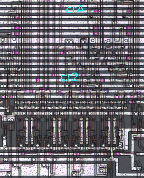

Let's give this a go. It is probably one of the more cluttered parts of the die shot, but I think in this case we know what should be here. It is apparently register CR2, so I'm guessing that there is an 8-bit flip flop in there somewhere. Those 8 short vertical metal lines look suspiciously related. The bits showing up underneath those must therefore be components of the flip flops? There is definitely a pattern there that is repeated 8 times.
The bit near the top of the image seems to be selecting the register based on the address line values but where all the transistors are I have no idea.
It is possible that the labels are obscuring some of the detail, so I could post the same section from the unlabelled version if you think it would be required. I saved the image as jpeg so as to make it a lot smaller, but it has lost the crispness of the labels. The f1 label towards the bottom I think must be one of the clock lines, and the wide white metal bit at the bottom is gnd (if I have followed the line correctly). Also the thicker white line through the middle is gnd. Most of the narrower lines horizontally across the middle are either address lines or data lines. I think I haven't quite captured enough of those lines. The horizontal metal lines (as shown in the attachment) go in this order from the top: D2, D3, A0in, #A0in, A1in, #A1in, A2in, GND, #A2in, A3in, #A3in, ?, ?, D4, D5, ?, D6, D7 (where the ? are where I'm not sure yet). D1 and D0 appear in the original image immediately above this cropped section.
As I say, the original image is clearer than this, but the image, even for this small section, was going to be quite large as a PNG.

OK, let's look at a small portion:
3 bits cropped
3 bits cropped
You're quite right that colours come from thin-film effects: in some processes poly is red and active is green, in some processes it's the other way around.
If we start by recognising the typical shapes of poly and active (diffusion) where they are not covered by metal, it will be easier to later identify them where they are covered.
Poly is generally thin, whereas active is usually larger: poly is going from one place to another whereas active is covering an area. The crucial thing is that poly crosses active to make a transistor: so it overlaps an active region a bit and then stops. Both poly and active will surround any contacts - so spotting the contacts first will help. If there's ambiguity about where the edge of active is, looking at the poly will often help.
In this case poly is red whereas active is blueish. The field oxide (the negation of active) is greenish. There's just one layer of metal, and therefore only one type of contact cut which connects metal down to whatever is below. This process also allows for a butted or buried contact, where poly connects to active (without making a transistor)
I've traced the edges of some active here, and the centrelines of some poly - there's are two mirrored versions of the same structure which should help you see which edges I've followed:
As every contact cut must connect from metal down to something, you can use that to orientate yourself as to whether you're inside a shape or outside it.
The L-shaped fat poly towards the right is indicating a weak transistor: normally that will prove to be a pullup. It's still poly crossing active, but it looks like a thin meander of active running under a big rectangle of poly.
The fat poly to the left (inverted L shape) is certainly a pull up. In this case at the north edge where the active approaches the poly you see a faintly outlined rectangle. That's the buried contact: the poly and active are electrically connected. That's typical for the output of a gate: the poly continues south as a normal width line, carrying that output signal.
Once you're under metal, you need to look at edges and see which shape and layer they must logically belong to.
Hope that helps a bit: I feel I could have done better...
