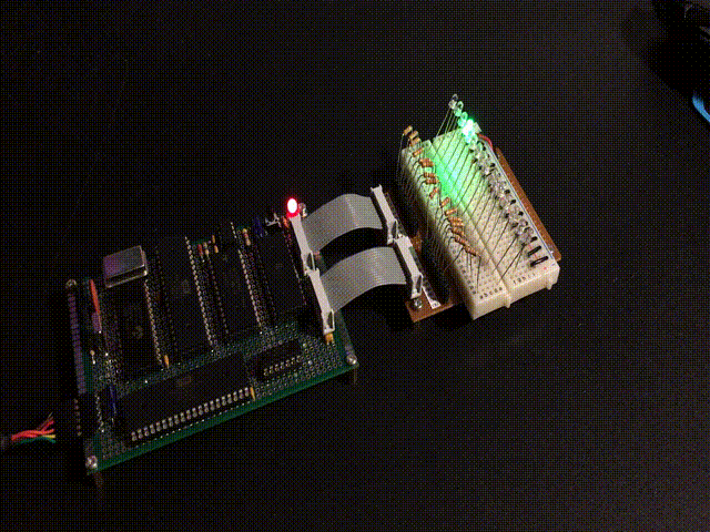

When in doubt, a shotgun approach is always a valid option, even if it's not an elegant one! I got in the CY62256N SRAM chip today and swap it in for the AS6C62256, without changing any of the wiring, and things are now working as expected. That'll teach me to order parts for someone else's design without verifying I'm matching their BOM. The only thing I can think of is the 55ns vs. the 70ns access time was enough of a difference to cause an issue.

With some head scratching, I finally got my Cylon assembly code modified to run in EhBASIC! Now that I have a functioning board, let the fun begin!
