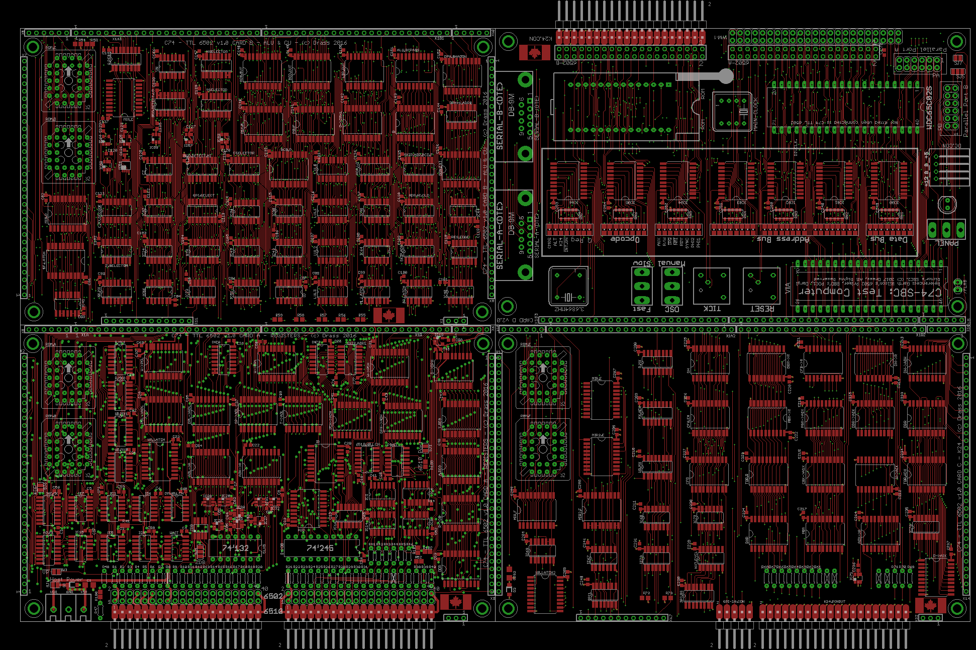

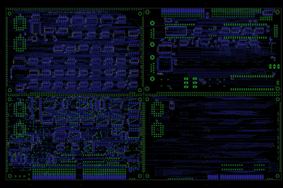

Use a small signal Schottky diode to isolate RDY from whatever is connected to it, along with a suitable pullup resistor in the 2.2K to 3.3K range.
Thanks for the tip BDD. I took the opportunity to google around and learn a bit about basic applications for diodes. Very helpful to get a pointer in the right direction. :)
And speaking of helpful, ttlworks was very kind to merge the 4 board files of the CPU into a beautiful panel (unfortunately not something I could do myself without the full version of Eagle CAD). Thank you ttlworks!
It's been a long time coming, but it's sure exciting to finally get here. And now it's off to the board house .. ahoy! :D
Attached are the op and bottom layers of the panel.

PostPosted: Tue Sep 12, 2017 10:51 pm
Posts: 428
Location: Toronto, ON
It's here !!! :D
Man, oh man ... it's a beast:
Card A: Registers, Card B: ALU & CU, Card C: K24 and Card D: SBC - all in one panel. I had a quick look and noticed some vias were uncovered (I specified tented vias). That may prove to be a problem, since some of these vias are quite close to adjacent pads and I may bridge them when soldering. We'll have to see about that. The more immediate issue, however, is the v-scoring ...
The board house description is that a "V" shaped groove is "scored" into the panel on both the top and bottom surfaces along the boundary lines between each board (the groove is just visible in the pic above on the edge of the panel). The idea is that the individual boards can be snapped apart along these grooves. Sounds straight forward enough, but in fact the cuts in this instance are on the top-side only and enough material remains to make the panel flex unnervingly rather than snap. I'm thinking an exacto knife and a ruler may help cut a deep enough groove for a clean snap, but any suggestions on this 'score' are most welcome. :)
Anyway, I'm delighted to have the panel here. It will be a few days yet before I can get soldering - can't wait ...
Cheers for now,
Drass
