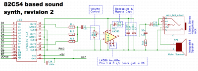

Me wrote:
Gain: 20
Desired Output Max: 1.5V
Desired Input Max: 1.5/20 = 75mV
2500/75 = 33.3
Rser/Rpot = 33.0
Rpot = 10000 -> Rser = 330000.
3 Channels -> Rser = 330000 * 3 = ~1000000 = 1M
speaker is 8 ohm
P=U²/R -> P = 1.5² / 8 = 281.25mW
All looks good, for the 8ohm speaker at least. How well do you think this will work on typical headphones? Looking at your second post, I would guess it should work OK. on 32ohm impedance it comes out at 70mW peak power... i.e. 70x 96dB equals..... 132dB, I think. That seems like a lot. Perhaps a series resistor on the ground return from the headphones might be a good idea, to limit the power a bit.
Oh yes, and what about a reverse bias protection diode across the speaker, headphones or both?
Here's the new schematic taking into account the suggested changes.
File comment: 82C54-based Sound Synth circuit schematic, revision 2.
Incorporating suggested changes by GaBuZoMeu
Speaker & headphones are designed (and require) to work with AC signals :D
The schematic looks fine. As either a headphone or your loudspeaker is connected to the negative side of the 250µF there is no need for a 1..10K discharge resistor. Probably you will get a plop when power is turned on, but thats only a cosmetic problem.

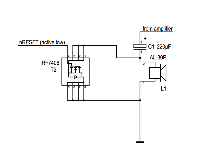

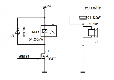

What I mentioned was something like this:
During Reset (active low) the BS170 is not driven, so the relay is closed, any signal to the speaker (the plop) is suppressed. When Reset is through the relay toggles, the speaker can work as normal.
The only drawback is the size and the power consumption. There may be some relays with lesser current requirements.

This is easier:
A P-channel MOSFET is turned ON during nRESET only. When nRESET becomes high, the MOSFET becomes non conductive. The IRF7406 should be sufficient.

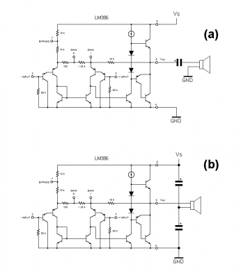

PostPosted: Sun Jun 11, 2017 10:15 pm
Yes, there's usually a large capacitor in series with the loudspeaker -- as shown in (a) -- and it can result in a pop or thump on power-up. That can be avoided if you use two capacitors, each half the original value, as shown in (b). This works best when the amplifier is powered by a regulated power supply. (That's because low-frequency supply noise, if any, may become audible in the speaker.)
Of course there may be other reasons for a circuit to produce a thump on power-up, and the two-capacitor solution won't address those other issues if they exist. (A muting circuit, as shown in GaBuZoMeu's latest post, is more general solution.)
PostPosted: Mon Jun 12, 2017 12:08 am
Posts: 8546
GaBuZoMeu wrote:
edit(1):
This is easier:
However, note the diode integrated with the MOSFET, from the source to the drain, which will tun on during the negative-going half of the signal, producing distortion, except with small signals.
PostPosted: Mon Jun 12, 2017 12:37 am
Posts: 660
Location: North-Germany
Thank you Garth - i have overseen that !!
So I have to recommend the relay variant. This sadly means 120..200 mW of power requirements during runtime :(
