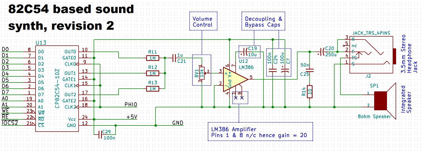

You don't need that formula, Gain is roughly 20. To get 1Veff out (which isn't much for the speaker) you need 50mVeff at the input.
You have maximum 5V/0V at the input (before pot) - simple assume all three channels produce the same signal and the effect of the capacitors (C21..) is nearly zero due to high frequency.
This 5V/0V rectangle is equivalent to 2.5Veff - that is more than you wish to have at the outside :)
So you need to attenuate the sources by 2500/50 = 50. If you never ever want a higher amplitude, than Rser/Rpot must yield 50. That would roughly mean Rser = 470K, but as there are 3 in parallel (worst case) you need 1M5 (for R11, R12, R13 each).
As I said 1Veff out isn't much, P = U²/R = 1/8 = 125mW, a little more would helpful, say 250..400mW. Well we have P = U²/R so doubling U would mean 4x P. If you choose R11.. to 1M you would have upto 1,5x signal so 2,25x wattage. As this is peak power everything is fine.
I personally would choose R11,.. to 470K with a little risk of peak distortions.
One more hint: if you first join R11, R12, R13 and then insert the cap you save two caps. :D
Ah, and a 100µ or more supply bypass cap (parallel to C24) - the better the supply the better the sound :lol:

Max 281mW as per 1M resistors sounds good to me. It means swapping out the speaker for one that can do 300mW (the one I had lined up is only good for 200mW), but that's not a problem. Also the particular LM386 i've got is only rated for 375mW output, so we can't go much higher without it being a risk endeavour.
I double-checked the calculations for 1M myself, partly to see if I understood it (this is all a learning exercise afterall!) and to be doubly sure you hadn't made an arithmetic error.
Me wrote:
Gain: 20
Desired Output Max: 1.5V
Desired Input Max: 1.5/20 = 75mV
2500/75 = 33.3
Rser/Rpot = 33.0
Rpot = 10000 -> Rser = 330000.
3 Channels -> Rser = 330000 * 3 = ~1000000 = 1M
speaker is 8 ohm
P=U²/R -> P = 1.5² / 8 = 281.25mW
All looks good, for the 8ohm speaker at least. How well do you think this will work on typical headphones? Looking at your second post, I would guess it should work OK. on 32ohm impedance it comes out at 70mW peak power... i.e. 70x 96dB equals..... 132dB, I think. That seems like a lot. Perhaps a series resistor on the ground return from the headphones might be a good idea, to limit the power a bit.
Oh yes, and what about a reverse bias protection diode across the speaker, headphones or both?
Here's the new schematic taking into account the suggested changes.
Speaker & headphones are designed (and require) to work with AC signals :D
The schematic looks fine. As either a headphone or your loudspeaker is connected to the negative side of the 250µF there is no need for a 1..10K discharge resistor. Probably you will get a plop when power is turned on, but thats only a cosmetic problem.
Good point. No diode.
I agree.
Well, the LM386 datasheet (pg 9) says the inputs are internally biased to ground which I believe would resolve that issue, unless I'm misunderstanding the cause. I agree that "plop" is not the end of the world, but I'd rather avoid it if it can be avoided.
Thoughts on series resistor between the headphone's return and ground, to limit the effective dBs?
Incidentally I want to thank you for your help thus far. Clearly I got the wrong end of the stick with my original calculations and would have ended up with some crazy high output...

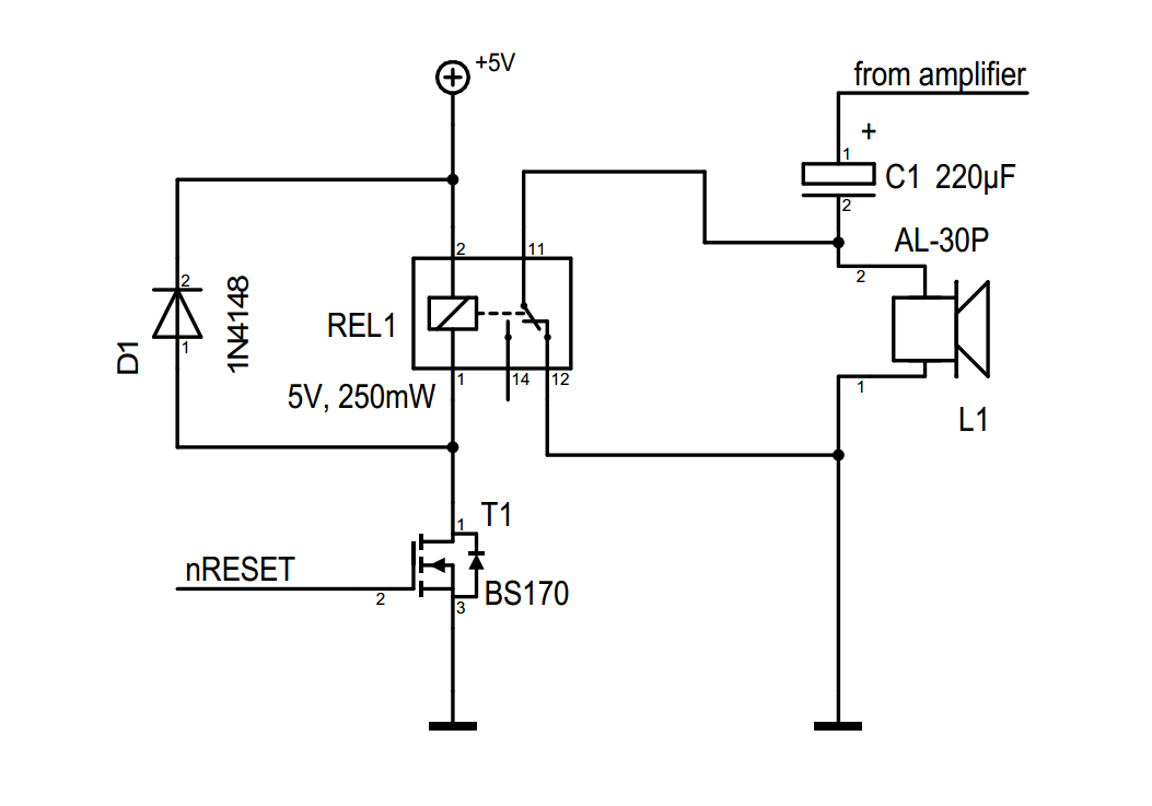

What I mentioned was something like this:
During Reset (active low) the BS170 is not driven, so the relay is closed, any signal to the speaker (the plop) is suppressed. When Reset is through the relay toggles, the speaker can work as normal.
The only drawback is the size and the power consumption. There may be some relays with lesser current requirements.

PostPosted: Sun Jun 11, 2017 10:15 pm

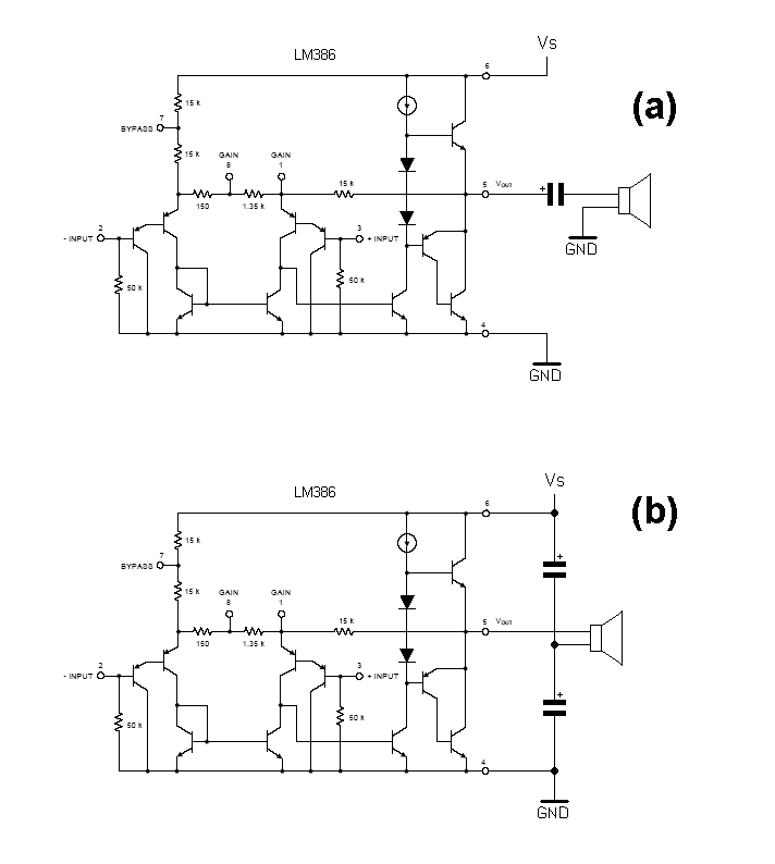

Yes, there's usually a large capacitor in series with the loudspeaker -- as shown in (a) -- and it can result in a pop or thump on power-up. That can be avoided if you use two capacitors, each half the original value, as shown in (b). This works best when the amplifier is powered by a regulated power supply. (That's because low-frequency supply noise, if any, may become audible in the speaker.)
Of course there may be other reasons for a circuit to produce a thump on power-up, and the two-capacitor solution won't address those other issues if they exist. (A muting circuit, as shown in GaBuZoMeu's latest post, is more general solution.)
PostPosted: Mon Jun 12, 2017 12:08 am

GaBuZoMeu wrote:
edit(1):
This is easier:
A P-channel MOSFET is turned ON during nRESET only. When nRESET becomes high, the MOSFET becomes non conductive. The IRF7406 should be sufficient.
However, note the diode integrated with the MOSFET, from the source to the drain, which will tun on during the negative-going half of the signal, producing distortion, except with small signals.
PostPosted: Mon Jun 12, 2017 12:37 am
Posts: 660
Location: North-Germany
Thank you Garth - i have overseen that !!
So I have to recommend the relay variant. This sadly means 120..200 mW of power requirements during runtime :(
