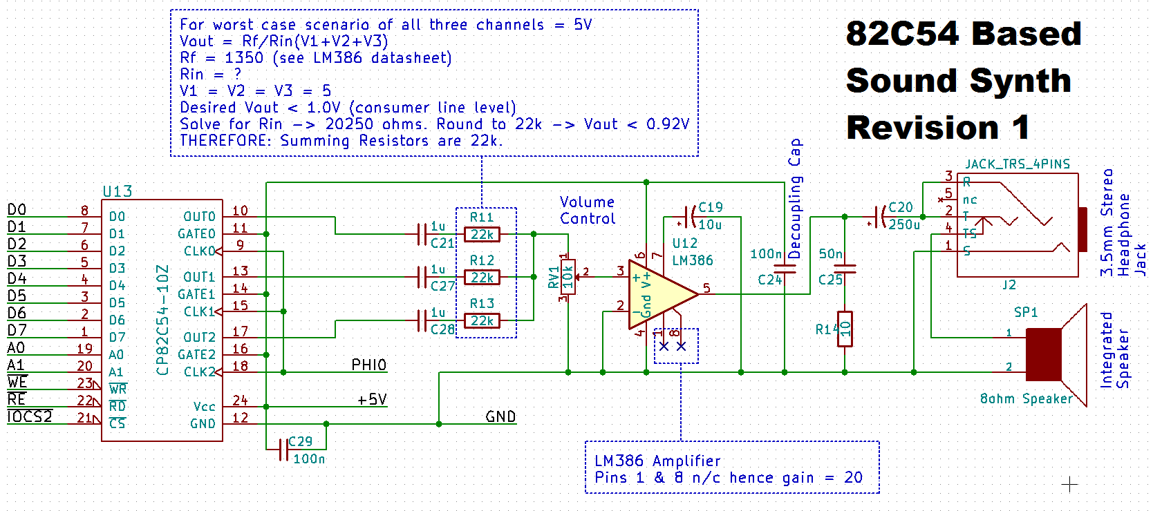

The 82C54 looks very promising, based on my best understanding of the datasheet.
Basically, wire up the master clock (2MHz) to the clock inputs of each of the three counters. Load the 16-bit counters with N = CLK/F, where N is the counter value, CLK is the master clock and F is the desired frequency. Set the counters to Mode 3.
Now, the output pin of the counter will be a 50% duty cycle square wave of the frequency F until it is changed. Optionally stick an RC filter on the output(s) to turn them into sine waves and then feed them into a combining op-amp structure, and voila, 3-voice sound. The range of possible frequencies is between approximately 30.5Hz at N=65535 to 2MHz at N=1, easily encompassing the human hearing range, and getting progressively more accurate the closer we approach the lower end.
For example, middle C has a frequency of approximately 261.626Hz...
N = 2000000/261.626 => therefore N = 7644.5.
Round up to 7645.
Check....
F = 1/(N/2000000) => therefore F = 261.608Hz, a margin of error of 0.00007%.
Main down side: no ability to vary the duty cycle (and thus relative volume) of the channels.

FYI: it is not necessary to try to get sine waves - they sound pretty dull. A 50:50 square wave has lots of overtones (3., 5., 7.,... harmonics) that makes it sounds brighter. And perhaps you should try (if possible, I know it works for the 6840, but I didn't go deep into the 8254) variable duty cycle 10:90 or modulated (every few 10th of a second changed) from 10:90 .. 50:50. The smaller the duty cycle the brighter the sound (more overtones). But sadly the volume will change a bit. Thats a huge playfield. Have fun :D

Pretty sure its not possible to vary the duty cycle using the 82C54, unfortunately.

How does this look to people?
I'm particularly unsure about my maths with regard to the 22k resistors, especially given I've thrown in that 10k pot for volume control.
Op-amps was always one my weakest subjects...
I have also never been able to find a straight answer with regards to what voltage a headphone output actually should be, peak to peak. Best I can work out? Somewhere between 0.5V and 1.5V depending on how fancy the audio equipment is - fancier equipment outputting higher voltages.
82C54-based Sound Synth circuit schematic, revision 1.
