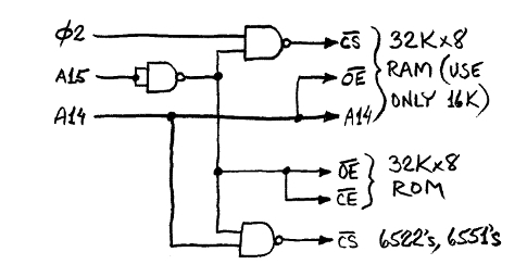

So, I have a little 65C02 soldered up on a protoboard.
I am using the address decoding from the primer (16K RAM, 32K ROM).
Here: http://wilsonminesco.com/6502primer/addr_decoding.html

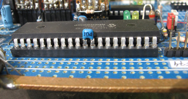

Here's a capacitor soldered to adjacent power & ground pins, something I did on a PIC microcontroller a few years ago:

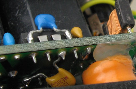

Here's one we had to do on a production run of boards in about 1994. After this run was assembled, we found out that Maxim changed the wafer process and increased the slew rate on the switching in this switching power supply controller, causing ringing and other problems that made a lot of electrical noise that got into the aircraft radios. Rather than scrap the whole lot and not having anything to sell until the board could be re-designed, we reworked them by hand, putting this capacitor on the top of the 8-pin IC, making the shortest connection we could between the capacitor and the die of the IC. (The die is the actual chip inside the IC.) It worked well.
Although I used the same IC on subsequent designs, I did the board layout different. The last one was six or eight years ago; and although much of the board was surface-mount, the space was very limited, and I couldn't get fit SMT version of the IC in, but I could get the thru-hole one in, because I could put chip capacitors underneath it, between the board and the body of the IC, with the connections as short as possible. Operation was very quiet and stable. (The SMT version didn't leave enough space underneath to put the chip capacitors.)
The bad is that on a two-layer board you've got those connections smack in the middle between address and data pins, which complicates routing.
True, and when 7400 TTL was first out, I imagine 2-layer boards were not very common. In my early days of electronics as a poor paper boy who had to take apart old and surplus electronics to get parts, I remember even logic boards that were single-sided. As a side note, apparently thru-plating wasn't very reliable yet, and sometimes hollow rivets were used for the purpose.
