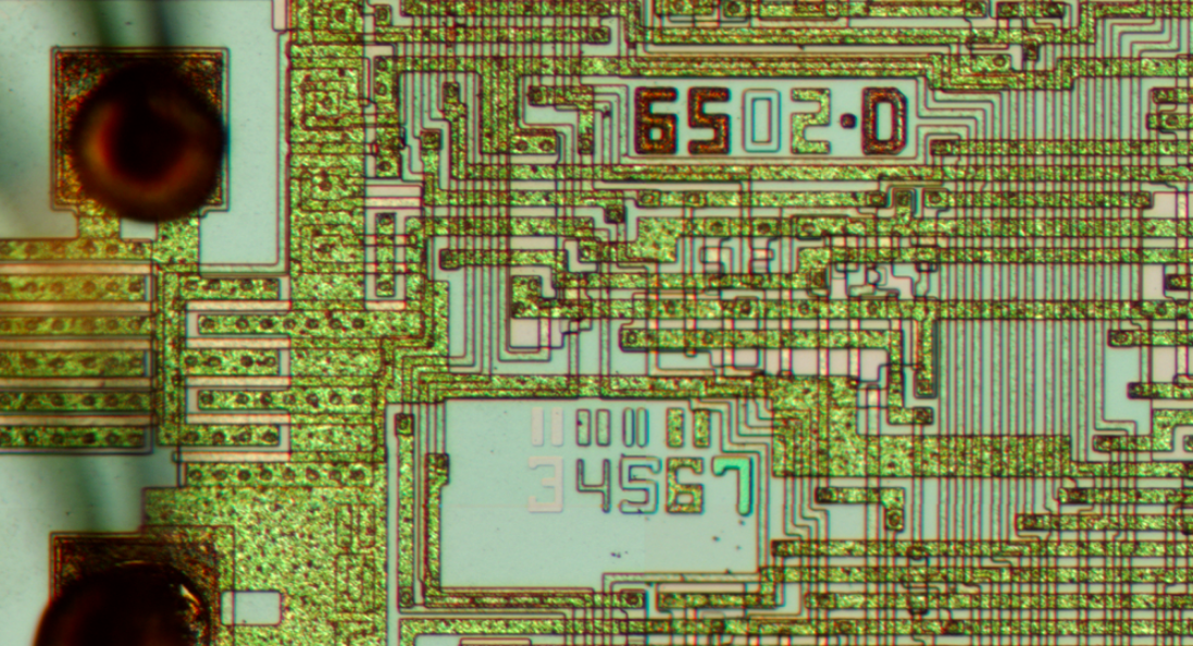

There is a little branding on the 6502, perhaps you'd be able to recreate it in vector form. There's a 6502D on the visual6502 one: huge huge image here
http://visual6502.org/images/6502/6502_ ... F_4677.png
and see the attached closeup.

It looks like the branding was removed from the SVG image - its certainly not there in the emulator - will have a look at the layers when I get home.
It looks like the original die had different letters of 6502.D on different layers. Should not be too difficult to vector it from the image and drop it back in the DXF. Should be legible in the laser cut even though it is small. Looks like there is also a test pattern (34567) below which is missing from the SVG - will add that back in too.

Yes, I suspect the visual6502 team only traced the polygons which were functional - or, they dropped unconnected polygons at some point. The different colours of the 3 4 5 6 7 will help determine which layers are which elsewhere, if it's ambiguous. I would guess the "MOS" letters are in poly. Probably layer 4? Then 5 would be contact cut, 6 metal and 7 overglass.
