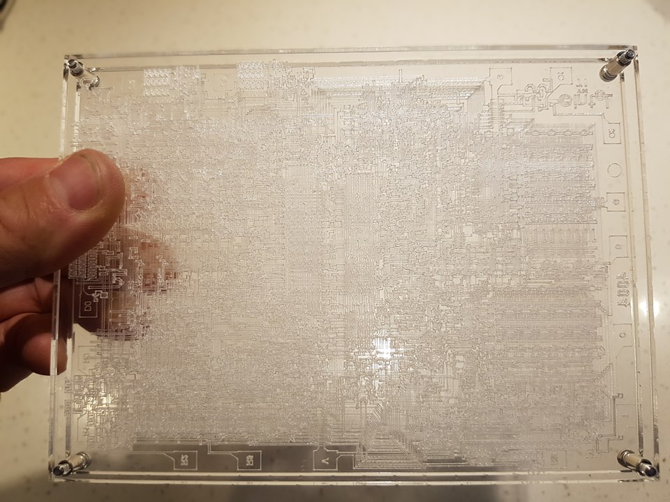

I have been laser cutting some 4004 dies into acrylic (just for fun) and was thinking of doing the same for a 6502. I had a look at the visual6502 simulator but the vector files seem to be embedded in a javascript file. Does anyone know where I can source them is some other format?
I am happy to give a laser cut 6502 to anyone who helps (and assuming that I can actually get the cut done).
See the attached 4004 - this is cut in 3 layers - metal, poly and diffusion - it does not include vias - might get round to adding these in the future. This was from some die shots off the 4004 web site which I vectorised using Corel trace - this approach will not work for the 6502 as the files end up too big.

Not sure what you mean by pale coloured stock? - it is not obvious from the pic but there dies are cut on 3 separate layers and then you can see them align when you look through - needs to be clear for that to work.

Really beautiful. Just what kind of materials does a laser-thingie like that do? I had my MacBook lasered at the time (expensive, but well worth it), so I know about that aluminum stuff.

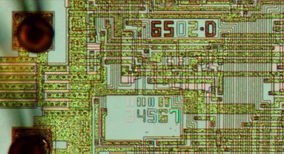

There is a little branding on the 6502, perhaps you'd be able to recreate it in vector form. There's a 6502D on the visual6502 one: huge huge image here
http://visual6502.org/images/6502/6502_ ... F_4677.png
and see the attached closeup.

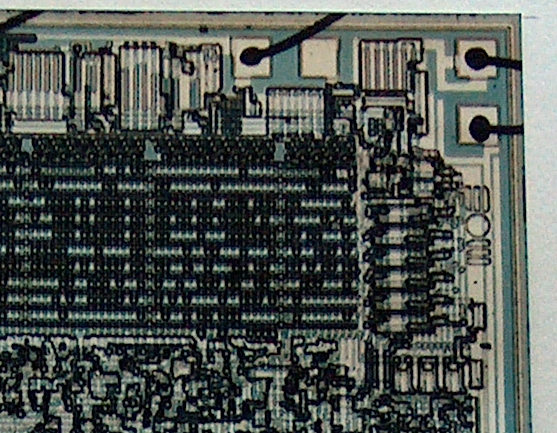

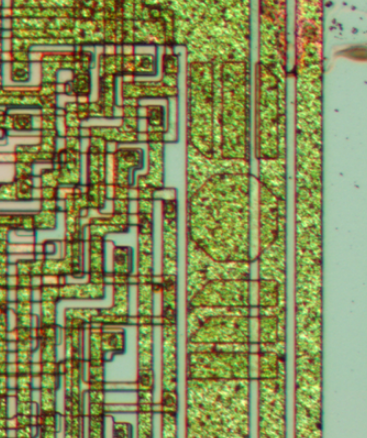

I'm pretty sure some 6502 chips have an "MOS" on them. There are lots of chips at
https://commons.wikimedia.org/wiki/User:Birdman86
but his 6502 seems to be a 6502A without "MOS". (Actually, knowing where to look, it is there - left end of the top edge. See below. So we can also find it on the Visual 6502 image now, at top end of the right edge - see attached.)
Ah, here it is - see second attachment - from this large image
http://archive.computerhistory.org/reso ... 631294.jpg

It looks like the branding was removed from the SVG image - its certainly not there in the emulator - will have a look at the layers when I get home.
It looks like the original die had different letters of 6502.D on different layers. Should not be too difficult to vector it from the image and drop it back in the DXF. Should be legible in the laser cut even though it is small. Looks like there is also a test pattern (34567) below which is missing from the SVG - will add that back in too.
Re: 6502 Vector image
Yes, I suspect the visual6502 team only traced the polygons which were functional - or, they dropped unconnected polygons at some point. The different colours of the 3 4 5 6 7 will help determine which layers are which elsewhere, if it's ambiguous. I would guess the "MOS" letters are in poly. Probably layer 4? Then 5 would be contact cut, 6 metal and 7 overglass.
