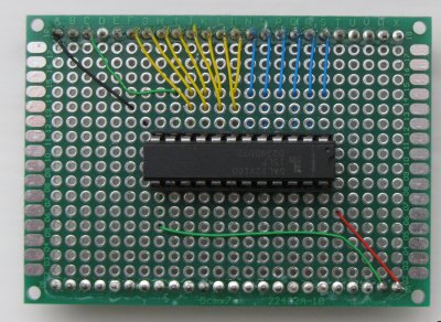

How about using a PLD as both boot ROM and chip select logic.
As a proof of concept, I managed to squeeze 49 bytes of rom into a 22V10. That used 6 inputs for the address bus (blue), one each for chip select and output enable (green) and 8 outputs for data (yellow). That leaves 2 more I/O pins and 4 inputs for more normal logic functions.
File comment: 49 bytes of "rom" in a GAL
The proof of concept rom happens to be a minimalist IDE/CF boot loader in Z80 code. I don't know enough about 6502 hardware and software to know if a boot loader can be made small enough and the hardware simple enough to do something similar.
Possible though ??

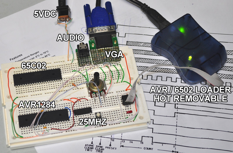

Let me clarify some of the rules I have set for myself and the reason...
This is all about chip breadboard count, and nothing else.
Imagine being a noob, and only needing to drop down 2 chips.... nice way to begin!
My goal : 10 minutes of work for under $50.00, and you are now coding a real 6502.
You soon see your code come to life in sound and video. No ROMs!
Anyhow, this is a personal challenge, I just wanted to open it up to everyone for fun.
Oh, and about the video... text or graphics.
If a 16x16 pixel display and one tone beeper is all you need to enjoy coding, than that's just fine.
I wasn't going to post anything until the project was at least proven, but I have made some progress...
The goal is to make this into a working 6502 Audio / Video Computer!
What is shown above will have nothing else but wires attached from this point on.
The AVR has 128K of Flash Memory and 16K of fast SRAM.
The 6502 will get most of the SRAM for variables, and about 40K for ROM code.
Pins are scarce, so I may only get mono color text and one channel sound.
I have done some very basic video code for the AVR, and although ugly, it does show text...
This is a 320x480 pixel display over the 640x480 VGA Standard.
Once I clean up the Text Generator, it will be capable of showing 38 x 60 characters.
I have one more test to do that may bring this up to 40 x 60 characters.
Depending on how the 65C02 agrees with fast tri-stating, I may be able to get 64 colors as well!
Sound will be 2 or 4 mixed voices coming out as a mono signal. Music will certainly be possible.
But the ultimate goal of "Easy to Start with 6502" will be met.
That AVR programmer is under twenty bucks, and the AVR is only 10 bucks.
I wrote a BIN converter so that any 6502 assembler can be used (I am using the Kowalski Assembler).
Once you load through the AVR Programmer, it can be pulled right out... this is a fully stand alone 6502 computer.
The AVR is simply a fancy SRAM & ROM with a built in VGA, Sound, and Clock Generator.
If an FPGA / CPLD exists in DIP form, then for sure someone will blow my version away!
And yes, a faster more colorful 2 chip system would be the winner.
And no soldering down of SMD onto DIP adapters allowed this time... it's all about making it easy for anyone to start!
I will be posting the AVR code, and the Assembler Bridge program as soon as this is ready.
An AVR + Programmer can be purchased at just about any electronics supplier.
the 65C02 can be purchased at the Western Design Center.
I will also add the BOM for the connectors and crystal... all are inexpensive as well.
Good to go!

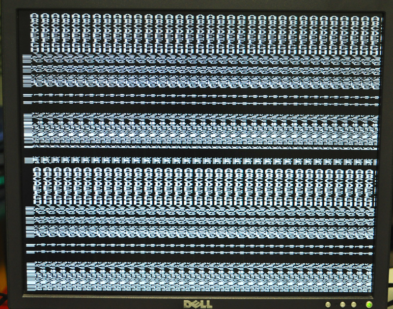

Ok, the code needs some optimization, but I have a 36x60 monochrome display up and running.
Using the crippled SPI in the AVR, I could not achieve a 40 character display because it requires 9 cycles per byte!
I am going to try adding one more chip (75HC574) in order to get a 256 color display. It seems worth it.
That would allow each character to be any one of 256 colors.

Use the USART in SPI mode and you can generate 40 character displays. I've done a 320x200 monochrome display using the ATMega1284. Since there are two USARTS, you can still have a serial console port too.
Daryl
PostPosted: Sun Dec 25, 2016 3:01 am
Posts: 642
Thanks, I was actually just trying to make that work as you responded!
So far, I did get 40 characters, but the SPI seems to send a HI on the TX pin when it is done.
I have tried disabling the SPI and re-enabling at the start of the line, but there is still a rouge pixel.
I have tried every possible combination of modes, but can't get the SPI to invert.
If I could, I would just invert my character ROM and live with that.
I may just control the OE on an external latch and then also use it to gain some color.
I can shave another cycle from my 16 clock loop here, but this is how I do the 40 characters now...

USART is set to SPI at SCLK /2.
Still trying to ditch that inverted idle state somehow in code.

I think what I did was to write a 41st byte that was 0x00 to keep the data pin to stay low until it ran off of the right edge.
Also, I enable to USART and immediately write 0x00 to the UDR register before I start sending characters to keep the left edge low as well. So in actuality, I'm writing 42 bytes per line.
Hope that helps.
Daryl
Here is my code for that section
; init pointers to character data in RAM and then do this code:
   LDI      XH, 0x00
   ldi    xl, (0<<RXEN1)|(1<<TXEN1)
   sts      udr1, xh         ; 2   send 0x00 to SPI, (USART is disabled)
   sts    UCSR1B,   xl                     ; 2  USART is enabled
   sts      udr1, xh         ; 2   send 0x00 to SPI (USART is enabled)
   lpm      xl, Z            ; 3   nop
   lpm      xl, Z            ; 3   nop
   lpm      xl, Z            ; 3   nop
   lpm      xl, Z            ; 3   nop
   lpm      xl, Z            ; 3   nop
