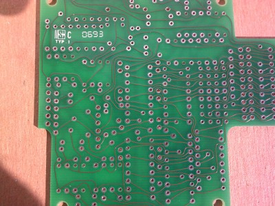

No, when I started, it was 2x or 4x actual size on velum, then put the stable-based transparent material over it, one sheet for each layer, and tape it up with black crepe tape and the patterns we could buy from Bishop Graphics.  The computer boards you see from the 1970's with the curvy traces were laid out that way, and taped up with this adhesive crepe tape that was available in different widths and was easy to turn in rather tight radii.
    Edit, 2022: I found the last board I taped, in 1993, at home for a job on the side, just before I got my own CAD:
    I think I threw out my box of crepe tapes and IC patterns and stuff just a couple of years ago, after not having touched it in over 25 years.<end edit>

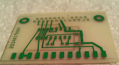

Here is the first board I made with the PCB Fab in a Box process.
It's not pretty, but it's far better than anything I did previously. Ones I made since then were much nicer.

Very nice boards you have done with your own methods. My experiences with producing my own boards have not been very exiting, that was about 30 years ago. I did a lot of etching. I used a lot of different methods like painting with water resistant pens, using tape and stencils for ICs or thermotransfer sheets. But all that was a lot of work and consumed a lot of time. I then switched to verowire and did almost all Projects with verowire, which is very fancy and even complex Projects did work quite well. I also have a NC milling machine and tried milling PCBs. Nothing was really satisfying.
If I take into account all aspects then I doubt very much that selfmade boards are cheaper than using a board house. Dirtypcbs will get you at least 8 dual layer boards with a size of up to 5cm x 5cm for 14USD including shipping. The boards have platedthrough vias and pads and a nice silkscreen and soldermask. You can even have your own shape, provided it fits into a 5cm x 5cm area. If this is not big enough then there is the 10cm x 10cm option for 25USD.
My boards used a non-standard which is not applicable for the cheap Service. And also requires the Maker license of Eagle for 162USD. But I have a complete workflow without the hassle of creating two layouts (top and bottom), Transfer them perfectly alligned to the two sides of the copper plated board and drilling somewhat between 500 to 1000 holes. I draw my schematic, if reequired add parts to my personal library, create the PCB, place the components and layout the Connections. Then I run the CAM Job, zip the files and upload it. For me this "simplicity" is worth to spend some extra bucks and saves me a lot of time.
