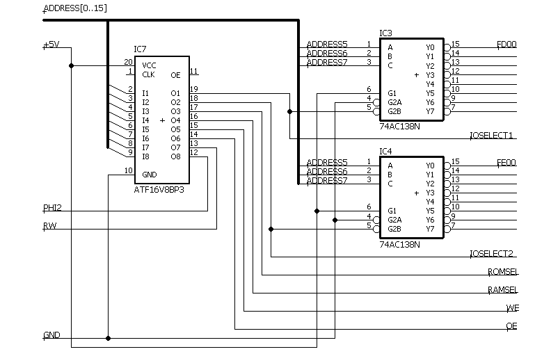

Hi Braincell1973!
Clarify please,
what signals are applied to inputs P0 - P7 of IC5 and IC6?
What jumpers should be shorted?
Vladimir
PostPosted: Thu Nov 03, 2016 5:13 pm
Joined: Tue Nov 01, 2016 9:12 pm
Posts: 14
Hi Vladimir.
The address lines 8 to 15 connect to P
The links select IO page befor the 138 chops the page into 32 bytes x 8
FC00 is 1111 1100 on links
FD00 is 1111 1101 on links
Lee :D

PostPosted: Fri Nov 04, 2016 4:05 am
Joined: Wed Jul 20, 2016 2:14 am
Posts: 78
Location: Irkutsk, Russia
Braincell1973 wrote:
Apart from the wired logic do you think the addressing is otherwise good ??
Lee
Do you hope? There is a lot of work to do :D
For example, if you select ROM or HIRAM, A15 must be HIGH. Right? But, at A15= HIGH your IC2c asserts /LORAMSELECT. Isn't it ?
Really, A15 and /LORAMSELECT should be the same, without any inverting.
Further. If IO is selected, the output of 74AC520 is LOW. Keep this in mind.
One more thing. It seems, you want /HIGHRAMSELECT to be in range $8000 ÷ $BFFF ( i.e. A15=HIGH and A14=LOW). But, I see, you did not do it. At SJ1 = 2-3 your /HIRAMSELECT becomes active for range $0000 - $7FFF. At SJ1 = 1-2 the range becomes $0000 - $BFFF.
And so on. You have something to think about.
Vladimir
P.S. Tell me please (if it is not a secret), what do you benefit from the opportunity to change the basic addresses of IO peripherals? I believe, permutation of any jumper entails the need to rewrite the IO routines. Isn't it?
P.P.S. A8 signal harms the working of AC138 decoders (at least of second one, IC4). Don't route it there. G2A inputs should be grounded. G1 inputs of AC520 likewise.

PostPosted: Sun Nov 06, 2016 6:39 pm
Posts: 14
Hi Vladimir,
Vladimir wrote:
I have a slight suspicion that you do it incorrectly sketched from somewhere
I can now see why you have said this, after trying to use WINCUPL i found your posts on here referencing the "FIELD" statement.But the ideas came from Daryl Rictor's website for me to use a GAL as a quick look at his source code made it look simple enough to program a GAL (I have a tl866cs somewhere).
Here is the revised decoding logic using an atf16v8b,
2 pages for IO at FE00 and FD00 each with 8x 32 byte access
16k ROM
48k RAM

PostPosted: Mon Nov 07, 2016 3:43 pm
Posts: 78
Hi Lee!
The most important thing that I can see, this decoder should be workable.
An other thing I noticed (looking at your screenshot) that you should familiarize yourself with MPU timing diagram. Not all sets of input levels that you do WinSimulate exist in a real system. Nevertheless, the decoder should operate, therefore you can blow off the dust from your programmer and try burning PLD.
Vladimir

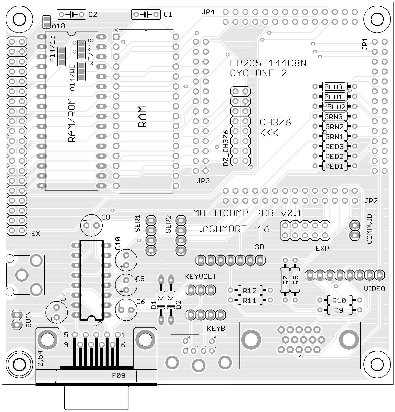

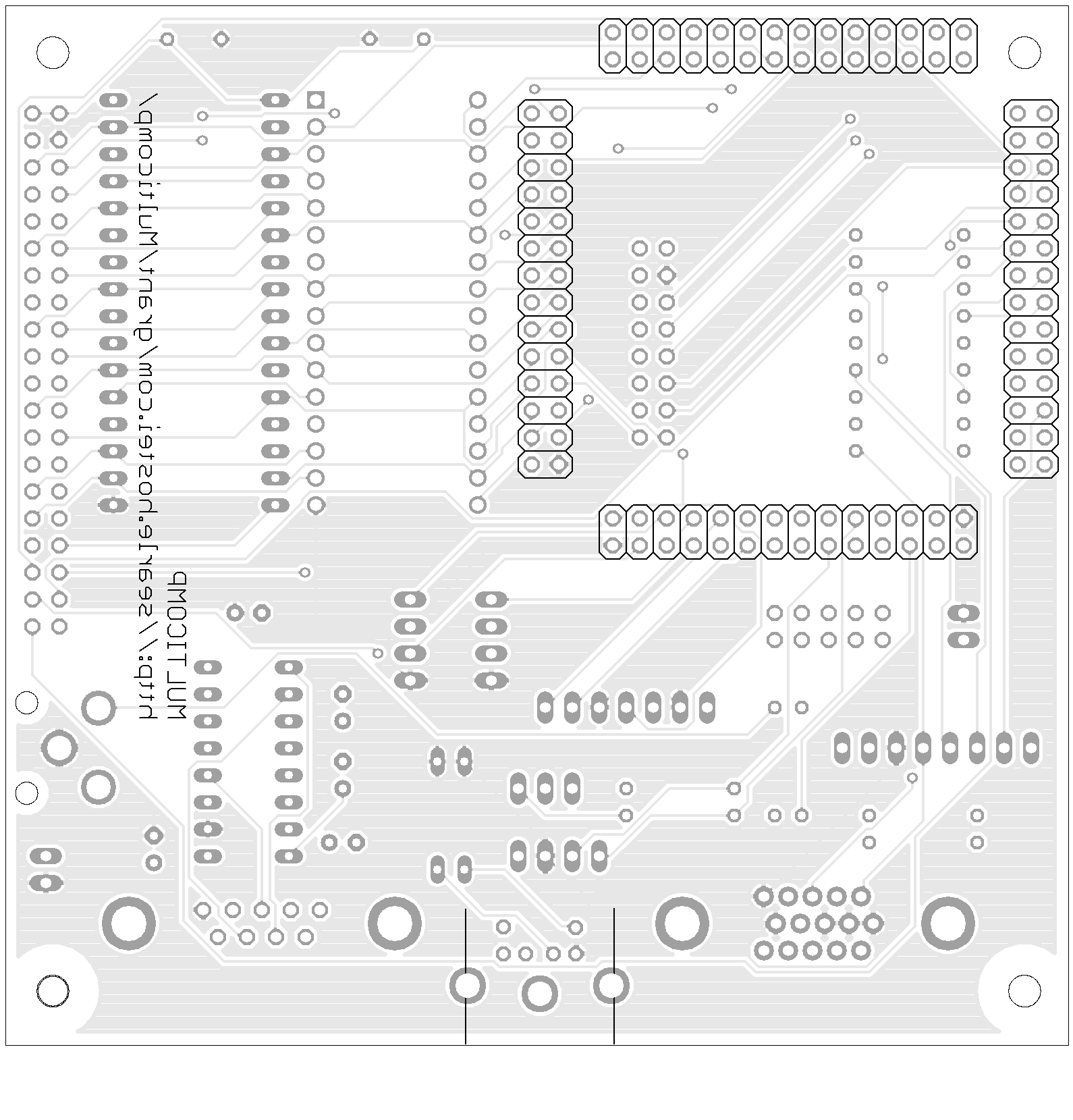

After looking at the gal programs on Daryl Rictors site and the multicomp from grant searle i thought the easiest thing for me to do was start with the multicomp design....
So, I have drawn up a board based on the multicomp cyclone 2 board from ebay.
Added 2 sockets for ram -as6c4008 and a combined rom/ram socket
Expansion bus
Multicom bits ie 2off serial . Sd card . Comp / vga video . Ps2 keyboard
Added max3232 for serial 1
And finally added a ch376 port for the usb boards from ebay.
I have some ideas for a simple MMU and other cool bits
Lee
