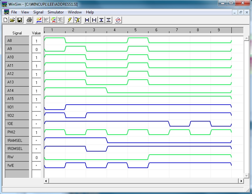

I can now see why you have said this, after trying to use WINCUPL i found your posts on here referencing the "FIELD" statement.But the ideas came from Daryl Rictor's website for me to use a GAL as a quick look at his source code made it look simple enough to program a GAL (I have a tl866cs somewhere).
Here is the revised decoding logic using an atf16v8b,
2 pages for IO at FE00 and FD00 each with 8x 32 byte access
16k ROM
48k RAM
Name     address1 ;
PartNo   001 ;
Date     04/11/2016 ;
Revision 01 ;
Designer Engineer ;
Company  Na ;
Assembly None ;
Location None ;
Device   g16v8a ;
PIN   2  =  A8                        ; /*                                 */
PIN   3  =  A9                        ; /*                                 */
PIN   4  =  A10                       ; /*                                 */
PIN   5  =  A11                       ; /*                                 */
PIN   6  =  A12                       ; /*                                 */
PIN   7  =  A13                       ; /*                                 */
PIN   8  =  A14                       ; /*                                 */
PIN   9  =  A15                       ; /*                                 */
PIN   12  = PHI2                      ; /*                                 */
PIN   13  = RW                        ; /*                                 */
PIN   19  = !IO1                       ; /*                                 */
PIN   18  = !IO2                       ; /*                                 */
PIN   17  = !ROMSEL                    ; /*                                 */
PIN   16  = !RAMSEL                    ; /*                                 */
PIN   15  = !WE                        ; /*                                 */
PIN   14  = !OE                        ; /*                                 */
/* *************** LOGIC *********************/
FIELD ADDRESS = [A15..8]                  ;
IO1 = ADDRESS:[FD00]                         ;
IO2 = ADDRESS:[FE00]                           ;
ROMSEL = ADDRESS:[C000..FCFF]
        # ADDRESS:[FF00..FFFF]               ;
RAMSEL = ADDRESS:[0000..BFFF]               ;
OE = (PHI2 & RW)                     ;
WE = (PHI2 & !RW)                     ;
There is enough space to do the read / write qualifying too :D
Lee

Hi Lee!
The most important thing that I can see, this decoder should be workable.
An other thing I noticed (looking at your screenshot) that you should familiarize yourself with MPU timing diagram. Not all sets of input levels that you do WinSimulate exist in a real system. Nevertheless, the decoder should operate, therefore you can blow off the dust from your programmer and try burning PLD.
Vladimir

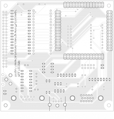

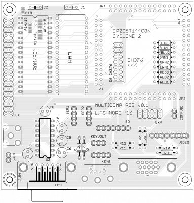

After looking at the gal programs on Daryl Rictors site and the multicomp from grant searle i thought the easiest thing for me to do was start with the multicomp design....
So, I have drawn up a board based on the multicomp cyclone 2 board from ebay.
Added 2 sockets for ram -as6c4008 and a combined rom/ram socket
Expansion bus
Multicom bits ie 2off serial . Sd card . Comp / vga video . Ps2 keyboard
Added max3232 for serial 1
And finally added a ch376 port for the usb boards from ebay.
I have some ideas for a simple MMU and other cool bits
Lee
