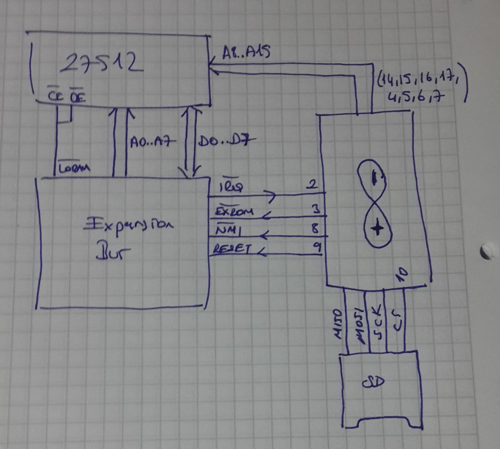

The main problem with this method is : Feeding the databus is very time sensitive so if you wanted to do other things beside booting things gets complex. Also, when you add the ram you'd need a way to orchestrate the bus since 6502 will be the outputting side on the bus (or ram, on read accesses) Also you'll need some address decoding logic for sure.
It's not evident which microcontroller is used but if it's an 16mhz atmel part then you'll definitely have problems to drive the part at 1mhz with just arduino code. (Even with assembly it might not be possible)
My take on c64 to drive the system through expansion port was of much parasitic and virus like with only 4 connections to the cpu (no databus, no address bus) with a custom rom.
Of course this cheats and uses a 256 byte on the rom for booting but otherwise it's able to load any program on the ram and invoke it. Transfer code is not very timing critical and controlling micro is free after the stuff has been transferred.
Instead of an eprom you can use a programmable logic device which has enough logic elements to build the startup code. Then you can even remove it from the system after the boot. (Since you'll already take control of the NMI and IRQ vectors)

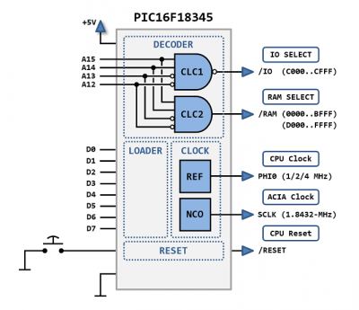

cbmeeks wrote:
@Michael
I've seen you mention the PIC a few times. I cut my teeth with the PIC but then moved to Arduino and Propeller. I love the Propeller but I sometimes wonder if the PIC might be better suited for glue logic. Especially with the programmable logic blocks.
As @Jac has proven, the Propeller can certainly emulate the RAM/ROM/IO for a 65c02, but you're pretty much capped at 1 - 1.25 MHz. Which is fine many things.
But, how fast have you clocked the 65c02 using a PIC with it running as glue logic like you show in that picture?
Somehow I missed your post and question. Forgive me.
I'm wiring up a test board for the 20-pin PIC and I'm hoping the design will support operation up to 4-MHz. I suspect the limiting factor will be the propagation delay of the CLC (configurable logic cell) address decoders (around ~50-nsecs). I'm not sure I can test it at that speed though (I only have 2-MHz VIA & ACIA chips).
Cheerful regards, Mike
