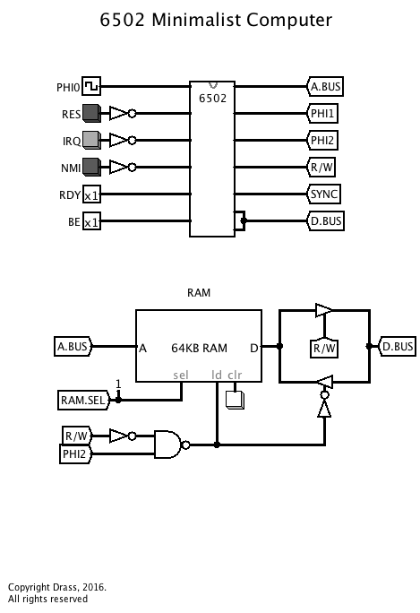

Attached is the Logisim file as well as a RAM image of Klaus Dormann's 6502 Test Suite. To make it go:
1) Load the Test Suite into the ram on the main page (Shown below)
2) Set the RDY and BE pins high
3) Start the clock (/Menu/Simulate/Ticks Enabled)
4) Hit the reset button
The test suite will start to run. Go into the "6502" sub-circuit to see all the blinking lights ... Keep an eye on RAM address $0200 to see the current test number being executed.
Bonus points if you help me find any bugs! :)

Regarding the "microcode hardware strategy", I'm not sure the Logisim file will tell you what you want to know. The file is not at all designed with presentation in mind, nor optimized for Logisim. It's sole purpose is as a working model to test the hardware - and is certainly more difficult to follow than Warren's RISC oriented CPU in the link you shared. My intention is to eventually clean this up and document it. Hope it's useful to you as is ...
For now, perhaps the following will help:
1) The microcode is vertical - that is, encoded such that it passes through decoders to generate the actual control signals.
2) There are four 8 bit microcode ROMs, two for each card in the physical CPU, forming a 32 bit micro-instruction. All the control signals required in each card are generated by decoding the ROM values local to that card. This is not particularly relevant for Logisim but helps explain why microcode is arranged in the way that it is.
3) A 4 bit "Q" state counter keeps track of the internal machine cycle. Q & Opcode together index into the ROM to fetch a micro-instruction.
4) The design is pipelined so that the fetched micro-instruction is always for the "next" cycle - there is an auxiliary micro-instruction register at each ROM to latch "special" micro-instructions
5) The sequencer is very simple, allowing only for NEXT and END directives, as well as a couple of EXIT conditions. The one subtlety is the INCDPH.C directive which handles incrementing the high-byte during indirect address calculation.
6) There are four versions of the microcode loaded into the ROMs: 6502, 6502 + undocumented opcodes, 65C02, 65C02 + select 65816 extensions. They are selected through the CMOS and +OPS switches in the internal control panel. Plain old 6502 is the default (CMOS=0, +OPS=0).
7) Decoder values for the microcode are described in the attached pdf (which may not be 100% up to date):
C74-6502 Decoder Values.pdf [201.02 KiB]
Downloaded 159 times
Feel free to hit me up with any questions.
Have fun!
Drass
