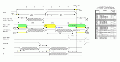

Bus timing for 65c816 is potentially more challenging than timing for 65c02. Although address lines A15-A0 have the same job as on a 6502, D7-D0 carry extra activity. As noted in the data sheet, "The Data/Bank Address Bus pins provide both the Bank Address and Data. The bank address is present during the first half of a memory cycle, and the data value is read or written during the second half of the memory cycle." I started this thread because I thought it was worth discussing the details.
First, two diagrams. Below is my own edited version of Figure 4-1 from the '816 Data Sheet (Sept 2010 version). To put all the various delays in perspective I squeezed and stretched things so that the diagram is now approximately to scale along the horizontal axis.
Assuming a 70 ns cycle (14 MHz), WYSIWYG! :) WDC's original diagram has two errors of omission; my corrections are shown in blue (I added 2 missing arrowheads and the value name tBH). Proofreaders welcome. Also, from Table 4-2, I copied in the actual delays (in ns.) that pertain to 5V operation. The clock rise & fall times have not been adjusted to scale.

It's when the bus reverses direction that there's potential for a problem. A graceful reversal demands that the CPU release the bus before the memory or transceiver on the system board commences to drive it. Likewise the system board must release the bus before the CPU commences to drive it.
With 6502, it's easy. The bus never reverses direction except when read cycles are interspersed with writes. More to the point, neither the processor nor the system board (if it's properly designed) drives the data bus during Phase 2 low.
The "dead time" during 65c02 Phase 2 low is actually extremely valuable! It acts as a timing cushion that accommodates real-world variability -- for example, the tri-state enable & disable delays of the memory or transceiver that drives the bus, the delay of the glue logic in control of that, and the timing variability of the CPU's own internal bus driver. These delays can't be exactly predicted, and vary independently of one another. The dead time will be at its most brief when the device releasing is at its slowest and the device asserting is at its fastest. But the 6502 has plenty of wiggle room. The dead time is nominally 50% of the cycle, and won't get eaten up even after a margin is subtracted for variability in logic and tri-state delays.
With the '816, it's a stickier situation. Even in the case of successive read cyles, the bus must reverse direction. But really the crucial issue is...
  • in Phase 2 low the CPU drives the Bank Address onto the data bus
  • instantly thereafter, during Phase 2 high, memory drives data on the bus
  • instantly thereafter it's back to the CPU driving the Bank Address onto the data bus
Stated another way, the dead time is zero even before a margin is subtracted for variability in logic and tri-state delays. Of course the variability might trend in your favor, creating a dead time. But it equally might trend the other way and create bus contention. I'm not aware of any really good solution for this.

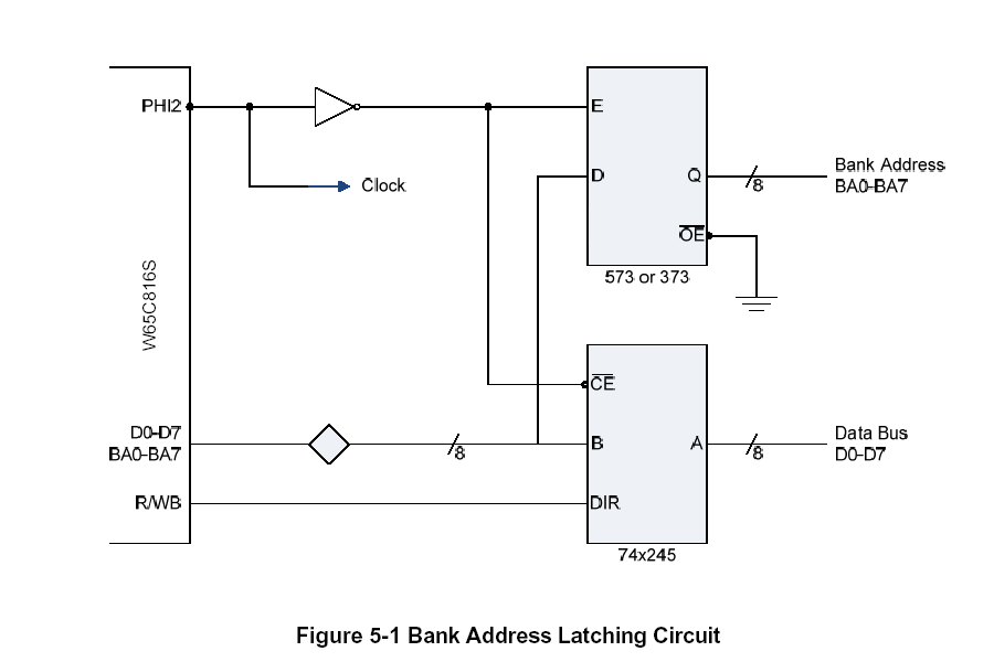

What I'd like to determine is how best to design for the '816. Here's Figure 5-1.
I'm sure this circuit has been used successfully many times, but it's somewhat vague. Is it safe to assume that, for the "74x245" bus transceiver, we can use anything from a 74LS245 to a 74BCT245? What if it's a CPLD or some other device that connects to D7-D0? How do we ensure that the bus enable and bus inhibit times are appropriate for avoiding bus collisions with the '816? Here's what we have to go on:

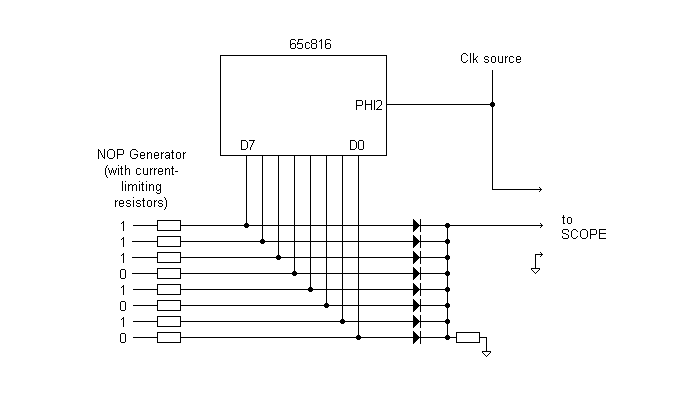

I've had the ambition to experiment with delay lines [...] and watch the current (indicating bus contention) and see where the whole thing would run the fastest. [...] I never have done that though.
That's on my list of "someday" projects, too. <sigh> :roll:
There would be other timings that could be experimented with similarly.
Yes, including the duty cycle on Phi2.

On my SBC-3 & 4, I used a CPLD to manage the latching of the bank address. This was a simple latch, equivalent to the 74573. It was transparent during PHI2 low, and latched when PHI2 was high. I didn't bother with any delays or shifting of PHI2. This worked flawlessly up to and beyond 14MHz as long as my bus loading was light. With more devices on the bus, lower speeds (8-12MHZ) worked well. My CPLD's were typically 15ns Xilinx 95108's.
As far as managing the databus, the tri-state buffers used in the CPLD also used PHI2 & R/W in addition to the address decoding logic to select the CPU, Memory, or IO as needed. No special attention to the PHI2 edges were needed.

Iif the R/W logic has been correctly implemented, that is, fully qualified by Ø2, the addressed device (memory or I/O) will get off the bus as soon as Ø2 falls, subject of course, to the device's response time to read-enable or write-enable transitions. For example, the SRAM that I used in POC V1 has the following read cycle timing spec:
OE to High-Z Output:  6ns
The SRAM will get off the data bus no more than 6ns after /OE is deasserted, leaving 16ns (at 14 MHz) for the SRAM to read or write data. In my design, /OE can only be asserted when RWB is high and Ø2 is high. /CE cannot be asserted unless VDA and/or VPA are asserted, so no access is possible during invalid cycles. These general rules are applied to all devices, whether RAM, ROM or I/O.
The fact that the '816 doesn't actually sample (read) or drive (write) D0-D7 until very late during Ø2, and continues to do so for some time after the fall of Ø2 gives the addressed device ample time to get ready for the access, provided the device is selected as soon as a valid address is presented on the bus (i.e., when VDA and/or VPA are asserted). I've been able to bring up POC V1 on a 15 MHz clock addressing only RAM, and that is with 74AC logic. With I/O functioning, 12.5 MHz operation is reliable. This tends to indicate that the '816's timing is manageable if the glue logic is correct. The key is in correct utilization of VDA and VPA, as well as not asserting any /OE or /WE device inputs unless Ø2 is high. As soon as VDA and/or VPA are asserted my glue logic will assert /CE on the addressed device. This will occur at no more than 30ns after the fall of Ø2 in a valid memory cycle.
As for latching the bank address, yes the timing is tight and realistically, clocking the '816 at 20 MHz is not practical unless the bank latching hardware is very fast, e.g., a 10ns or better PLD. Although I haven't actually implemented it, my timing analysis tells me that 74ABT devices could do it. A 74ABT573 has a typical prop delay at 25° C of 2.7-2.8ns, well within the tBH spec (10ns at 14 MHz), which means the '573 will easily latch the bank well before it vanishes from the bus. Similarly, the 74ABT245 bus transceiver has a prop time of 3-4ns, going from high-Z to active or active to high-Z. Again, this more than satisfies the bank address timing, during which the transceiver must be high-Z to prevent bus contention (prop time itself is 2.9ns worst case at 25° C).
In POC V2, I plan to use an Atmel 1508AS CPLD, which has a pin-to-pin prop time of 10ns. As the device has a lot of macrocells, I can avoid pin nodes for my buried logic, so the 10ns prop time will apply only to input to output conditions. Again, this gives me enough elbow room to handle a 20 MHz Ø2 clock.

What else did you test besides tBH? Is this diagram a reasonable representation of what you used? (I like simple tests.)
65816 test1.gif (4.9 KiB) Viewed 28113 times
