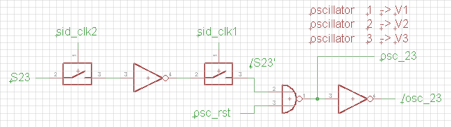

Generation of osc_rst drawn a bit different:
Generation of osc_rst, this time with logic gates:
V3 is bit 23 from oscillator 3 latch which goes into
osc_rst generation of oscillator 1:
I now feel a need to mention that the inverters I did draw at the outputs
of the oscillator odd bit latches actually are located at the north east
corner of an oscillator adder cell, decided to draw it this way
because IMHO this is helpful to understand the adder from the
logic design point of view.
This means that the oscillator is reset when test bit is set or when sync bit is set
and the sync source voice's MSB switches from low to high.
Exactly like that.

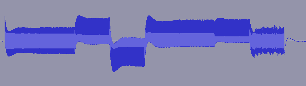

Did a sampling of the output of both chips for every possible waveform. Selecting the noise along with other type of waves produces no output so the pictures show only the following combinations:
  1. Triangle
  2. Sawtooth
  3. Triangle+Sawtooth
  4. Pulse
  5. Triangle+Pulse
  6. Sawtooth+Pulse
  7. Triangle+Sawtooth+Pulse
  8. Noise
6581:
8580:
There is no substantial difference in the amplitude between Triangle and Sawtooth in the 8580. It is interesting to note however that combinations which include both Sawtooth and Triangle are much louder in the newer model and that there is a small DC drift when passing from wave 5 to 6 in the 6581.
In other news I've fitted the transistor list into the perfect6502 emulation engine and the results look good, confirming the validity of the work done so far :). There is only one of the three voices implemented and the emulation covers only the digital behaviour of transistors. If anyone want to have a look the code is available in the libsidplayfp repository (https://sourceforge.net/p/sidplay-resid ... rfect6581/)

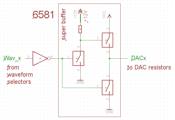

Now for the DAC buffer:
It's a _digital_ non_inverting buffer,
built from a normal inverting buffer and an inverting super buffer.
Means, we could assume that the buffer gives out either nearly 0V, or nearly 5V.
"Nearly" depends on the on_resistance of the FETs at the output and the output current.
For the input, I think we could assume a treshold between 0.8V..2.0V,
where "treshold" is the turning point between low and high.

The Pulse line which is switched to the DAC buffer inputs in pulse width mode
has a push/pull output, while everything else that could be switched to the
DAC buffer inputs just has a pullup plus an open drain FET switching to GND as an output.
Means, on the 6581, it might be possible that if the "Sawtooth" and "Pulse"
selector switches are closed, the Pulse line might probably override the output
of the osc_23 flipflop... causing _really_ odd effects.
BTW: in the 6581 and the 8580, the noise selector switches really connect to
the LFSR bits 0,2,5,9,11,14,18,20 in the same order. Checked this...
