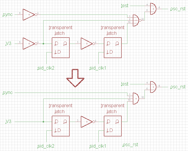

Generation of osc_rst drawn a bit different:
Generation of osc_rst, this time with logic gates:
V3 is bit 23 from oscillator 3 latch which goes into
osc_rst generation of oscillator 1:
I now feel a need to mention that the inverters I did draw at the outputs
of the oscillator odd bit latches actually are located at the north east
corner of an oscillator adder cell, decided to draw it this way
because IMHO this is helpful to understand the adder from the
logic design point of view.
This means that the oscillator is reset when test bit is set or when sync bit is set
and the sync source voice's MSB switches from low to high.
Exactly like that.

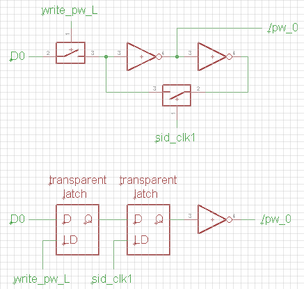

Now to take a look at the pulse width stuff.
Pulse with latches, even bits:

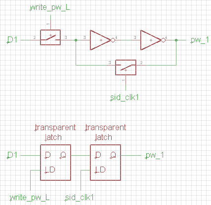

Pulse with latches, odd bits:

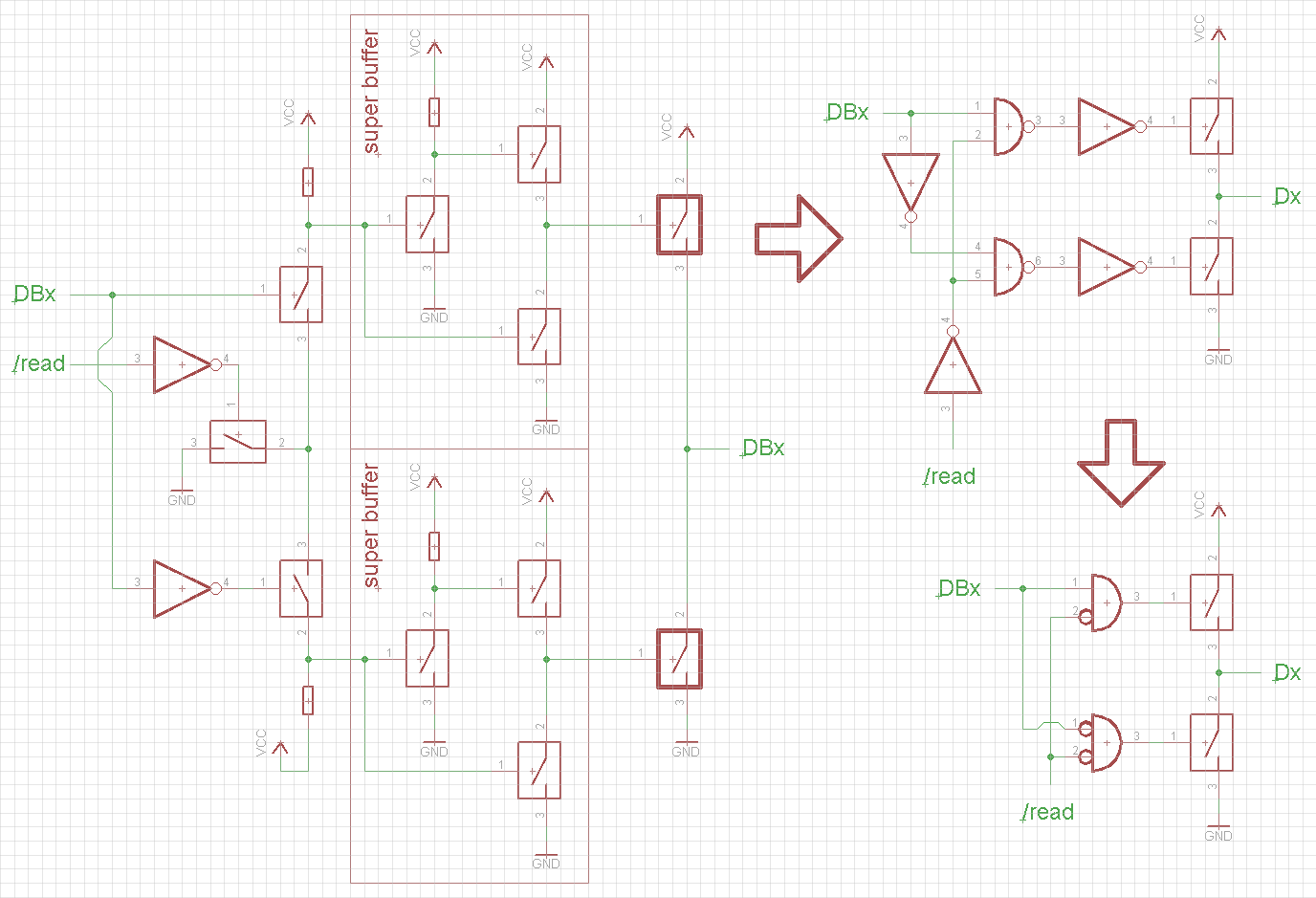

Buffer from internal data bus DBx to external data bus Dx for reading registers:

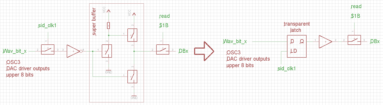

The register which reads the upper 8 Bits of the Osc 3 DAC output:

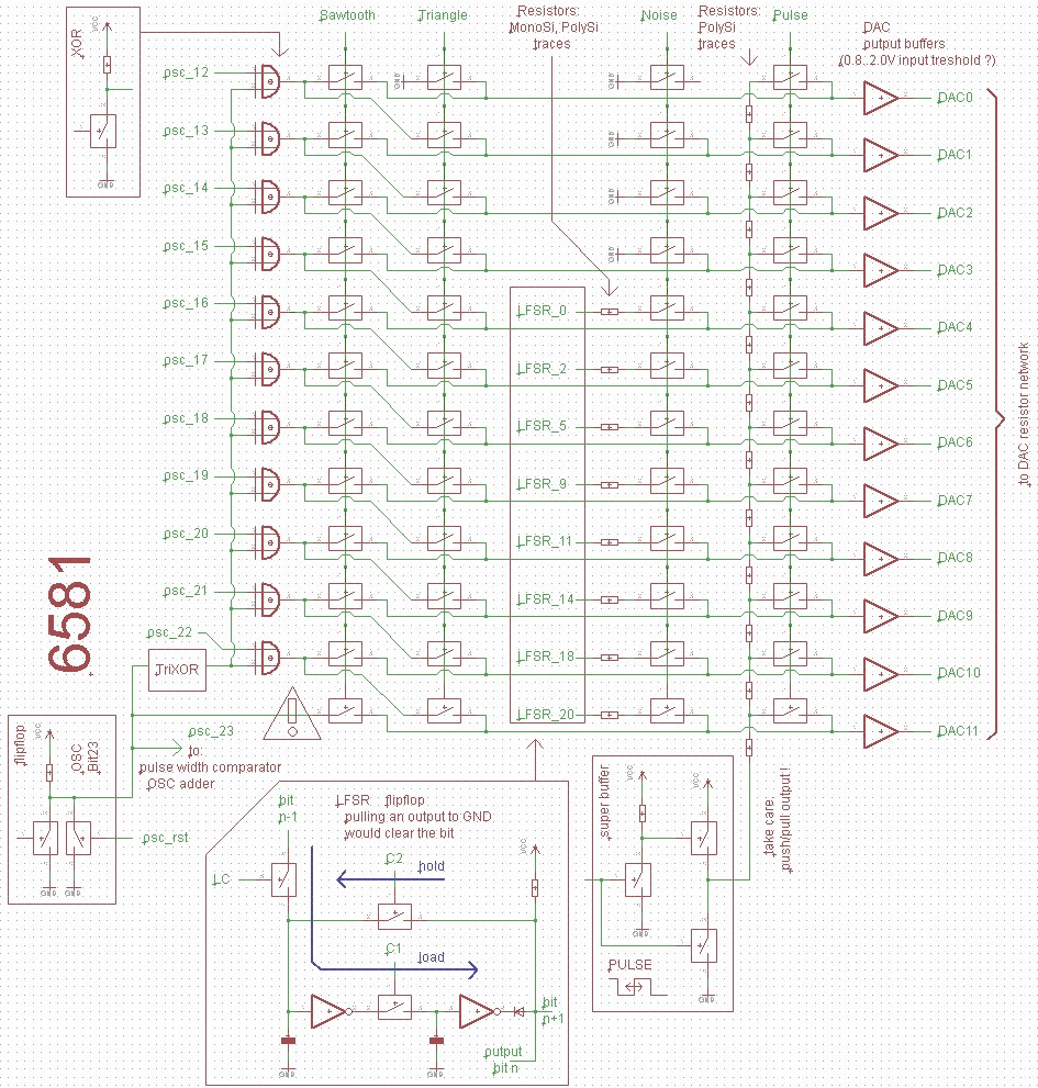

Now for the DAC buffer:
It's a _digital_ non_inverting buffer,
built from a normal inverting buffer and an inverting super buffer.
Means, we could assume that the buffer gives out either nearly 0V, or nearly 5V.
"Nearly" depends on the on_resistance of the FETs at the output and the output current.
For the input, I think we could assume a treshold between 0.8V..2.0V,
where "treshold" is the turning point between low and high.
Waveform selectors:
Evil. Eeevil...
In the 8580, osc_23 is buffered by a flipflop before it enters that "Sawtooth" switch.
In the 6581, it is not.
The Pulse line which is switched to the DAC buffer inputs in pulse width mode
has a push/pull output, while everything else that could be switched to the
DAC buffer inputs just has a pullup plus an open drain FET switching to GND as an output.
Means, on the 6581, it might be possible that if the "Sawtooth" and "Pulse"
selector switches are closed, the Pulse line might probably override the output
of the osc_23 flipflop... causing _really_ odd effects.
BTW: in the 6581 and the 8580, the noise selector switches really connect to
the LFSR bits 0,2,5,9,11,14,18,20 in the same order. Checked this...
drfiemost
Posts: 53
Joined: 07 Jun 2016
Re: Understanding the SID
Post by drfiemost »
One of those nasty side effects is that if the pulse is pulling the output low it will force a zero in the oscillator's adder MSB even if the bit is high, thus resetting the top bit in the following cycle.
