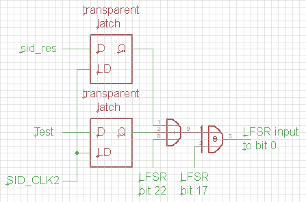

SID_CLKx generation, again another try.
SID_CLKx generation drawn more simple:
SID reset:
Edit, Edit2: fixed some errors... I think.

LFSR clock looks much better now.
But the schematics implicate, that only one '1' bit is shifted into the LFSR during a reset.
That's part of the mystery I'd like to see through. By empirical observations, sampling the eight outputs readable from the osc3 SID register, it happens that after some time (in the order of 15 to 30 milliseconds on a warm chip) the bits goes high in an orderly fashion, from lower bit to higher (with some exceptions) on 6581 and from the middle to the outside on the 8580. So it seems there is some analog magic going on here... or maybe it has to do with the OSC3 register?
By the way, to end up the noise generator here is the XOR feedback:
The output results from the following expression:
bit0 = ¬((ns17 ∧ a) ∨ b) = ¬(ns17 ∧ a) ∧ ¬b
where:
a = (sid_rst_clk2 ∨ test_clk2 ∨ ns22)
b = ¬(ns17 ∨ a)
resulting in:
bit0 = ¬(ns17 ∧ a) ∧ (ns17 ∨ a) = ns17 ⊕ A = ns17 ⊕ (sid_rst_clk2 ∨ test_clk2 ∨ ns22)
ttlworks

The remaining LFSR mysteries...
Putting that three_input OR gate in front of the XOR gate which feeds the LFSR input
certainly won't do for properly initializing the LFSR.
The OR gate would have to be placed between the XOR gate output and the LFSR input,
but I think this would have required a little bit more space on the silicon.
Of course, "the professional approach" would have been to implement a 23 input
NOR gate to force the LFSR input to 1 if all the LFSR flipflops are 0,
but there certainly wasn't enough space on the silicon for something like that.
So in my opinion, whoever did the logic design for the SID was well aware
that the LFSR bits would be turning from 0 to 1 after a while...
Edit: more than two months had passed by since writing this post.
My theory of a "hidden P FET" turned out to be pure nonsense, so I deleted it.
But we still have no clue, what brings the LFSR bits back to '1'
after they were '0' for some time.
1) There is nothing in the transistor level logic design that could explain this effect.
2) When comparing 6581 and 8580, bits seem to go '1' in different order.
// Connections between LFSR and wave selector are wired up identical for both chips, checked this.
3) Effect depends on chip and on temperature.
4) There is nothing "suspicious" in the pictures of the 6581 and 8580 silicon.
Whatever it is, it probably is a trick hidden in the manufacturing process of the silicon or such.
With the info and the skills we have now, we can't solve this riddle.
