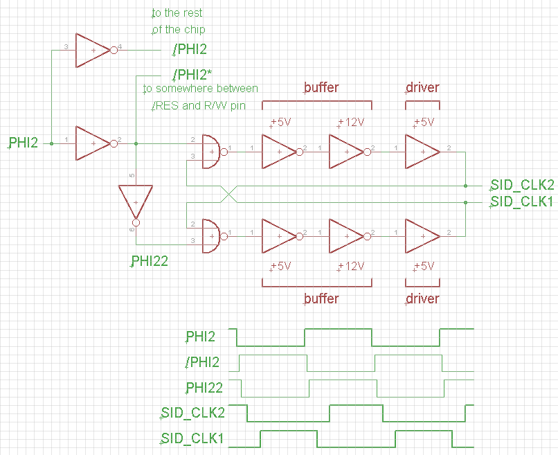

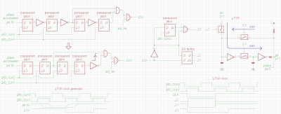

SID_CLKx generation, again another try.

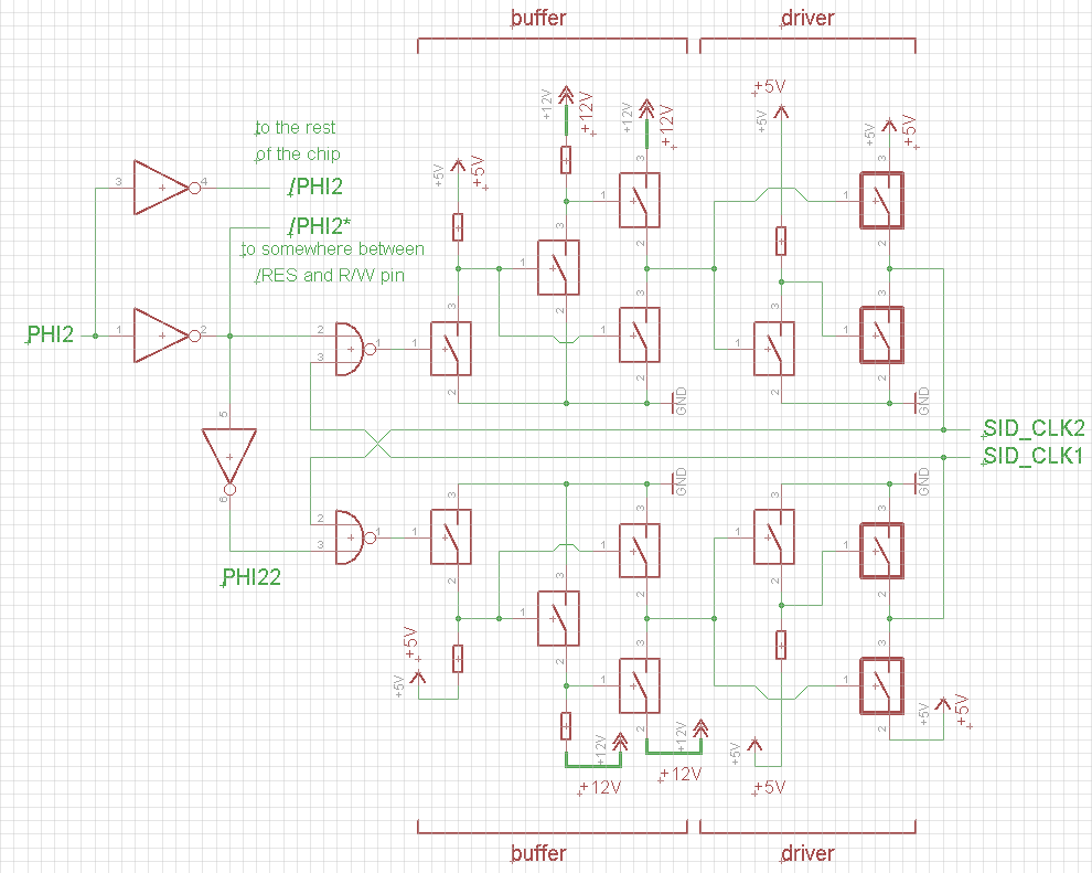

SID_CLKx generation drawn more simple:

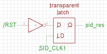

SID reset:
Edit, Edit2: fixed some errors... I think.

In the LFSR clock generator which generates C1,C2,LC from clk,
"Phi2" seems to be SID_CLK2 instead.
The clk generator...
you rotated the screenshot from the chip counter_clockwise by 90 deg, _did_ you ?... :mrgreen:

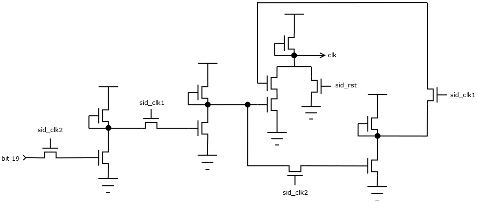

Switch for bit 19 seems to be controlled by SID_CLK2 instead of "Phi2".
The next switch seems to be controlled by SID_CLK1 instead of "Reset".
This makes the left half of your transistor level schematic a master_slave flipflop which stores bit 19
for delaying it one clock cycle.
The delayed bit 19 signal (phase accumulator) from the flipflop then goes through
another switch controlled by SID_CLK2 instead of "Phi2", then goes through that inverter,
followed by another switch before entering that AND gate...
was not able to figure out where the control signal for that switch comes from,
but it probably ain't Phi2 again...
BTW: that AND gate still seems to be an edge detector for the delayed bit 19.
The /Reset input of the NOR gate which generates clk actually seems to be sid_rst,
which is HIGH (synchronized by SID_CLK1 indeed) when the /RES pin of the chip is LOW\ACTICE,
forcing clk to LOW during a reset.
For figuring out _why_ clk seems to be low during a reset,
we need to dig a bit deeper into the LFSR clock generator and the LFSR flipflops again, sorry.
PostPosted: Thu Jun 16, 2016 9:19 pm
Joined: Tue Jun 07, 2016 4:34 pm
Posts: 53
Yes, I tried to better fit the images :oops:

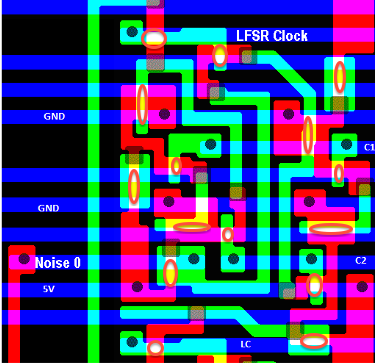

This is the schematic with the correct signals, the lines in the reference layout were misleading:
Well, this matches with the fact that clk is grounded when the test bit is high, as both should reset the LFSR.

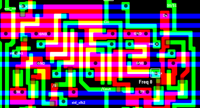

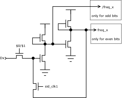

Let's have a look at how the other waveforms are generated. It all begins with a 24 bit phase accumulationg oscillator, described previously by ttlworks.
Here is one of the bits, the Frequency register on the right and a ripple-carry adder on the left. Even bits have inverted logic to save some silicon and speed up the carry chain.
The freq register bits are formed by a couple of inverters where the feedback loop is clocked by sid_clk1.
The input is taken from the data bus for the lower 16 bits while upper 8 bits are grounded. The input is enabled by the $0 line for the low eight bits and $1 for the others.
The $0 and $1 lines come from the address bus and I suppose these are enabled at sid_clk2, we'll have a look at this later.

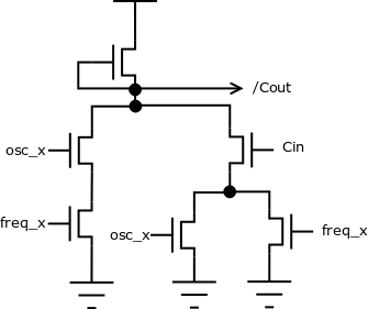

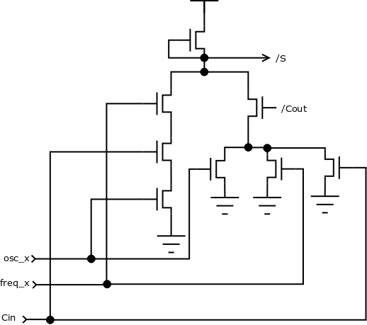

Then there is a ripple-carry adder which performs the summing of the oscillator value and the freq register.
This is the circuit that calculates the inverted sum:
And this one calculates the inverted carry:
resulting in the following expressions:
/S = ¬((osc_x ∧ freq_x ∧ Cin) ∨ (/Cout ∧ (osc_x ∨ freq_x ∨ Cin))
/Cout = ¬((osc_x ∧ freq_x) ∨ (Cin ∧ (osc_x ∨ freq_x)))
which I haven't been able to simplify, but the truth table confirms that it works as expected:

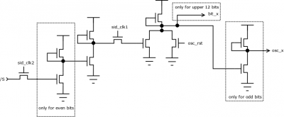

The resulting sum is latched (inverted for odd bits) at sid_clk2 and then NORed with the osc_rst signal at sid_clk1 producing the output. So when osc_rst is high the oscillator is reset to zero.
The output is sent back to the adder, after passing through an inverter for odd bits. The output of the upper 12 bits is then used for the actual waveform generation.

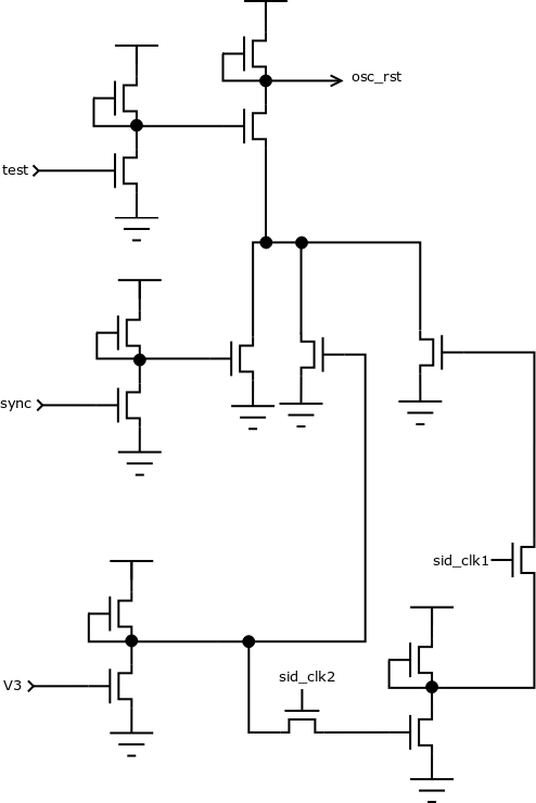

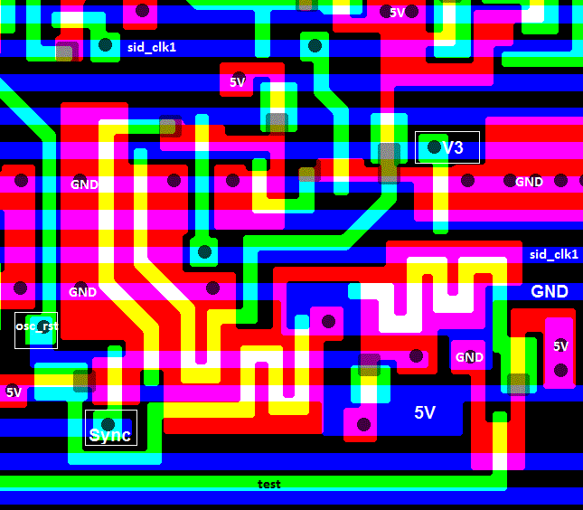

The osc_rst line is controlled by the following circuit:
giving the following expression:
osc_rst = ¬(¬test ∧ (¬sync ∨ ¬V3 ∨ V3_prev))
= test ∨ ¬(¬sync ∨ ¬V3 ∨ V3_prev)
= test ∨ (sync ∧ V3 ∧ ¬V3_prev)
where V3 is the MSB of the preceeding voice generator and V3_prev is the value of V3 during the previous clock cycle.
This means that the oscillator is reset when test bit is set or when sync bit is set and the sync source voice's MSB switches from low to high.

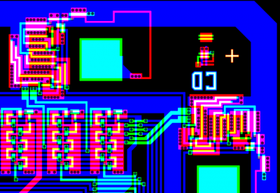

In my opinion it would be a good idea to aim at the address decoder now
to figure out which SID register is where on the silicon.
(Orientation: filter section is South.)
North above the LFSR\Oscillator blocks,
we have 29 six_input NOR gates tied to inverted\non_inverted Bits
of the internal address bus, I think that's the read/write decoder
for the 29 registers.
Picture shows the North East corner of the chip,
two address "pins" and three of the NOR gates.

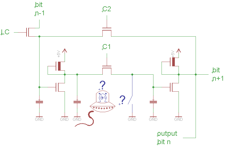

PostPosted: Mon Jun 27, 2016 8:08 am
Posts: 1431
The remaining LFSR mysteries...
Putting that three_input OR gate in front of the XOR gate which feeds the LFSR input
certainly won't do for properly initializing the LFSR.
The OR gate would have to be placed between the XOR gate output and the LFSR input,
but I think this would have required a little bit more space on the silicon.
Of course, "the professional approach" would have been to implement a 23 input
NOR gate to force the LFSR input to 1 if all the LFSR flipflops are 0,
but there certainly wasn't enough space on the silicon for something like that.
So in my opinion, whoever did the logic design for the SID was well aware
that the LFSR bits would be turning from 0 to 1 after a while...
Edit: more than two months had passed by since writing this post.
My theory of a "hidden P FET" turned out to be pure nonsense, so I deleted it.
But we still have no clue, what brings the LFSR bits back to '1'
after they were '0' for some time.
1) There is nothing in the transistor level logic design that could explain this effect.
2) When comparing 6581 and 8580, bits seem to go '1' in different order.
// Connections between LFSR and wave selector are wired up identical for both chips, checked this.
3) Effect depends on chip and on temperature.
4) There is nothing "suspicious" in the pictures of the 6581 and 8580 silicon.
Whatever it is, it probably is a trick hidden in the manufacturing process of the silicon or such.
With the info and the skills we have now, we can't solve this riddle.

PostPosted: Mon Jun 27, 2016 11:38 am
Here's an annotated version...
