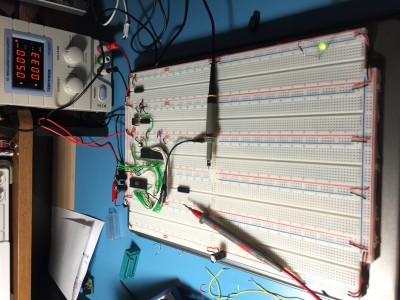

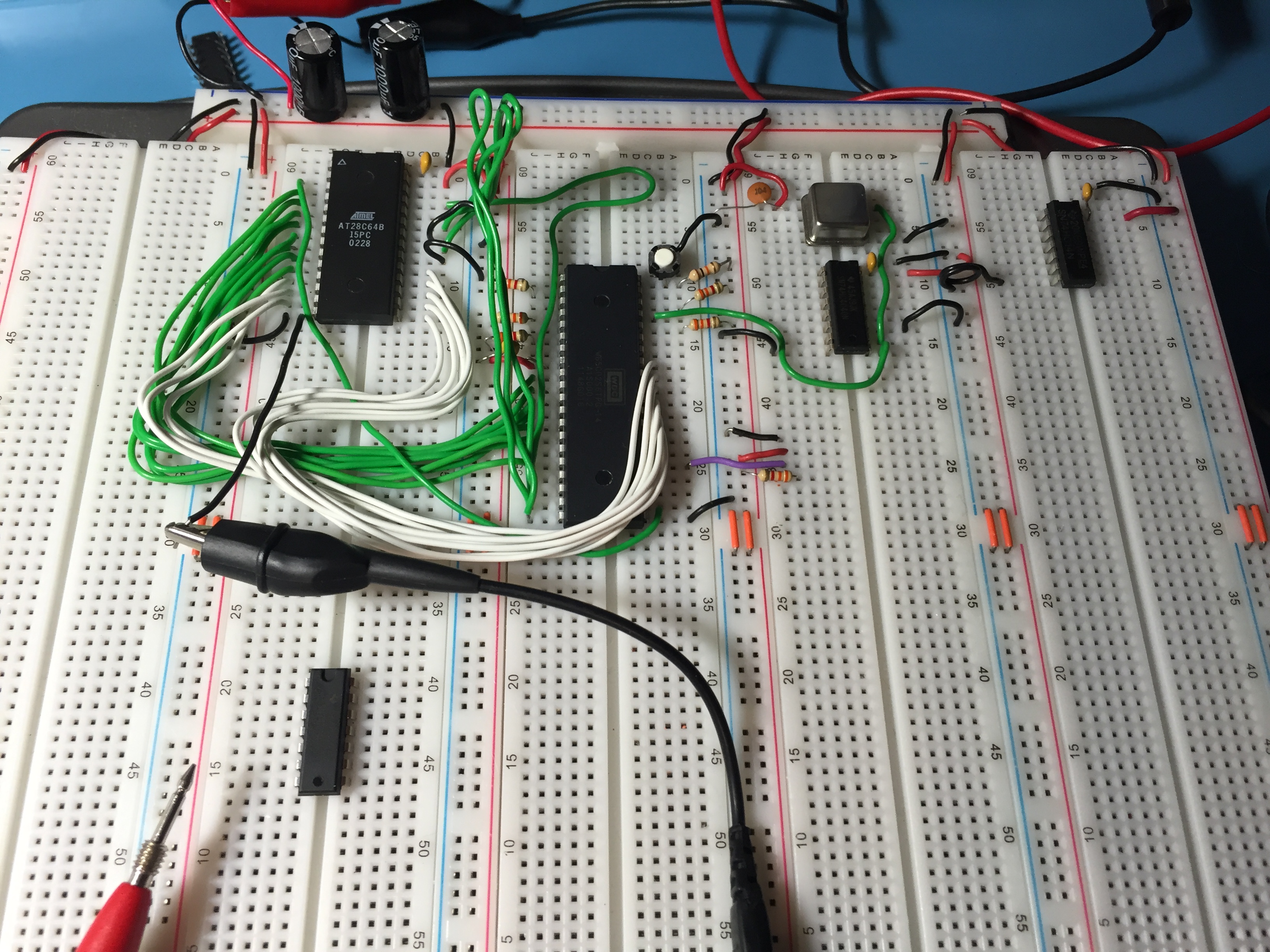

Another update.
Some success! I pulled the ACIA out and now have the CPU and ROM.
Here is my code:
          .org $1000
loop:     lda #$AA
          jmp loop

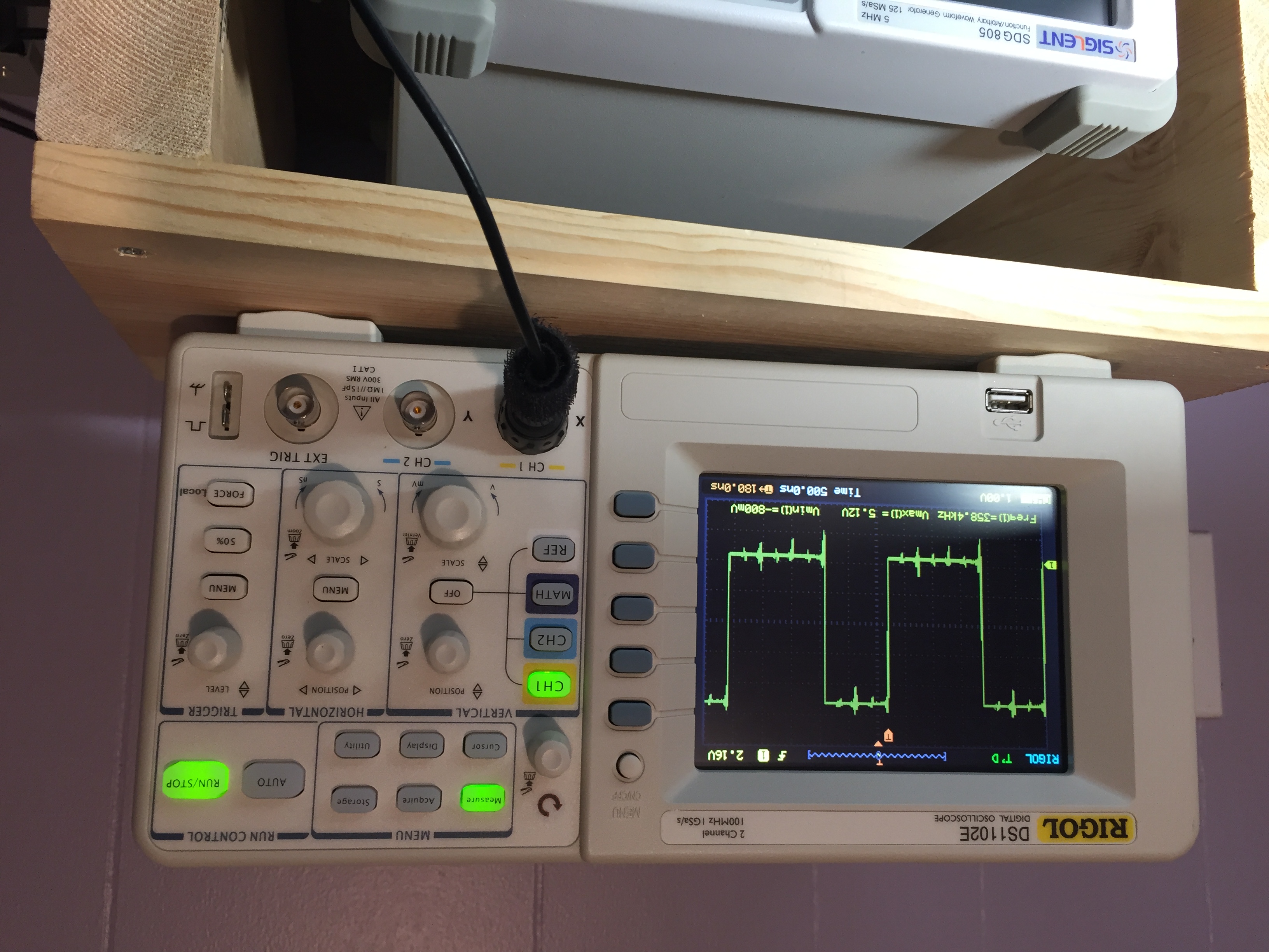

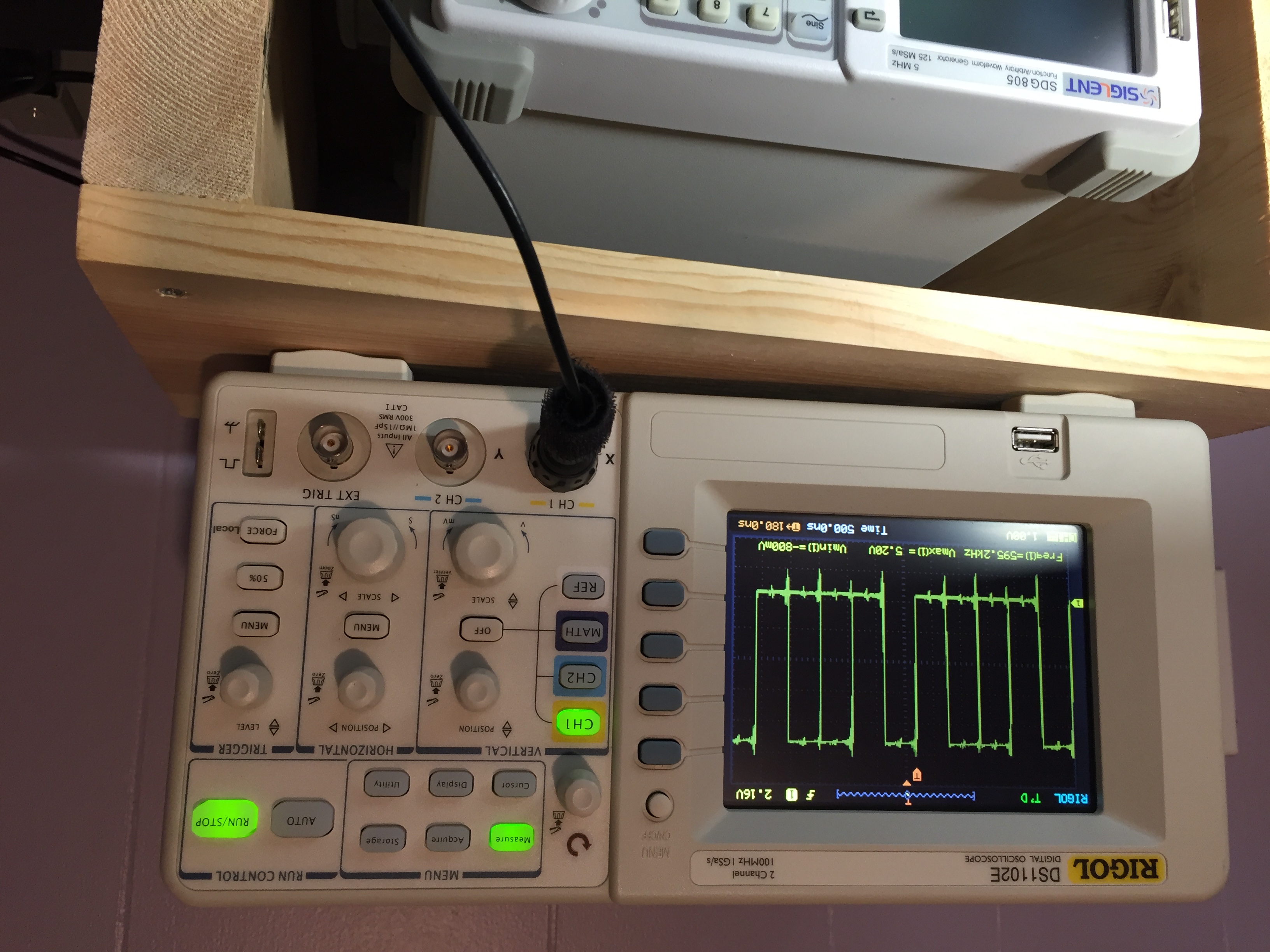

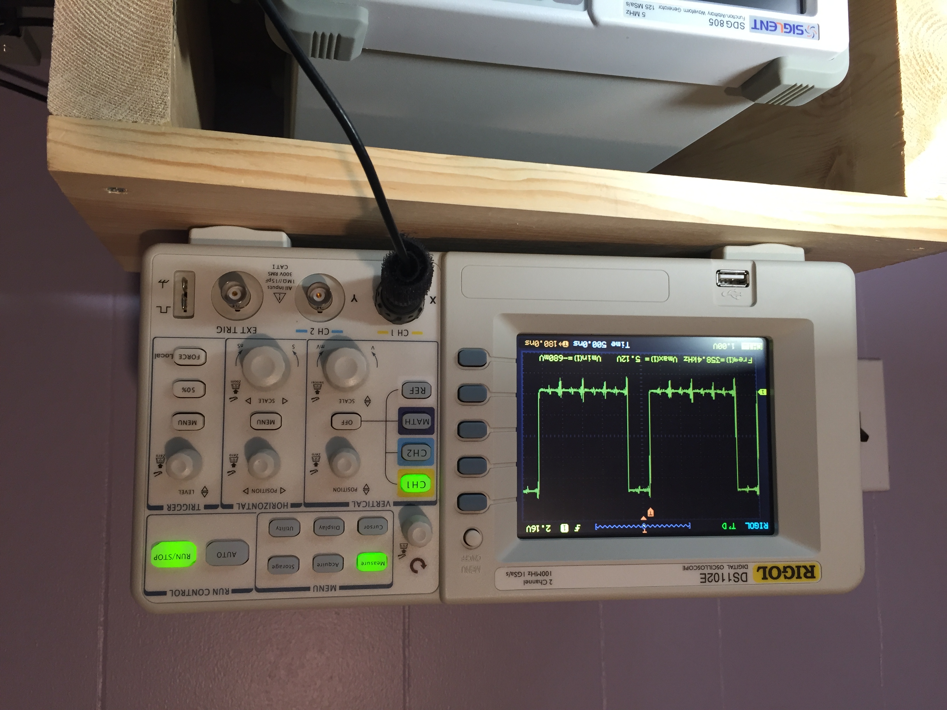

My scope shows:
A15 to A13 LOW
A12 HIGH
A11 to A3 LOW
A2 about 20% HIGH and 80% LOW
A1 - not sure of % but a little less than 50%
A0 about 50% HIGH/LOW
So it appears to be running my code and jumping to $1000 forever.
** EDIT **
Added some pics. Not sure why preview has them upside down but opening them up is fine.
File comment: A2
