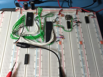

I maybe ended up in a similar situation with my breadboard design. I built up a complete system and it didn't work and I couldn't really figure out why. The mistake was having too much complexity to debug all at once. I needed to isolate parts to reduce the complexity. In the end there were very few things wrong, but it was just a problem of identifying exactly what was wrong. Also I wasn't confident in my test equipment and got some results that I couldn't explain with the scope. I've got a logic-8 that my dog converted into a logic-4 by eating half the wires and that proved to be quite helpful.
Adding a DS1813 I think will be helpful, one of my problems was not having a clean reset, it's good to know that your system will start reliably. Anything you can do to reduce randomness is very helpful. On my breadboard I've got no bypass capacitors and the clock looks very messy and it all still works reliably. I'm running at 1.8 MHz and my ACIA is reliably working at 115,200 which I think is a good result.
Next I'd try the NOP or JMP type test and look at the address bus to make sure that it makes sense. This will confirm that the CPU is working correctly. I think you've already done this.
Then I'd try a very simple program. You don't need to replace the ACIA with a VIA to get a LED blinking, you can use some of the serial control lines just like GPIO pins. I haven't done this myself but is shouldn't be hard. Try writing code that does not rely on the RAM at all so you can isolate this from the test. That means no stack or zero page usage, but to blink an LED that shouldn't be a problem. This will confirm that your CPU, ROM, ACIA and address decoding are working. Look at the select lines to confirm that the ACIA is getting accessed in a pattern that makes sense. Disable interrupts at the start of this code just to eliminate that as a possible problem. I kind of skipped this step by going straight to a test using a character LCD, but it was a similar process. Once I had output to the LCD I could perform much more testing. The LCD connects directly to the address bus so is quite simple to get going. I actually wired up the LCD on a breadboard and hand toggled the lines to ensure that my understanding of the steps to print a character worked. You can set the data bus values then toggle the E line to write a value, it's not that hard to display text by hand, then you can just take those steps and write the equivalent code as a test.
Then you can move on to a simple serial test, like sending a character. This will confirm that you have the baud rate correct and the ACIA is working, and you can move on from there adding more functionality. It's really useful to have some way of debugging the code, I'd sometimes run some new code and get nothing, and have no idea where it failed. When that happened I printed characters to the display to show where the code was up to, you could do the same with the serial port. You could write a RAM test, I didn't do this as I tried some code that used the RAM and it worked, so that was good enough for me.

Unfortunately, I literally only got about 10 minutes to fiddle with it last night (the circuit that is!!). I hope to have more time tonight. I started drawing up some real schematics on what I have *AND* what I hope to build.
Last night, I connected a 1M ohm resistor between pins 6 and 7 of the ACIA and left the 22pf cap on pin 6 to GND. Still nothing.
What's interesting, however, is that when I press my mechanical reset button, I can see the TX light briefly but nothing comes over. BUT, when I power down the circuit, I get a few characters of garbage on my terminal. It's funny, actually. Because I have so many large caps all over the place, I can watch the signals on my scope slowly flat line 4-5 seconds after there is no power! HA! Those caps are powering the circuit for a few seconds with no external power. lol

I have wired up a proper reset circuit, confirmed that the ACIA is getting a 1.8xxxMHz clock, and put a 1M Ohm resistor between 6/7.
The LOT ID for the ACIA is A6A749.1. Wouldn't you know it.
I'm going to rip the ACIA out and focus on my ROM. Once that works, I will try a VIA and then tackle the ACIA again.
Thanks for all the help!

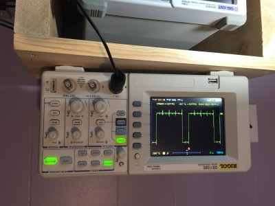

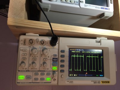

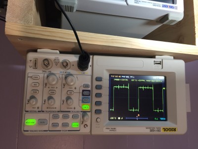

Another update.
Some success! I pulled the ACIA out and now have the CPU and ROM.
Here is my code:
          .org $1000
loop:     lda #$AA
          jmp loop
My scope shows:
A15 to A13 LOW
A12 HIGH
A11 to A3 LOW
A2 about 20% HIGH and 80% LOW
A1 - not sure of % but a little less than 50%
A0 about 50% HIGH/LOW
So it appears to be running my code and jumping to $1000 forever.
** EDIT **
Added some pics. Not sure why preview has them upside down but opening them up is fine.
File comment: A2
