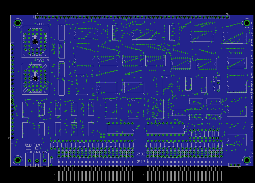

Getting closer ... Still some tricky routing on the lower left to be done, but I think I can see the finish line!
I've managed to keep most critical clock signals on the top layer but the clock going to the 6510 port is still moving around a bit too much for my liking. I'll try to go after it at the next opportunity. I'm also going to replace the individual series resistors with 16 pin sockets to make things a little more manageable. Don't really have the room right now, so that will take some work. Probably will have to wait until next weekend ...

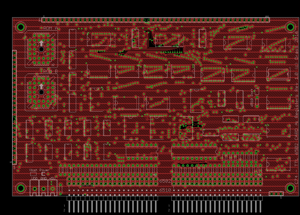

The ground plane remains intact (save for the vias, of course), but as mentioned, I am using the VCC plane to put some traces down - mostly just short bridges to get out of a jam. Hoping that's not going to hurt things too much. Here is what that looks like:

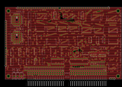

A milestone worth reporting ... 1st pass of the routing on the Registers Card complete :!: :!:
Well, almost ... I have yet to replace the series resistors with sockets. I created new packages for the through-hole ICs with octagon pads to give me a little more room. I think with some fancy footwork, I just might be able to get those sockets to fit. But it's not essential. The board is all wired up as it is so it's a good point to share. I'll sleep on the resistor sockets and may take another crack at it. In the meantime, here are some pics:
Top and Bottom:

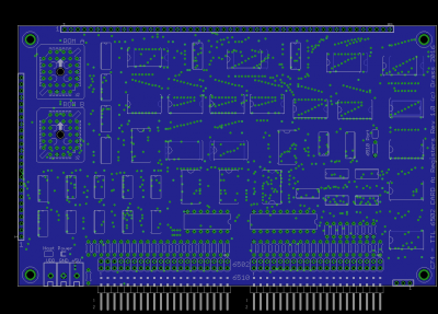

GND plane:
I'm very happy with how this turned out. The VCC place is a little cut up, but there are lots of bypass capacitors on the board so it should all work out well.
I'm going to take a hard look at it all and review it carefully but please let me know if anything obvious jumps out.

PostPosted: Sun Mar 13, 2016 6:11 am
It's not a big deal. The VCC doesn't really need a plane, as a bit of inductance between the power supply and the bypass cap only helps to filter the signal. As long as you have bypass caps close to the IC, and sufficiently wide traces leading to the cap (to avoid DC voltage drops), you should be okay.
The extra capacitance between the VCC and GND planes is too small to be useful, unless you a) work with really high frequencies (hundreds of megahertz), and b) take extra care (and pay extra money) to manufacture the board with minimal separation between the two layers.
