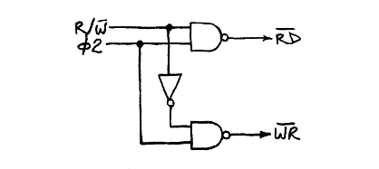

Beyond the address decoding, you do have to add this, right?
So it's probably not free (unless it's in programmable logic). As for trying to get extra setup time for the RAM though, tADS becomes almost the entire phase-2-low time as the processor approaches its maximum speed (according to the questionable data sheet), so "doing it right" does not bring any advantage unless the RAM is really slow and it's running out of gas while the processor still has considerable margin. For my SRAM module nowadays, I'm buying 512KB 10ns SRAMs for 1/16th what I paid for my first 8KB 120ns SRAMs in 1985 from Jameco. Adjusted for inflation, I paid over two thousand times as much per bit as I'm paying today, even though today's is 12 times as fast.
I was forgetting earlier that he was talking not about the '02, but about the '816 which puts the bank address on the data bus during the phase-2-low time. It shouldn't cause any contention though, as the '245 is disabled during this time.

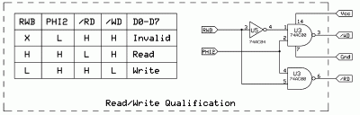

Although I haven't investigated it, it seems to me that a bus transceiver on D0-D7 is only necessary if loading dictates that more drive be made available. If used, then it can be gated so that isolates both sides of D0-D7 when Ø2 is low.
The reason I am surmising that is that 65xx peripherals do not emit data during a read cycle until tCDR nanoseconds after the rise of Ø2. Hence they will not cause bus contention with the 65C816 during Ø2 low. Non-65xx devices can have their /OE and /WE inputs gated by Ø2, which again deals with the bus contention issue.
File comment: Non-65xx Read/Write Qualification
EDIT: Fixed improper data sheet reference.
Good point. The little logic network you posted can be eliminated in some cases if we're willing to sacrifice the early CS -- I hadn't thought of that. It means cases of "free" early CS are less common than I thought (but the questions as stated remain valid).
FWIW, sometimes the little logic network is free. A ROM doesn't require /WR, only /OE, and the latter can be driven from /Ø2 if you have it (or just use PHI1O). Another case where the little logic network is "free" (no extra cost) is systems that use non-65xx peripherals -- they're gonna require /RD and /WR anyway. (Hmm, alright, I guess there are tiny costs. Example- running the PCB traces... )
PostPosted: Sat Dec 05, 2015 7:15 pm
65xx peripherals do not emit data during a read cycle until tDCW nanoseconds before the fall of Ø2.
tDCW is a spec associated with write timing. Do you mean tCDR? That is measured from the rise of Ø2.
I agree a bus transceiver on D0-D7 may be dispensible in some cases.
Oops! :oops: I misread the data sheet. tCDR is correct and yes, it is measured as you describe. I had that part of the data sheet magnified and must've inadvertently scrolled up. :oops: It doesn't help any that I am (again) having vision troubles that were supposedly corrected via surgery two years ago. :(
I agree bus a transceiver on D0-D7 may be dispensible in some cases.
