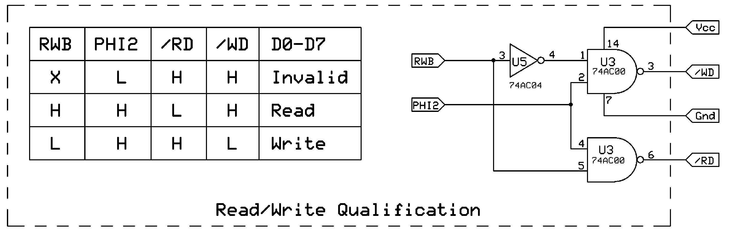

Be sure to heed Arlet's advice about not using the Ø2 clock as part of the decoding logic, essential with 65xx devices, such as the 65C22 and 65C51, which must be selected before the rise of the clock. Also, as Arlet advised, use Ø2 to qualify read/write accesses. This is especially important on writes, as the data bus may contain random content during Ø2 low. See below.
File comment: Non-65xx Device Read/Write Qualification Example
Note that Ø2 qualification of read/write accesses applies only to non-65xx devices. 65xx devices should have their RWB inputs directly connected to the microprocessor's RWB output.
and, more importantly, the address is not guaranteed to be valid and stable before the R/W\ line goes down, so you could write to unintended RAM addresses, corrupting things. We have had a couple of members get bit by this in past years. The data will be correct enough time before the end of the cycle though.
This is one of those chicken-or-egg things, depending on how one reads the timing diagram. Either way, read/write should always be qualified by Ø2 to eliminate any danger of corruption.

bUt I just read the sentence "You must have a way of making sure microprocessor cannot write to RAM while Phi2 is low" and now I must read that section again!
That dictum also applies to non-65xx I/O hardware. See above for an example of how to generate read/write signals qualified by Ø2.
