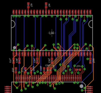

I've got SDRAM attached to FPGA and routed. The SDRAM is a MT48LC32M8, but will also fit a MT48LC64M8. It's 8 bit wide, and it has 4 banks of 8MB. The idea is that 2 banks will be available for the CPU, and 2 banks for the video generator. Random CPU accesses to the same page, in a bank not in use by the video generator should be possible without delay. Accesses that conflict with video may result in a few cycles of clock stretching. By flipping two video pages back and forth between CPU and video generator, it should be possible to avoid that.
I took some care to make the trace lengths between FPGA and SDRAM similar (within 2 mm), so as not to generate any unnecessary skew. I'm planning a 4 layer board from Eurocircuits (0.15mm trace/clearance and 0.25mm drill). With the smaller SDRAM pitch, compared to the SRAM, it would result in too much layout compromises to try this on a double sided board. Also, I'm using 0402 bypass caps.
If there's interest, I can reflow the boards, and sell them at cost. I'll also make the Eagle files available if anybody wants make modifications.
Very nice work. You work fast! :) Is this your V1 board with the SRAM replaced with SDRAM?
I agree with your choices. I'd probably go with a different board manufacturer like dirtypcbs.com as I have used them before, but I'm guessing you have used Eurocircuits before as well and are happy with them. Four or more layers is the only way to go on high density boards like this and winds up being a lot easier to route as well.

PostPosted: Wed Nov 04, 2015 1:05 pm
I'm definitely going to reflow this for myself, so I'll order the stencil anyway. It's no problem to make a few more.
Yes I've worked with eurocircuits before for dozens of other designs and probably over 1000 boards total.
