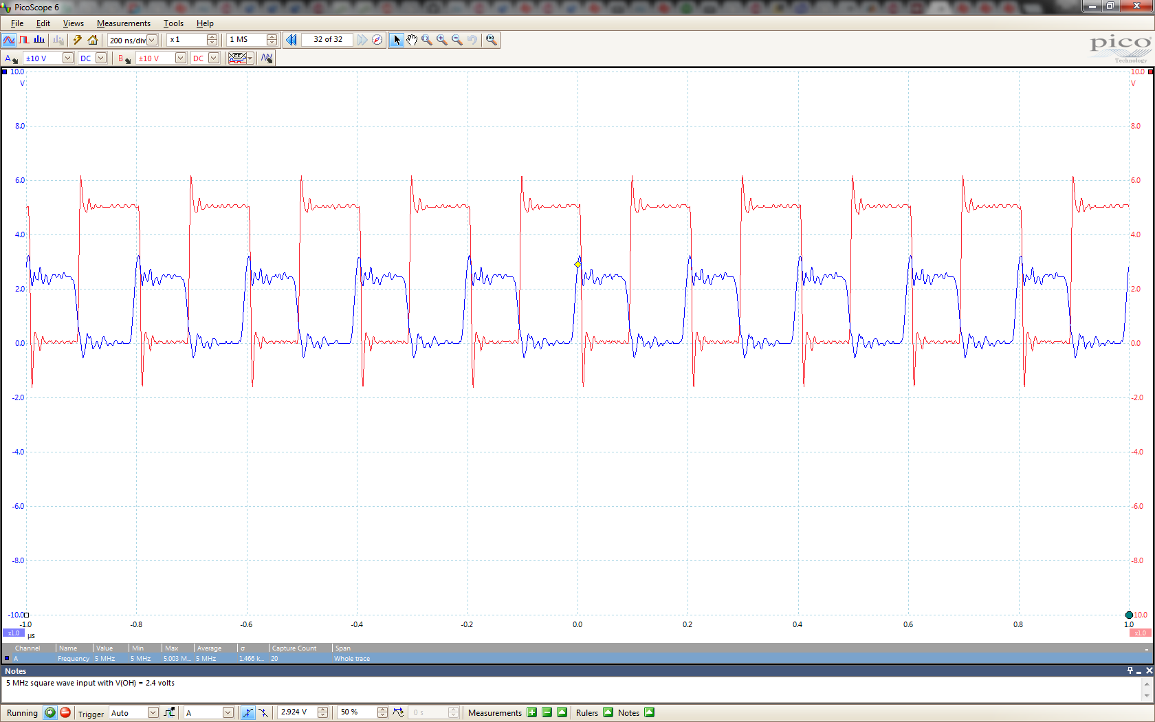

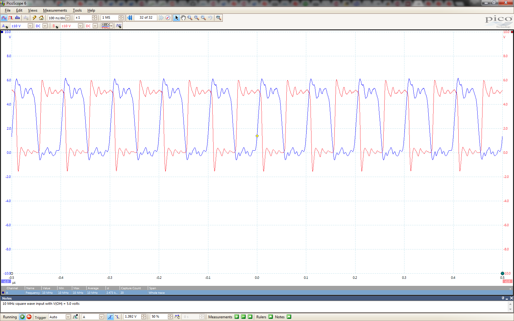

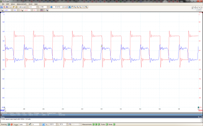

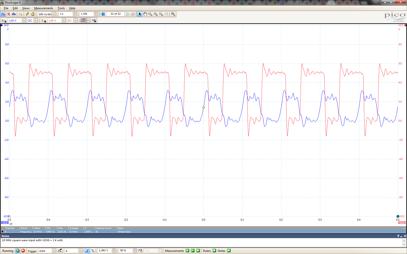

I wired up a 74HC00 as an inverter and hooked the input up to a HP3325A function generator. I put channel A of my oscilloscope on the input, and channel B on the gate's output. Starting out with a 1 MHz square wave, I decreased the output amplitude until I got to the point where going any lower would result in dropouts on the output waveform. This occurred at approximately 2.4 volts (48% of VDD which was exactly 5 volts). I then increased the frequency of the signal generator to 5 MHz, and then to 10 MHz watching the output waveform for any issues. The main thing I noticed is that the gate took longer to switch on the rising clock than on the falling clock, which is consistent with Garth's earlier prediction. I've attached scope shots for the curious.
As far as I can tell, the HC04 I was using switched fine at 10 MHz (the 3325A won't generate square waves above 10 MHz so I didn't try to go higher for this quick experiment). This goes some way towards explaining why most people don't have trouble interfacing TTL to 5V CMOS logic at lower frequencies.
Taking this experiment further will involve a bit of additional circuitry. I could feed a higher frequency sine wave (3325A goes up to 20 MHz with sine wave output) into one of the HC00s other gates to square it up, then run that output through a 200-ohm pot and adjust it to 2.4 volts to drive the gate under test and probably get acceptable results.
File comment: 1 MHz with V(OH) = 2.4 V
File comment: 5 MHz with V(OH) = 2.4 V
File comment: 10 MHz with V(OH) = 2.4 V
File comment: 10 MHz with V(OH) = 5.0 V

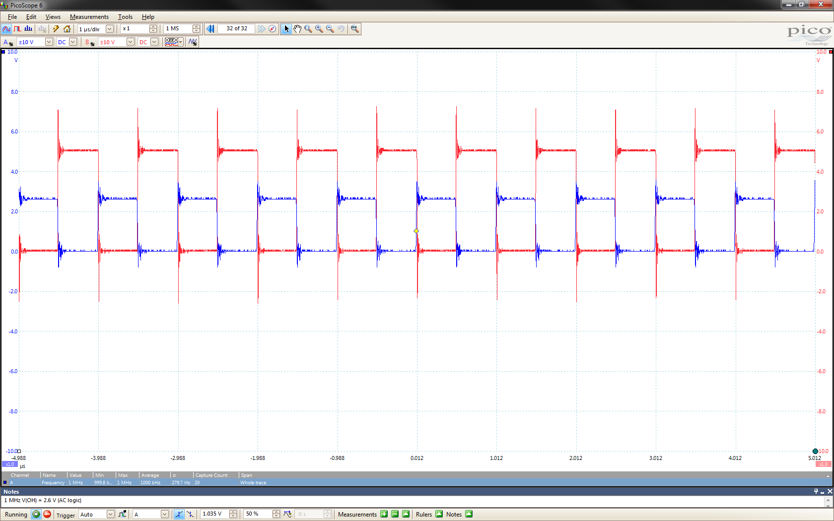

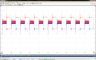

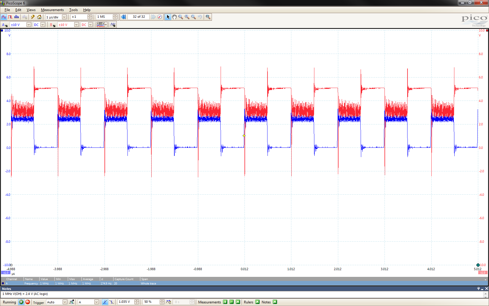

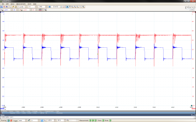

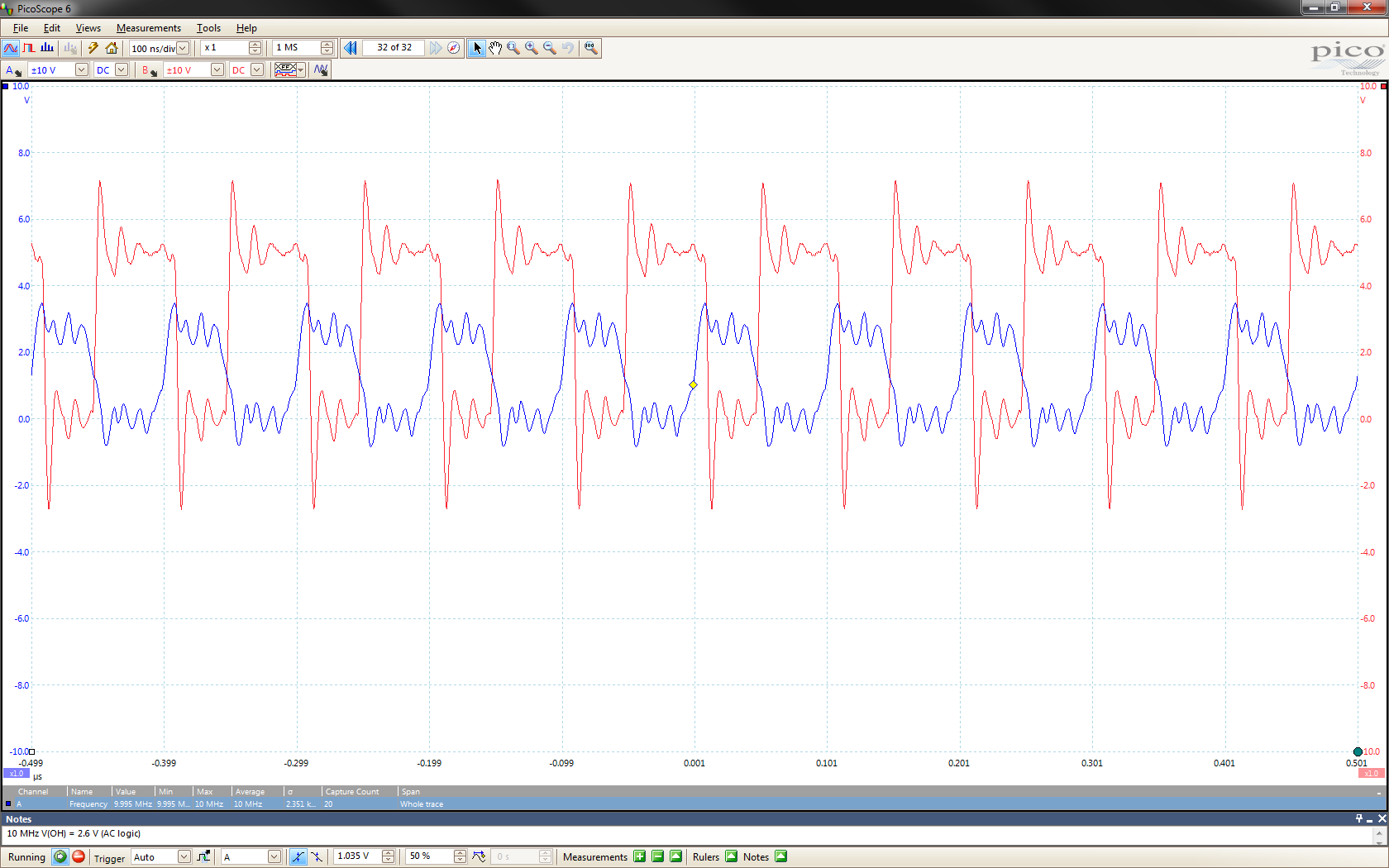

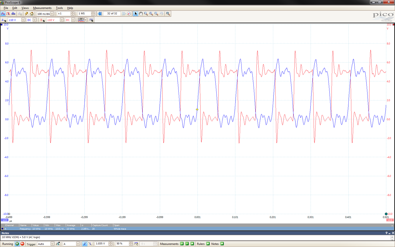

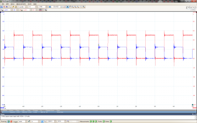

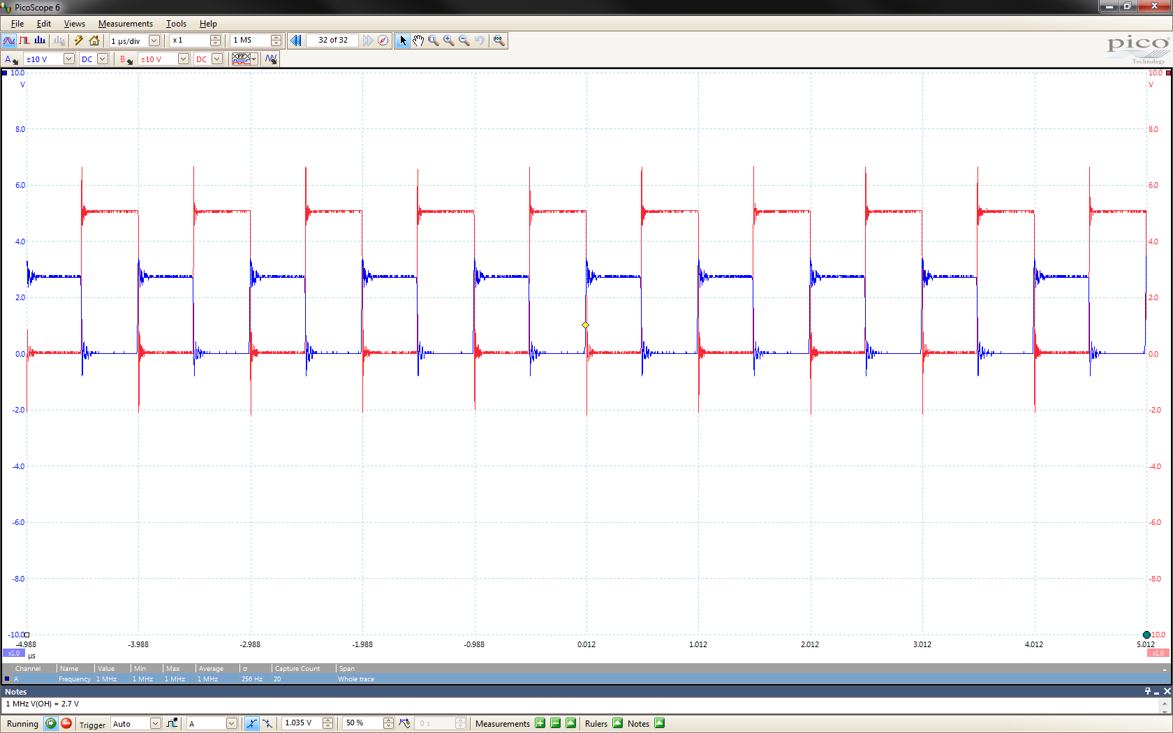

I went ahead and repeated my previous experiment with a 74AHC00 gate and a 74AC00 gate.
I discovered that V(ih) for the 74AHC00 gate was higher than it was for the 74HC00 -- it needed about 2.7 volts. The 74AC00 was slightly better at 2.6 volts. The waveforms for both signals look quite similar. One small but possibly significant difference is that you can see what appears to be some gate charge effects showing up on the input waveform of the AC logic but not the AHC logic. Both the rising edge and falling edge of the input on the AC waveform show this effect, but it is not visible on the AHC logic. This is consistent with the AC using larger FETs in order to switch higher currents.
Here are the scope shots for the AHC logic:
File comment: AHC Logic -- 1 MHz with V(OH)=2.4 V
File comment: AHC Logic -- 1 MHz with V(OH)=2.7 V

(couldn't fit all of the images in the previous posting, so here are the AC scope shots referenced from the above post):
File comment: AC Logic -- 1 MHz with V(OH)=2.4V
File comment: AC Logic -- 1 MHz with V(OH)=2.6V
File comment: AC Logic -- 10 MHz with V(OH)=2.6V
File comment: AC Logic -- 10 MHz with V(OH)=5.0V
