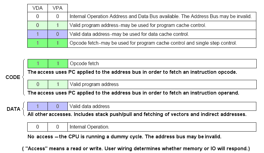

It's been a while since I actually looked at what the WDC doc says for VDA and VPA, and now I see they've omitted some helpful details and included some unhelpful ones. Therefore I present the following table from Section 2.26 on page 17 of the datasheet... and, immediately below it, a regurgitated and hopefully clarified rehash! :) This is based on examination of Table 5-7 on page 38. Although I didn't exhaustively check all 7 pages, :shock: I'm confident this is reliable. Comments and corrections welcome.

As Peter already noted, a dummy cycle results in a so-called "invalid" address, not a random or undefined address. The following is a (partial?) list of the categories of invalid addresses:
  1. an unused PC@ access (re-fetch of the last instruction byte)
  2. an unused SP@ access
  3. fetch of a byte just written by MVP or MVN
  4. the modify cycle of a read-modify-write operation
  5. an indexed address which is or may be $100 too low due to a page crossing which isn't yet accounted for
See here for two sorted lists noting all the dummy cycles in Table 5-7.
cbscpe wrote:
once I used VDA connected to the active high enable input of a 74HCT138 decoder
Assuming the decoder has such an input and it's unused, this is a terrific, zero-cost option when used in the right context. VDA doesn't go high during the fetch of instruction operands, which means instruction operands can't be fetched by any device which gets its chip select from a decoder connected this way. Therefore the scheme is inappropriate if the decoder provides chip selects for memory chips from which code is expected to execute. But it will work fine as long as the decoder only provides chip selects for IO devices, and I expect that's what Peter intended.
Use of VDA and VPA is as simple as connecting them to an OR (or NOR) gate, which is all that is needed to qualify bus cycles.
Not sure of the intended context here, but the OR gate adds prop delay and may have other, more minor costs as well. It should be omitted in cases where its output merely enables an IO-only decoder like that mentioned above. It should also be omitted when alternative protection can easily be had, for example as explained later re 6522. In the absence of a better alternative, the OR gate can justify itself as a decoder enable in the not uncommon cases where a single decoder provides chip selects for both memory and IO. The OR ensures devices getting their chip select from the decoder will be able to fetch instruction operands.
Happily, both schemes (ie; with or without the OR gate) translate VDA=VPA=0 into no response -- and built-in lack of response to dummy cycles is one way to protect designs which include IO devices sensitive to extraneous reads (example: 6522). It's not the only way, and furthermore not all designs include such devices.
Speaking of 6522, it's worth remembering that chip has two chip-select inputs, one being active-high. If the latter is unused then it can be attached directly to VDA in the same way as Peter's decoder. Of course that's only a partial solution if the system includes other IO devices also sensitive to destructive reads.
I make these comments with the assumption it's of no consequence whether or not IO devices are able to respond to code fetches. There are designs which routinely fetch opcodes and/or operands from an IO device, but in the 65xx family it's almost unheard of.
