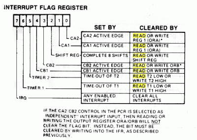

With 65xx processors, about 20% of the clock cycles require no memory access. Certain instructions cause the CPU to pause while it completes an internal operation of some kind. These cycles are predictable and documented -- for example in Table 5-7 of the W65C816S datasheet. Every CPU clock cycle is also a bus cycle, and, for the 20% in question, the bus cycle is a dummy -- there is no useful reason to access memory. You'd think memory ought to be turned off during a dummy bus cycle, but the complement of control pins on the 6502 & 65c02 is so simple that memory can only be commanded to Read or Write -- it's actually impossible to tell memory to do nothing! Therefore what must happen during the dummy cycle is either a write that has no effect or a read that has no effect. Usually it's a read, and the CPU just ignores the data that was fetched. This is a reasonable substitute for doing nothing because reading from memory doesn't change what's stored there -- reading memory has no effect. (I suspect reads may affect some EEPROMs, but only in the context of the quirky procedures used for programming. The no-effect write is rare, AFAIK only occurring on the modify cycle of a Read-Modify-Write instruction for 6502 and '816 in Emulation mode. It's no-effect because the data written is the same as that just fetched.)
-- The plot thickens! -- :D
I/O devices get their commands in the same way memory does; the only distinction is address. Depending on the address presented by the CPU during a dummy bus cycle, it's possible an I/O device will be touched. Our default assumption is that writes produce an effect and reads do not, but in fact some I/O devices are affected by reads (dummy or otherwise). By design, they attach extra activity to a read. For example, reading the Interrupt Flag Register of a 6522 not only returns the device's interrupt flag status to the CPU; it also clears those flags. Because flag status is erased this is called a "destructive read" -- the 6522 IFR is said to be "read sensitive." It's convenient to have the interrupt flags automatically cleared after a read, but only if you coded the read explicitly -- not when it gets slipped in behind your back!
Other I/O devices -- generally not from the 65xx or 68xx families -- may be read-sensitive in a different way. They require an idle period between accesses. For example, a read followed too closely by another read (or write) might cause the device to become confused. Presumably you've studied the datasheet, and if such a specification exists then your code will be written to provide the necessary delay between accesses. Your plans will be spoiled if a rogue read occurs in the midst of some legitimate accesses.

Unfortunately our understanding of dummy-cycle behavior relies very heavily on manufacturers' documentation, which may include errors, omit details or lack clarity. For that reason and others, it's possible you'll fall victim to a read-sensitivity problem someday, so it pays to remember the symptoms should they arise. For example the interrupt-flag thing will seemingly cause interrupts (or at least the flag status) to disappear, and that will be an utterly baffling problem to troubleshoot if you've forgotten about the read sensitivity of the 6522's IFR. (ORA, ORB, SR, T1L and T2L are also read-sensitive in some respects but, as with IFR, you'll suffer no consequences unless you're actually using the associated function. And the 6522 is still a very useful chip even without these functions.)
