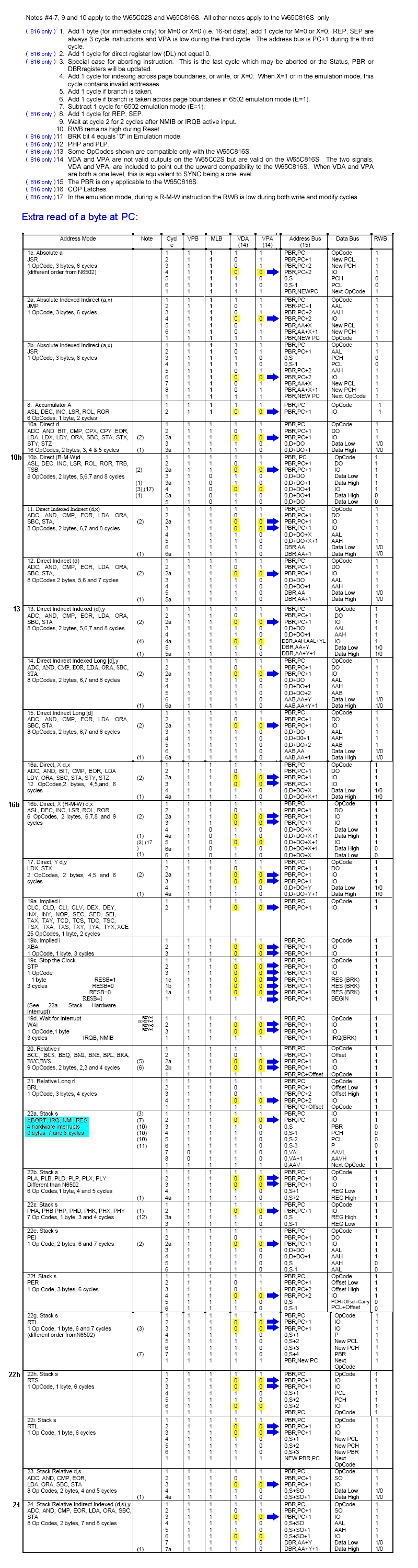

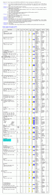

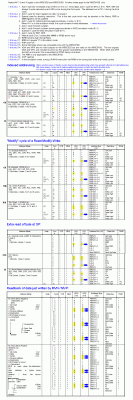

That's good info, Michael -- clear and easy to read. Where did it come from? Unfortunately it's not arranged in a way that lets you quickly notice all the dummy bus cycles. Table 5-7 of WDC's '816 datasheet is NOT easy to read, but at least it makes dummy bus cycles obvious; you can just scan down the columns for VPA & VDA and look for cases where they're both zero. But Table 5-7 is seven pages long!
Here, then, is my edited version of Table 5-7 -- sorted and highlighted to show every case where dummy bus cycles occur. Despite being part of an '816 datasheet, Table 5-7 apparently applies to WDC's current 'C02 as well (the W65C02S).
As you can see below, I rearranged and condensed the seven-page table into two tall, skinny gif files. Although I was reasonably careful, it's possible I accidentally introduced some errors, so check the WDC original if you prefer to see their errors only! :wink:
Edit: I will be adding detail and revising these gif diagrams, so I suggest you do NOT download them. Here is rev1 of the first table. Matters related to indexed addressing I moved up near the top, for easier reference to the notes. IMO indexed addressing is by far the most confusing cause of dummy bus cycles!
cheers,
