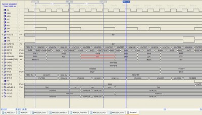

It's been a long time in coming, but I've finally begun testing the Forth VM support I've included in the M65C02A core. The following diagram shows the execution of two M65C02A FORTH instructions which can be used to implement a DTC FORTH EXE or EXIT functions. This functionality is implemented using a 16-bit pull instruction, PLI, and a 3-cycle NeXT instruction. :D
File comment: Forth VM PLI NXT instructions
The test code is a simple DTC FORTH-like Word code sequence where the code field address is populated by the 65C02 BRA rel instruction, so it's only two bytes. The CFA is at address $F22C, and IP is pointing to address $F228.
F222: F428F2                phw #$F228                  ; test DTC EXE
F225: 6B                    pli
F226: 7B                    nxt
F227: DB                    stp
F228: 2CF2                  dw  *+4
F22A: 0000                  brk #0
F22C: 8000                  bra *+2
F22E: A9FF                  lda #$FF
F230: 8D0002                sta $200
F233: EA                    nop
Michael A.

3-cycle Next, eh? :D And pli is handy for popping a value into IP. I see the code snippet tests pil and nxt.
I'm not clear why you began the executable code with the BRA. The following lda and sta seem meaningful as a placeholder to represent hypothetical user code. But why the BRA? Does it assist with testing?
cheers,
Jef
As I've said before, I'm a complete noobie when it comes to Forth. In my attempt to incorporate some special support for FORTH, I decided to use the prefix instructions to support both an ITC and a DTC VM. As such, I followed a model where the parameter field of a primitive or secondary requires two bytes. Therefore, in my test case, I am just retaining the code field as a reminder of where the ITC CFA pointer must be inserted.I simply used the bra *+2 as a two byte place holder for the code field; I kind of like how the machine code representation of that instruction, $80 $00, looks in the instruction stream. :) When I set up the test for the DTC ENTER instruction, the bra *+2 will be replaced with either the single byte (DTC) ent ($7B) instruction.
Both you and Mike are correct in your assessment that a primitive DTC FORTH word could be implemented with machine code in the code field. The two cycles saved by having no code field in a DTC FORTH word probably should be the preferred implementation.
I hope to complete the testing of the FORTH VM support instructions soon: nxt, pli, ini, phi, ent, and lda (ip,I++). The ITC version of the fundamental operations will require the ind prefix instruction: ENTER => ind ent; NEXT => ind nxt; EXE => pli ind nxt; EXIT => pli ind nxt;
The auxiliary stack usage may add another prefix instruction (osx) to the instruction sequences in either a DTC or an ITC implementation. With the osx prefix, the auxiliary stack, accessed using X, can be used for the FORTH VM's Return Stack (RS), and the system stack can be used as the parameter stack (PS).
Michael A.

Thanks, Mike. And I hope I didn't seem critical, Michael. The truth is I'm rather a noob myself when it comes to Forth other than ITC. This notion with DTC of starting the code with a jump or bra seems like it might serve a purpose -- a substitute form of indirection, perhaps --but I hesitate to speculate. If you got the idea from something you read, I'd be interested to hear if that source also offers an explanation.

Not at all, Jeff. I simply have on OCD-like streak :) that goes for a certain amount of symmetry: a two byte branch and a two byte ENTER sequence just appealed to me. I used the branch instruction to enter/start the simulated primitive because an ENTER into a secondary would require 1 byte if S => RS, or 2 bytes if X => RS. I'd like to imagine that when I got around to optimizing for performance, I would consider eliminating the code field to get back the two cycles of the bra *+2 sequence.
However, being a Forth noob, I might keep the code field because Brad Rodriguez, in his Moving Forth articles, emphasized the importance of having W point to the code field. When he recommended having W pointing to the code field, I don't think he made a distinction between ITC or DTC implementations, or between primitive and secondary words. Since I do not have a full understanding of Forth's fine points, I will try to stay on the path described by Brad and others for the time being.
