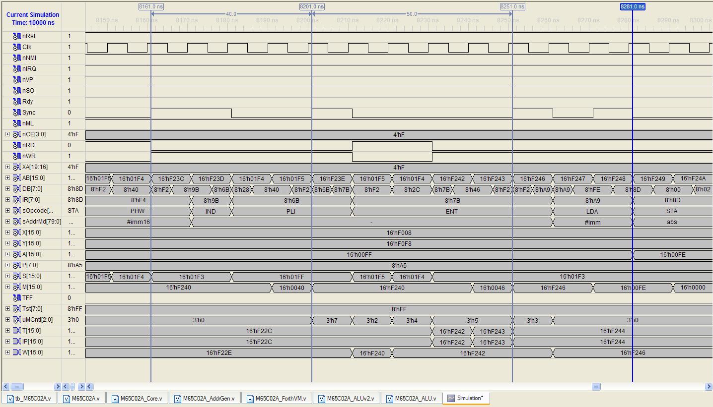

I have tested a number of other instructions: INI, INW (IND INI), PLW (IND PLI), and ENT (ENTER). In the attached figure, I've annotated the PLW instruction followed by the ENT instruction. External behavior are as I expect, and shows that the DTC ENT instruction requires only 5 cycles. :) Only need to verify the ITC mode of the NXT and ENT instructions and the LDA ip,I++ instruction before declaring the ForthVM module tested.

The attached figure shows the LDA ip,I++ Forth VM instruction used to load the accumulator with a 16-bit in-line literal such as used in the LIT and CLIT figFORTH words. The instruction autoincrements IP past the embedded literal/constant so that interpretation can continue seemlessly. Currently, the offset operand is ignored, but can be readily implemented with a simple microcode change rather than a logic change.
Following the LDA ip,I++ instruction is a 16-bit comparison instruction. I've implemented a change to the normal behavior of the CMP/CPX/CPY instructions such that 16-bit comparisons affect the V flag. This change enables the implementation of more powerful conditional branch instructions. PDP11-like signed and unsigned conditional branches will be performed when the normal conditional branch instructions are preceded by the SIZ prefix instruction. I've also set it up such that if the conditional branch instructions are preceded by the ISZ prefix instruction, then the conditional branch is relative to IP. I expect these two simple modifications to significantly improve the efficiency of comparisons for FORTH and standard languages.
