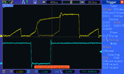

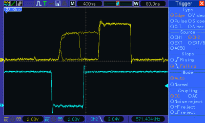

Okay,
I am late with my homework.
I wrote a small program that reads the TMS9929's status register in a tight loop. What we see on the screenshot is the TMS9929's /CSR-pin (blue curve) and the D2-line (yellow curve).
As we can see, the signal level when driven by that NMOS 9929 is just slighty above 4V, so apparently WDC safe.
Using a 3.3k pullup resistor will pull up the level a bit (go figure..) but seems to pull up some noise, too.
File comment: Same, but using a 3.3k pullup resistor.
File comment: D2 signal level when bus driven by TMS9929
PostPosted: Sat Jul 18, 2015 7:18 pm
OK, so in red I drew the Phase2 waveform in what I suppose to be the the correct relation, and I put the images in a two-frame animation, ie, with and without the pullup (below). It's no surprise to see that the pullup resistor has a distinct effect when Phase2 is low (for example in the first part of cycle 1, which I circled). This is entirely harmless. The 'C02 will always tri-state the data bus during Phase2 low, and ideally (but depending on its wiring) the host system will do the same. Hence there's nothing to prevent the pullup from pulling up.
The last half of cycle 2 seems strange, though. In the no-pullup frame we see the voltage drop sharply at the end (late in period 2b). Although it's slightly OT, I'm puzzled and bothered by this. It suggests something odd about the device, something odd about your wiring or the way the experiment was done, or something I'm missing or don't understand.
Just checking - you said the blue curve is the TMS9929's /CSR pin. Is that the device's chip-select input? Can you post or link to a datasheet for that chip? And did I get Phase2 in the correct relation to the other waveforms? Edit: alternative Phase2 interpretation added.
